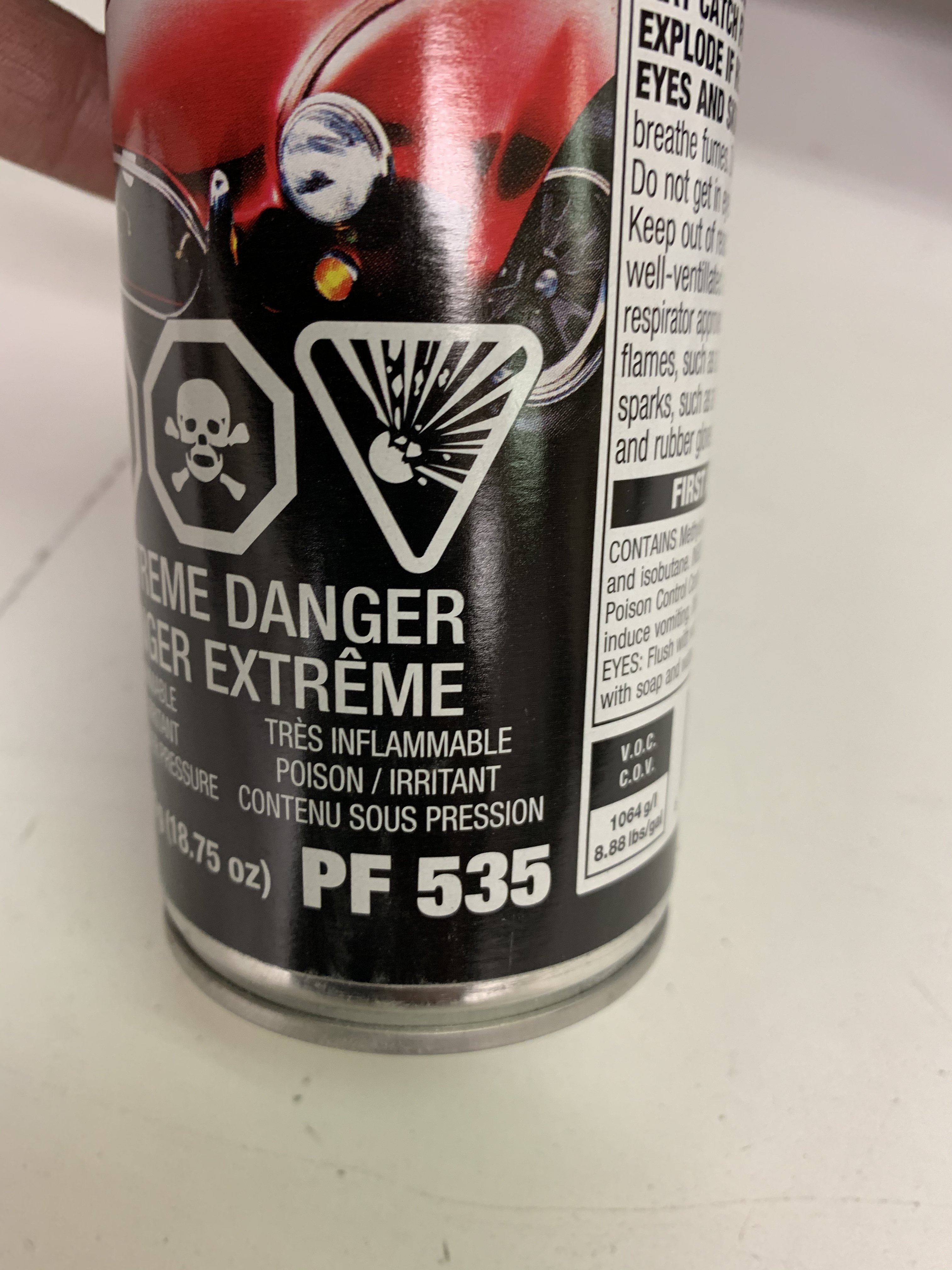

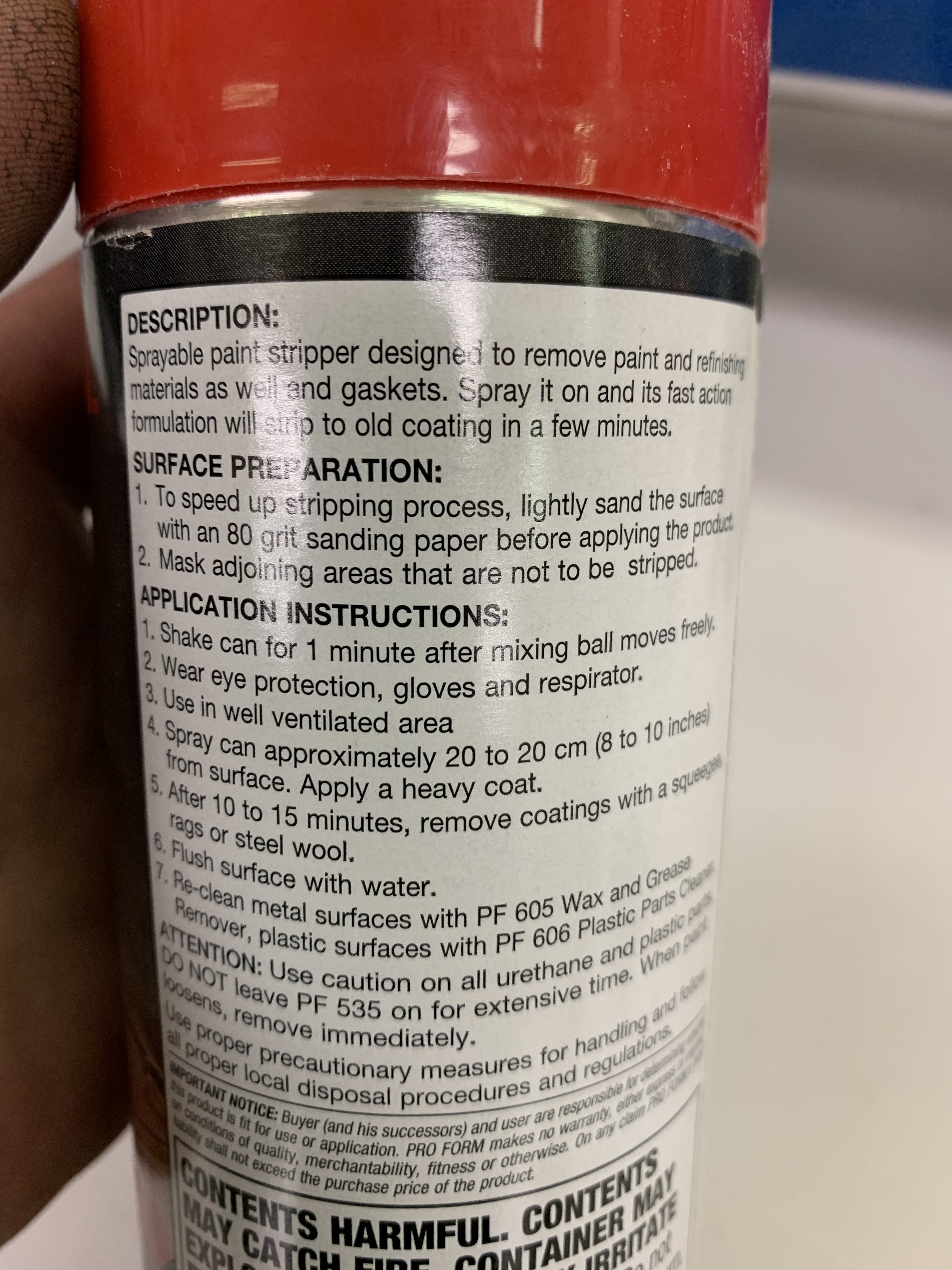

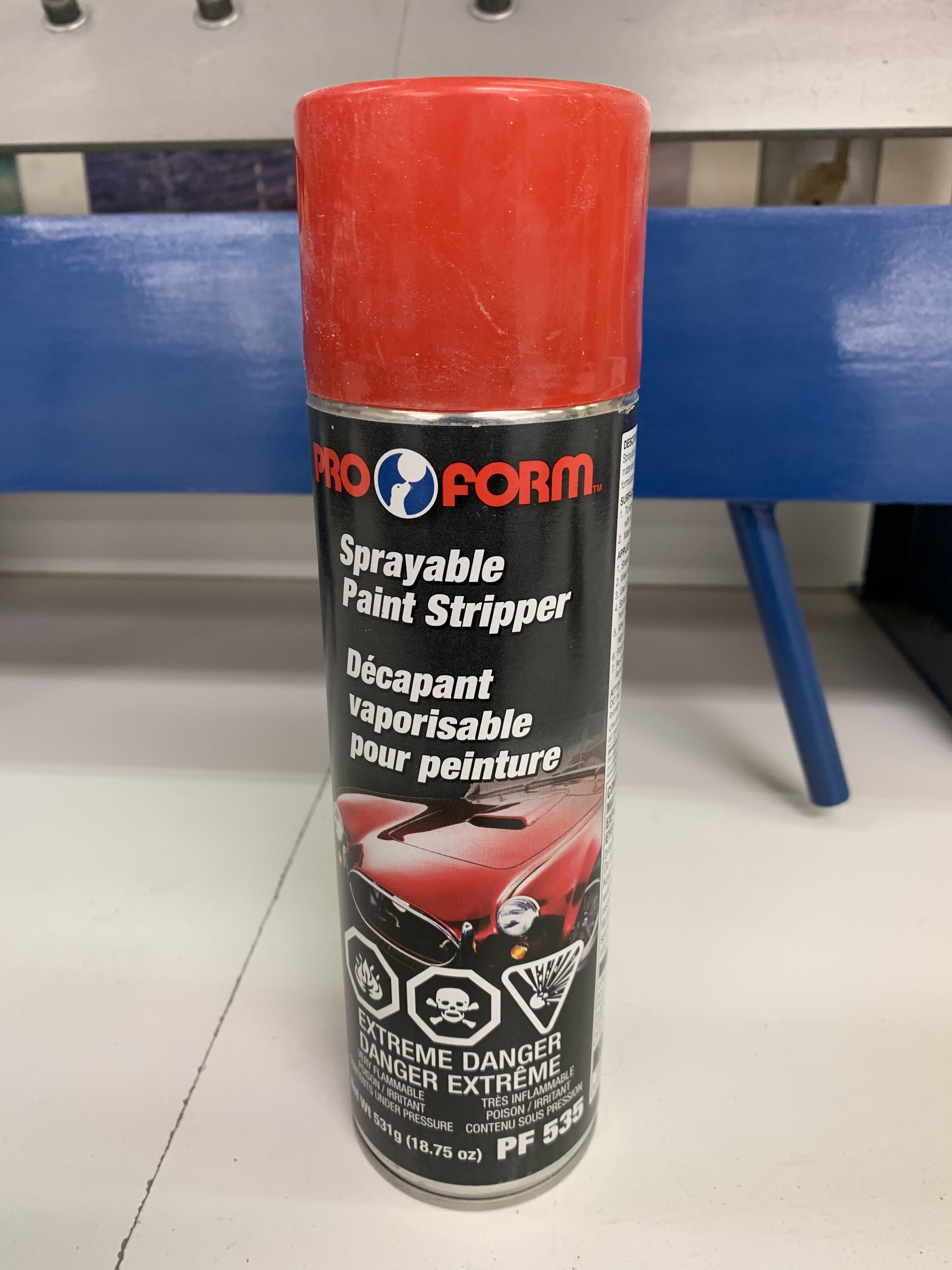

Here’s the exact product I used:
And a link to the SDS sheet for it for the active ingredient list. In case you can’t get the exact same thing in your location:
