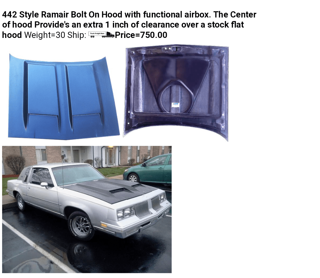

Update on Project Olds. Finally got the hydro boost set up. Got everything routed, oiled, primed etc. The cars is great, but I still have a ways to go like, install the exhaust. I've decided to go with 2 3/4 inch duals. I've done some research and found a thread in this forum to help my decision. I purchased a set of Flowmaster 40 series from a member in this forum. I will also be purchasing a 442 dual ram hood. These are my next steps forward, before I go forth with the interior and paint. I will only have to buy headliner and carpet. I bought the interior from, a parted Calais two years ago. The color is a match with my factory interior. I do however need a brake pedal that will work with the hydro boost. Although the brakes are great, the brake pedal is jacked up like in a jeep. Either I find a brake pedal that works, or modify the one I have.
