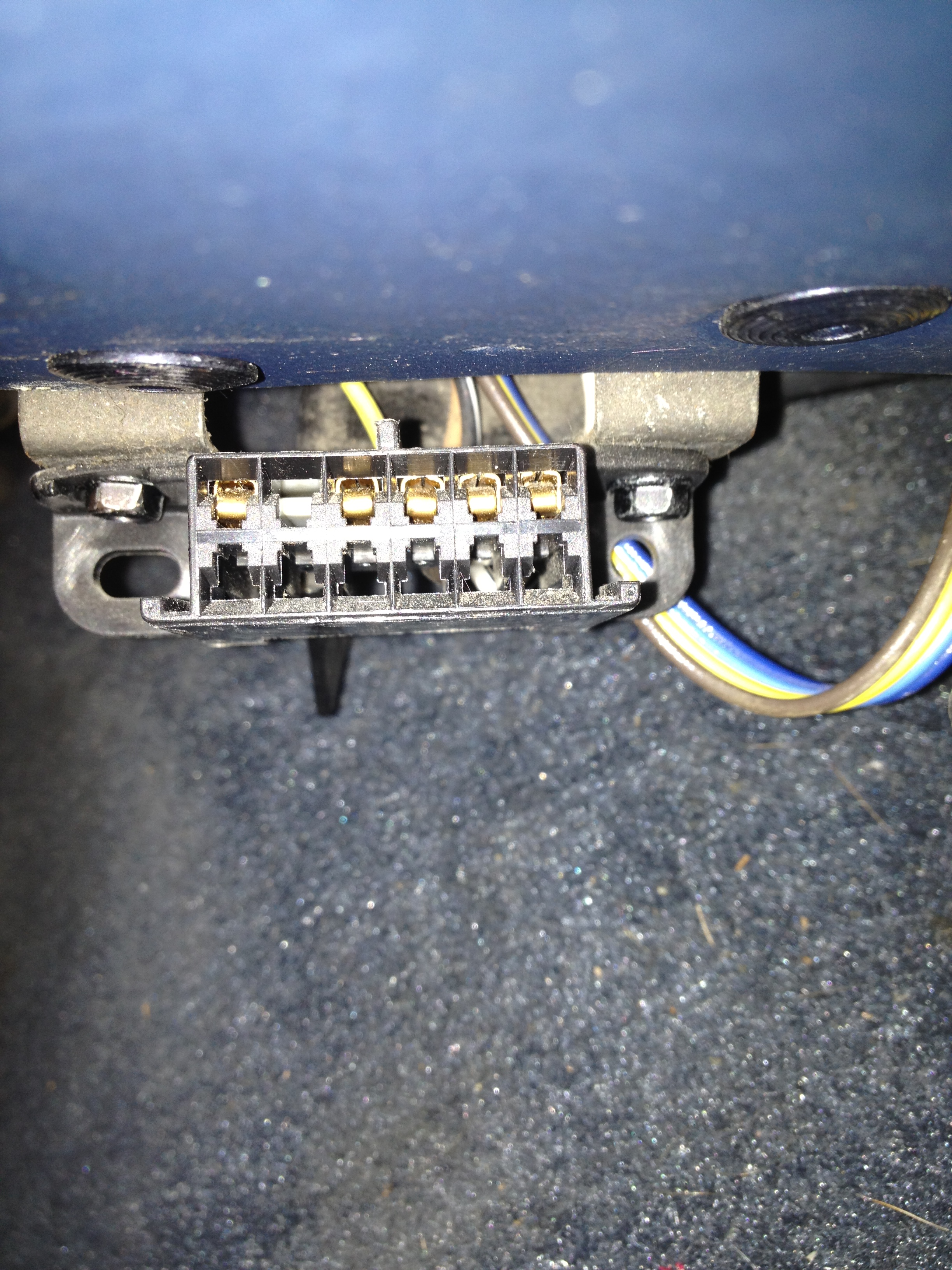

Is this what the connector looks like? I tried attaching a paper clip and a wire between a and b and no light came on when i turned the key or when the engine was running?

Obviously, won't work if they pulled the bulb/it's burnt out from being on all the time.
If you turn the key "on", engine not running, does the check engine light come on?

Well when I turn the key, the only thing that lights up is the fasten seat belt light. Maybe I shoulda checked if it was burnt out when I took the cluster off before 😛 I'll check that tommorow

Ok so today i went out and bought new bulbs. Replaced the one for the check engine, and still nothing happend? There is only 3 bulbs behind the dash too, is that normal? Thanks
