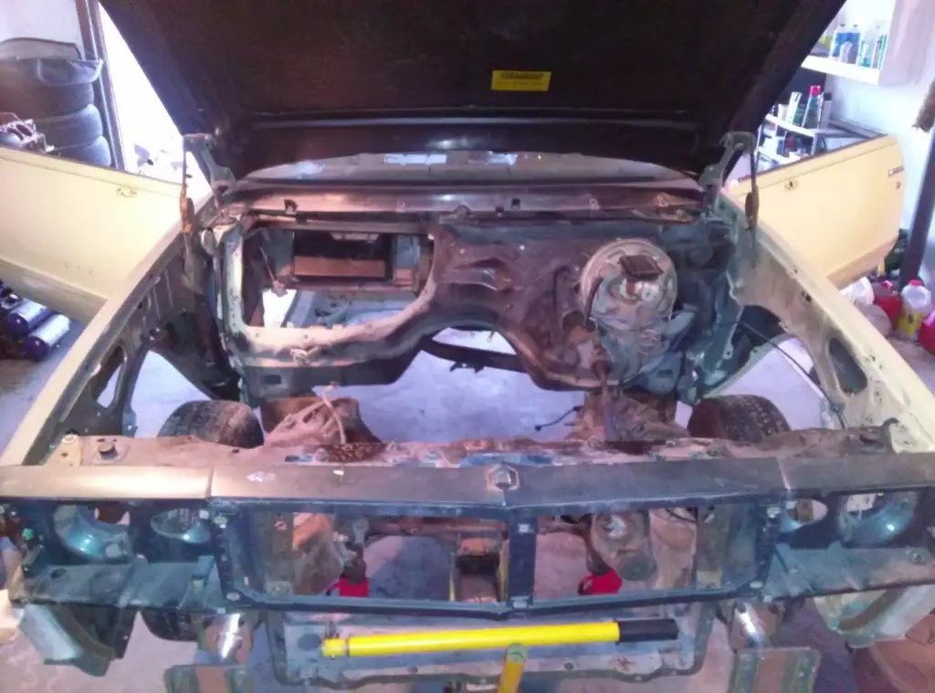

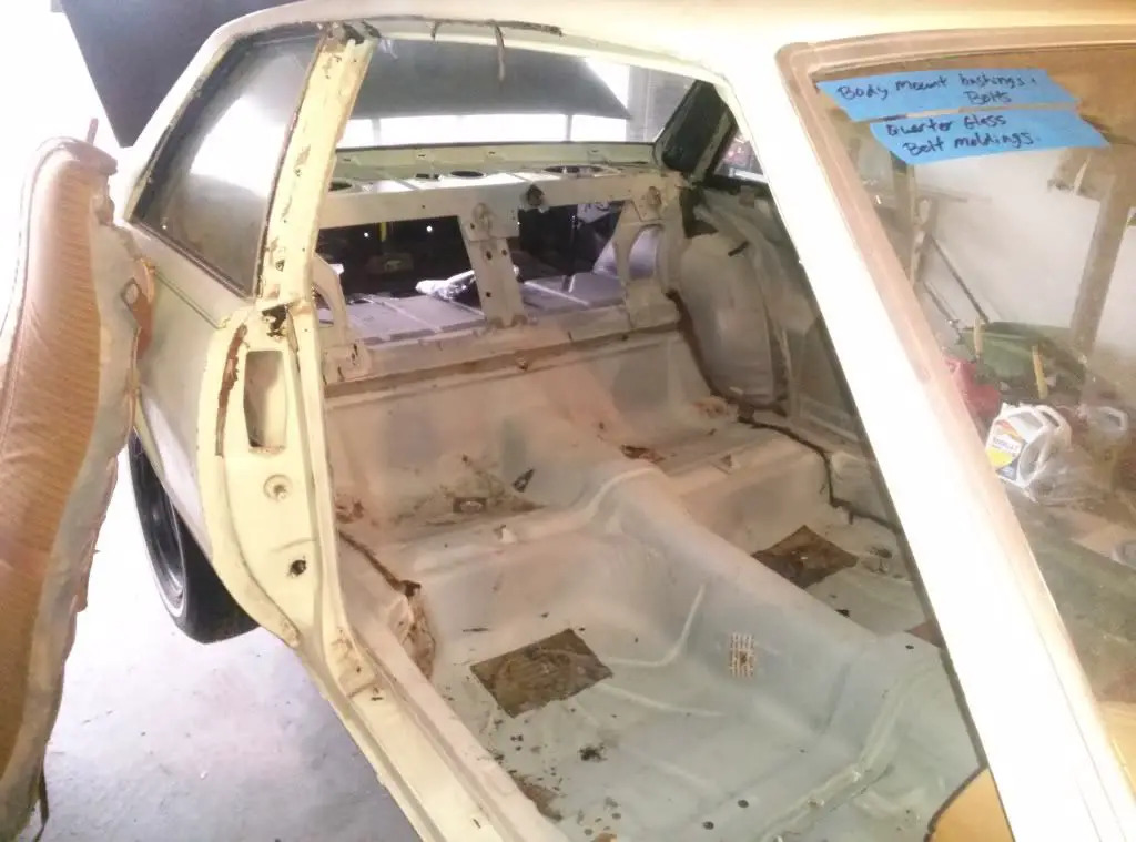

Some nice 60 degree weather today and I got some things knocked out on the car project. I have to remove the door glass, handles and locks, and then the dashboard and duct work. Then it's off to paint. I got my new body mount bushings today, I'm going to order some body mount bolts this week and also new window sweeps/belt moldings for the quarter glasses.

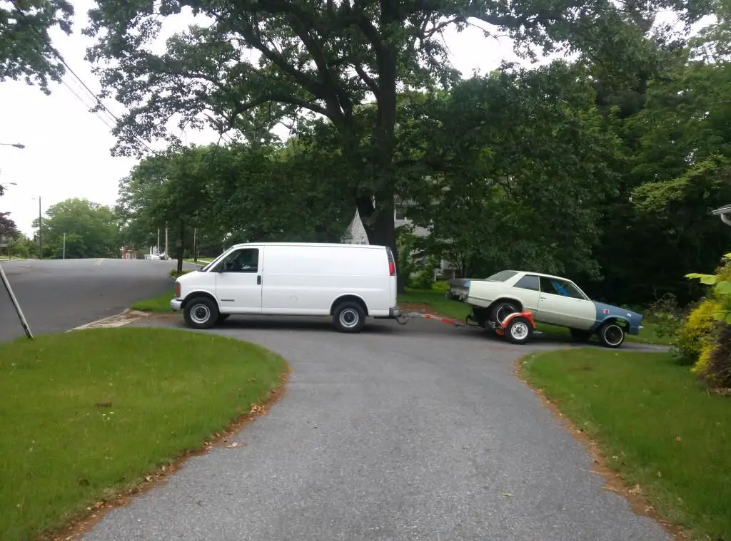

The car is stripped down as far as it can go, less the glass and glass trim, and ready for paint. I got it loaded up today and I have an appointment to go over the car with my restoration shop tomorrow morning. There are some Gbody parts refrigerator magnets on the front fender. :wink:

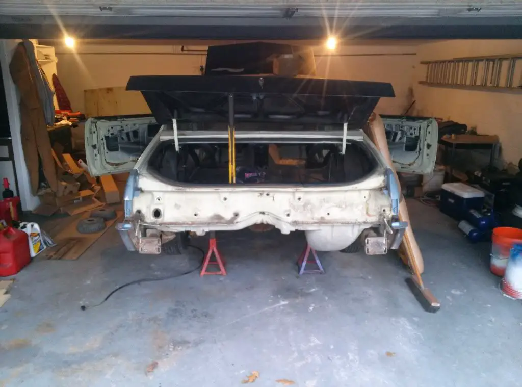

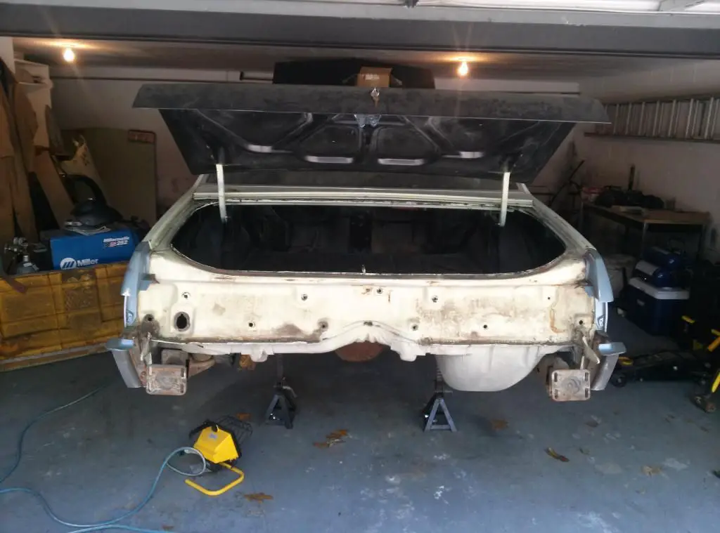

I used the struts I mentioned on the last page for the fiberglass trunk and for the fiberglass hood. They are perfect for the hood, but an inch too short extended for the trunk. The pressure is great for both. I did find some struts 1" longer extended with the same compressed length, for a focus hatchback, but they have too much pressure and also don't extend easily again after being compressed. :?: I think the struts might be designed like that for that car for some reason. So I'm still searching for some struts that are 11" extended, 7" or less compressed with about 85 lbs pressure, but the ones I have now (same as the hood struts) will work. My garage needs a taller ceiling, look at the hood. :shock:

The 81 column is in the car now so I can steer the car easier loading it on the trailer and moving it around. It's going with the car to the restoration shop.

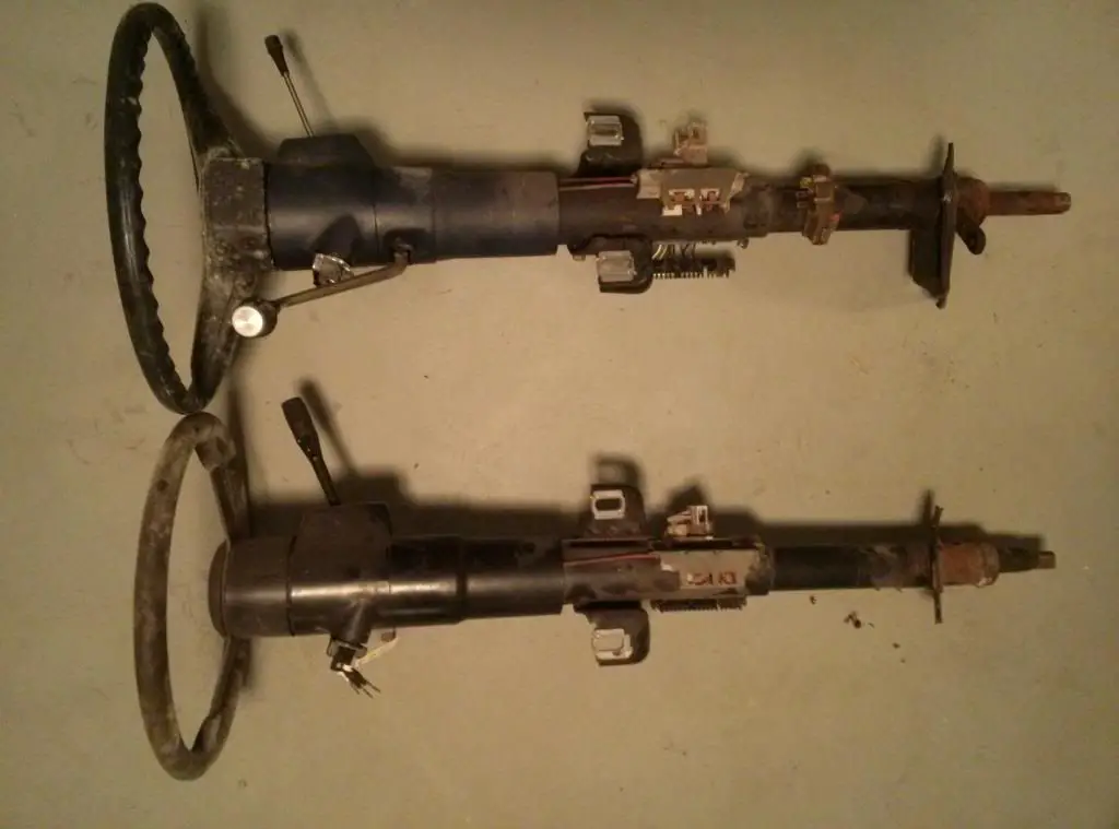

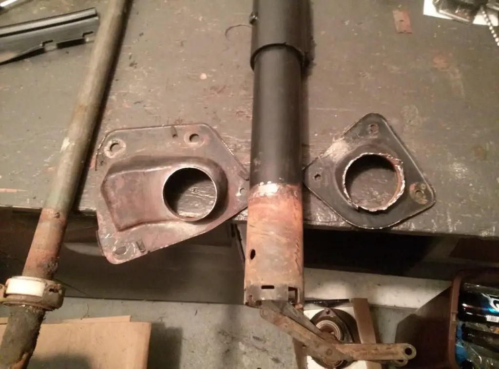

I completely disassembled the 79 G body and 85 F body steering columns. The columns are nearly identical side by side. The only differences I have found between the columns so far is that the F car has the wiper controls on the turn signal stalk, the high beam switch rods are different, and that the firewall flange is different.
With both columns completely stripped I carefully removed both firewall mount flanges. The G body flange is going on the F body car column and the turn signal stalk is going to be swapped too. I *might* have to modify the high beam rod for the turn signal stalk swap. The rods are different lengths on the F and G columns. The shaft inside the column, running from the steering wheel to the steering shaft D is the exact same length (I'd even say the same identical part). I first need to take a measurement from the firewall to the end of the double D on the Malibu with the 81 G body column in it. When I mock up my F body column in the Malibu I am going to slip the flange on the column and bolt the column up to the under dash support, then slide the flange down the column and re-measure between the firewall and the end of the double D. Then tack the flange in place on the F body column.

I was able to get as far as I could tonight with the 4 speed steering column hybrid build. All I have left to do to fit the column is to measure the length of the double D to firewall on the stock column and put the hybrid column in the car and tack weld the G body firewall flange in place once set. I will not have the car back for 6 months or so while it is at the body shop.
I used the complete 3rd gen F body column except these G body parts:
Turn signal stalk (non wiper)
Turn signal switch
Ignition switch
High beam switch
Firewall flange

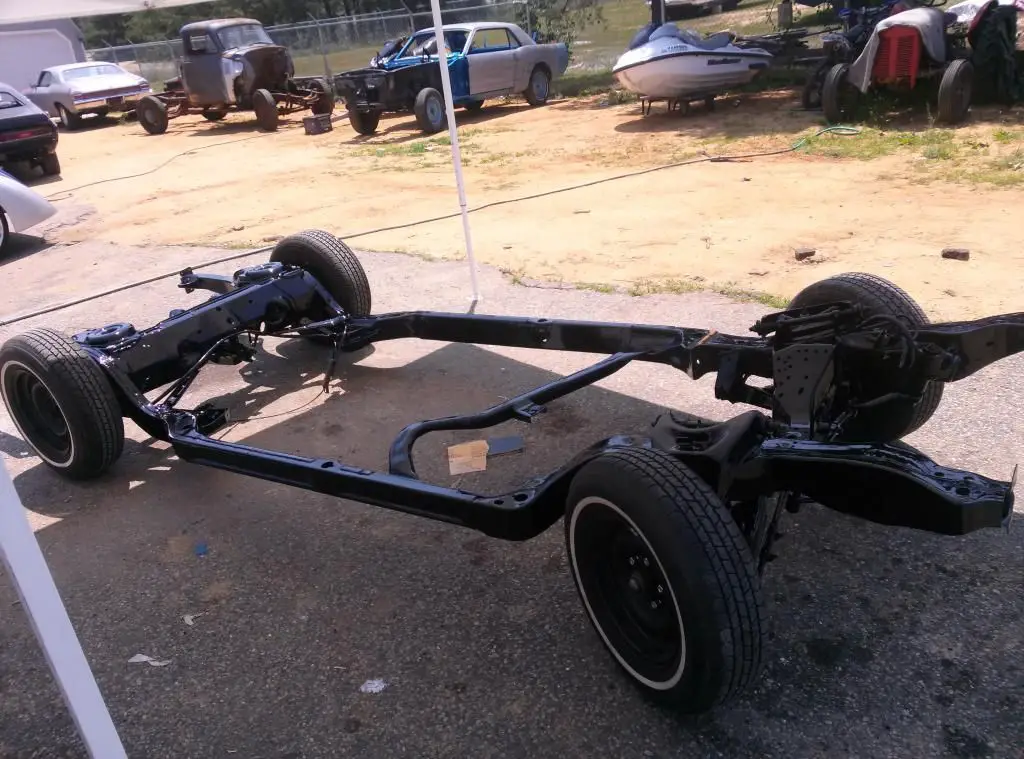

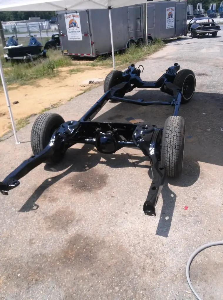

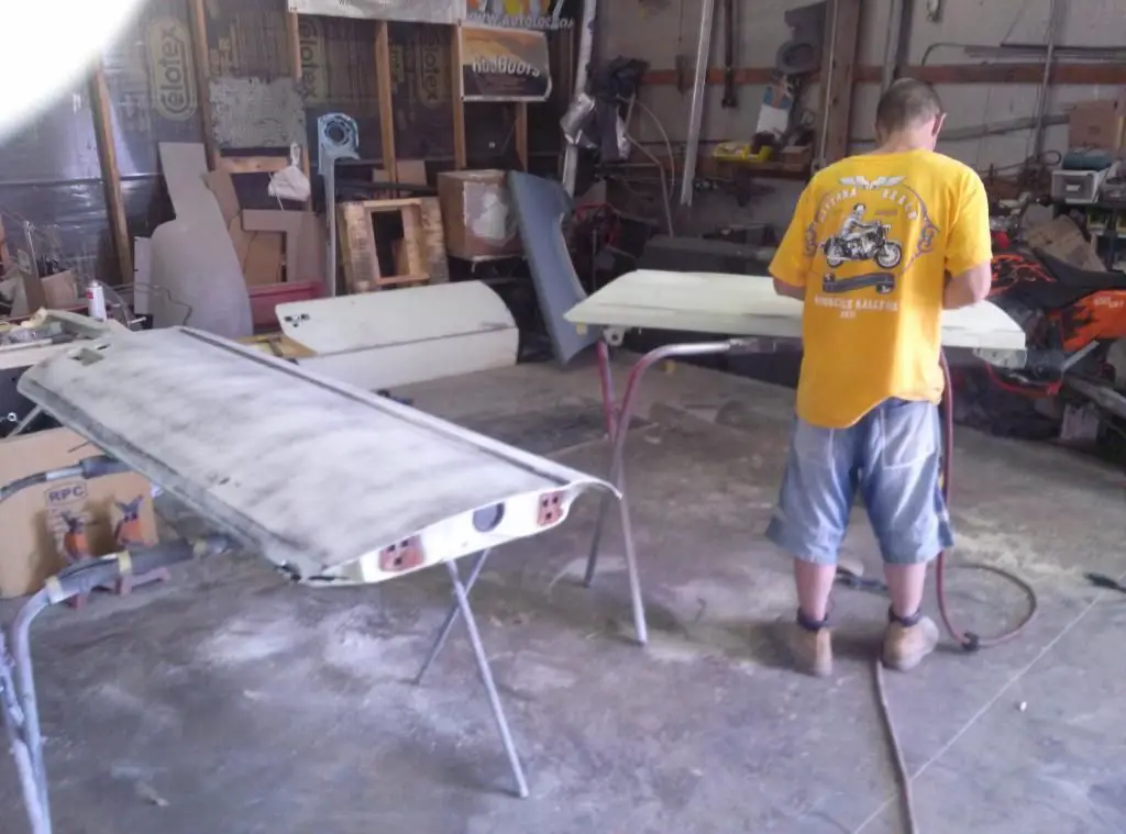

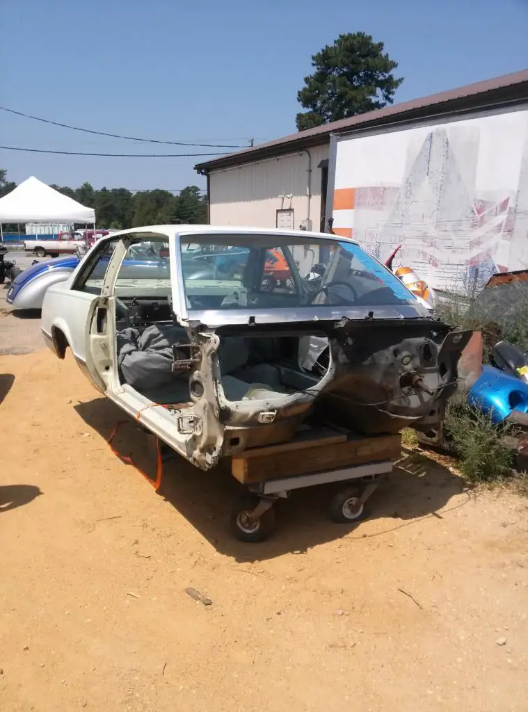

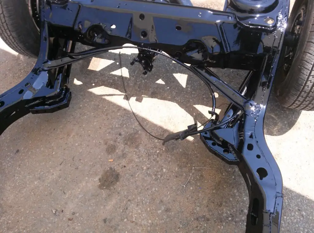

I stopped by today and the guys are making some good progress. They started on the car this week and have already removed the body from the frame, straightened the right rear frame rail, welded in the frame box in kit, and epoxy coated the frame black. They were working on the doors and fenders when I stopped by, prepping them for paint. The floor and firewall are going to be painted next on the rotisserie, then I think they are going to put the body back on the frame to paint it.

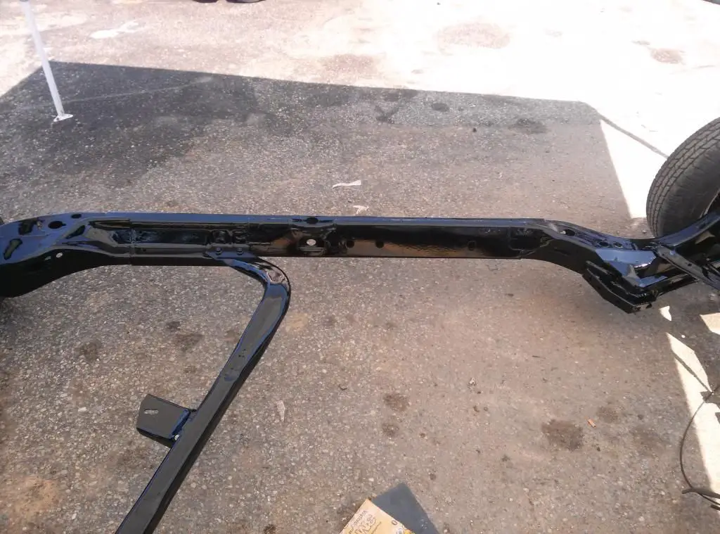

Frame boxed in.
The rear upper and lower control arm mounts are strengthened too.

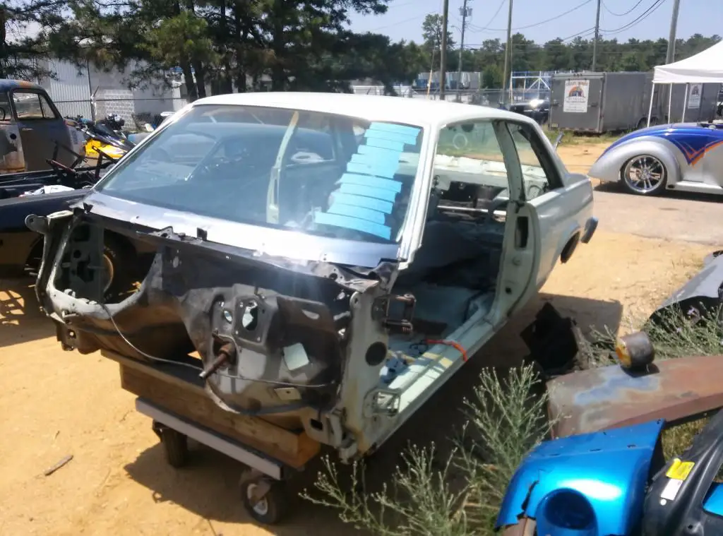

The body is on a dolly for now.
They were prepping the fenders and doors for paint.
