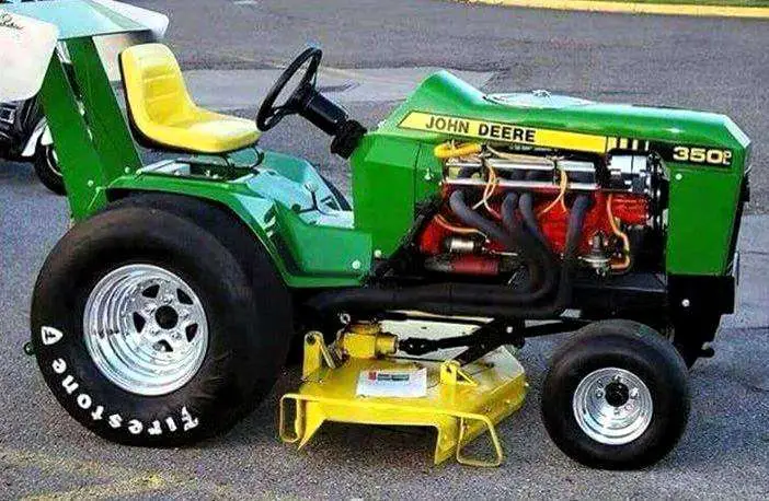

I got the bug also,

Great for doing driveways, especially when fitted with a blower but here, today, anyone courageous enough to try and run one outside would make a good example of a human popsicle in about 5 minutes flat! -40 with the wind chill and blowing snow. Makes a perfectly good excuse to leave the tractor in the shed, close the door, head for the garage, open the fridge and open a wobbly pop instead.
