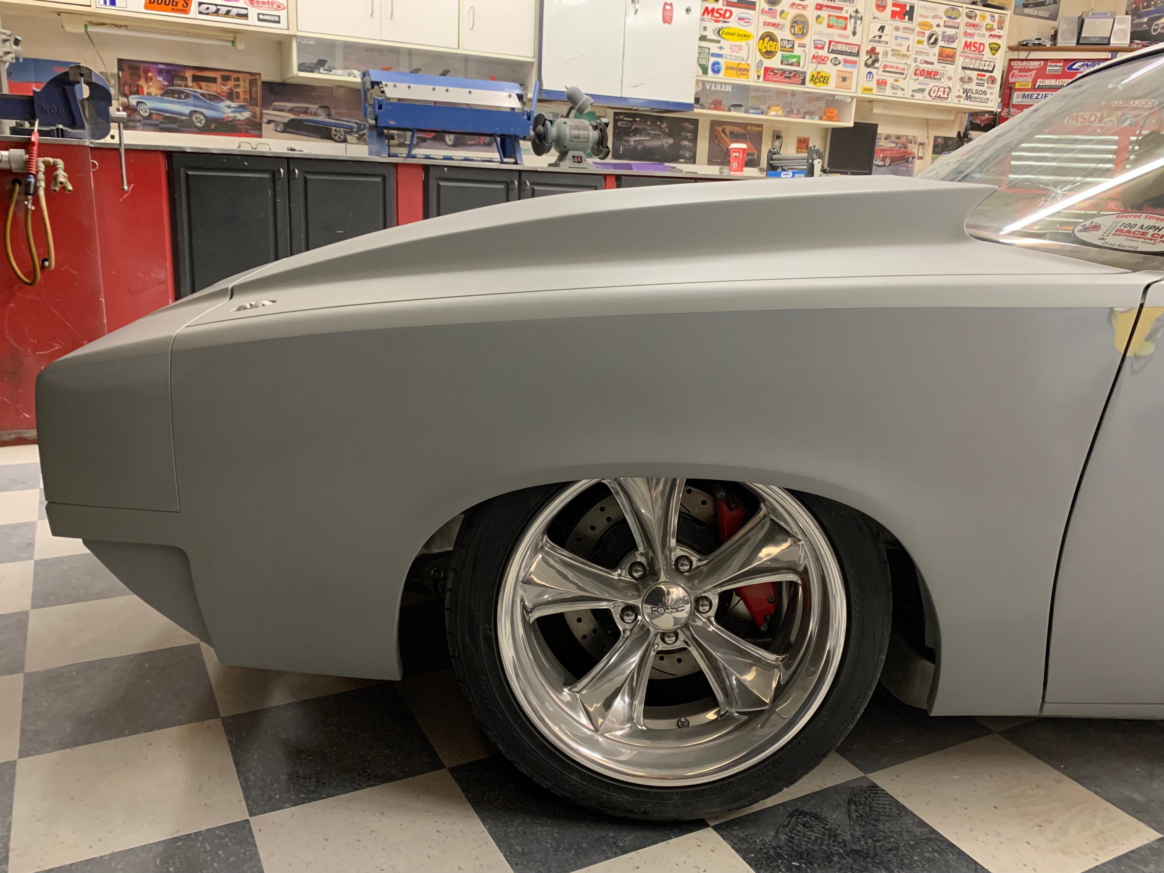

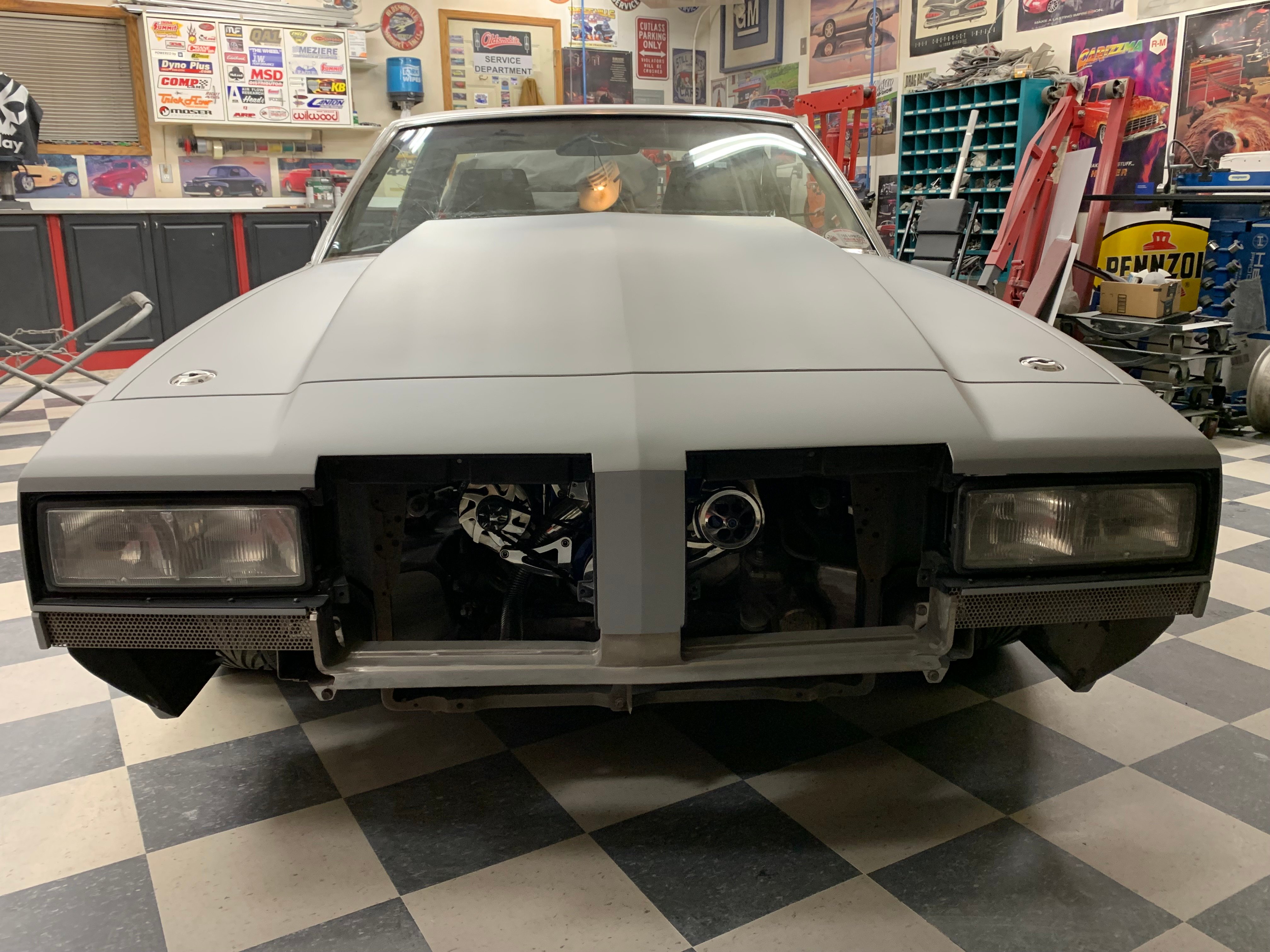

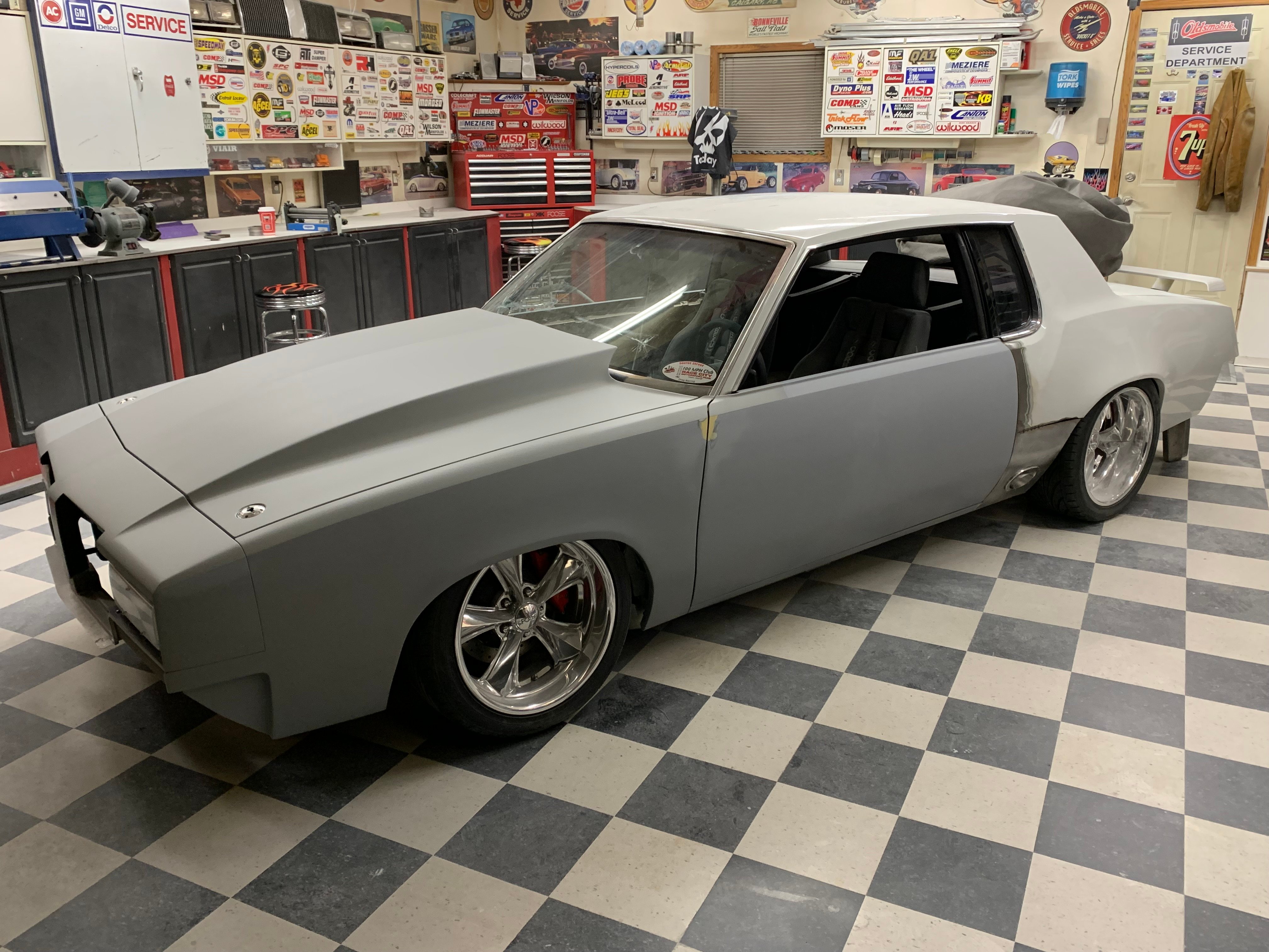

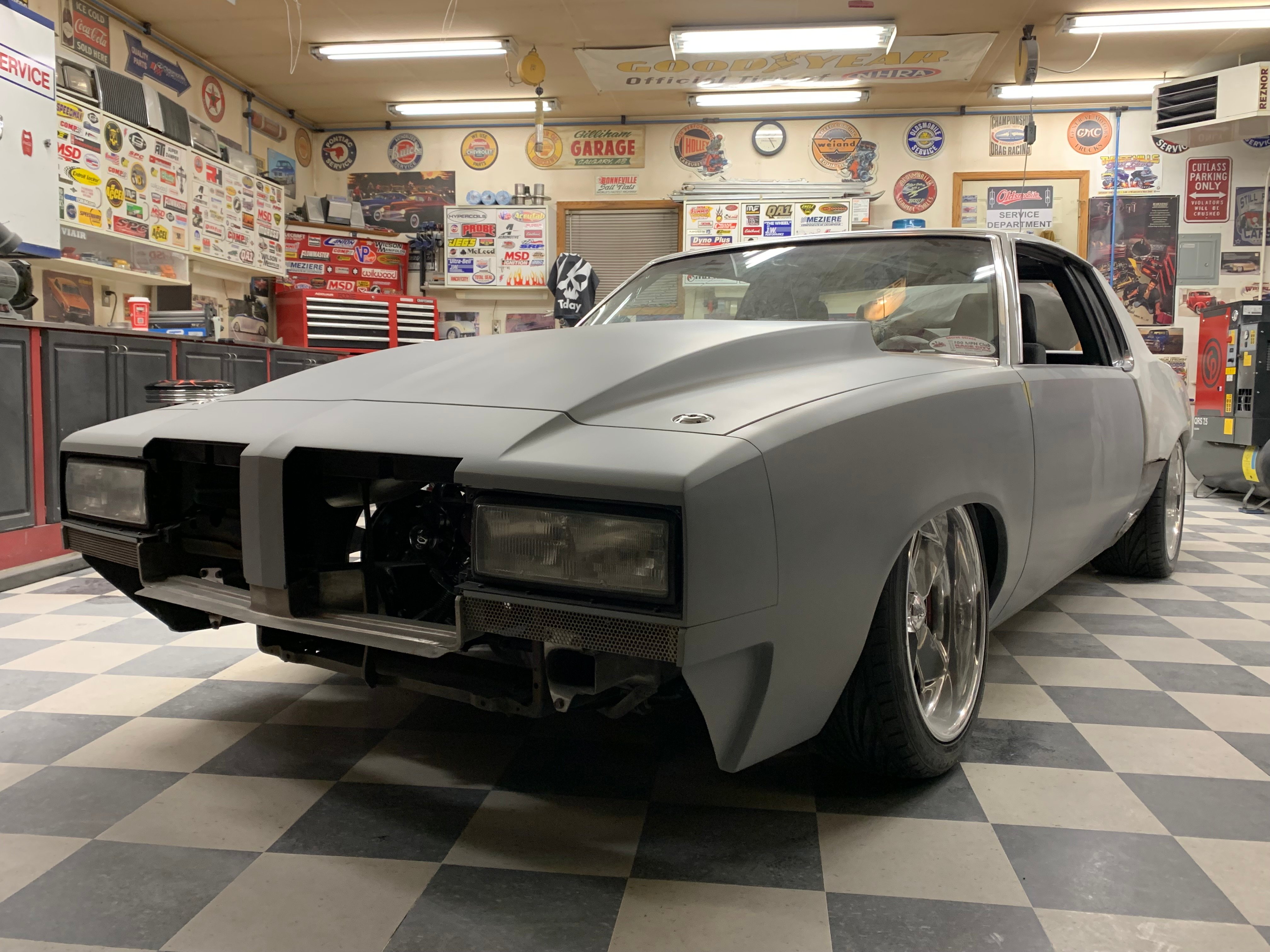

It’s nice to see it all in one color and back on the car, even if it’s still in the bodywork stage. The center peak line definitely needs some work as it’s currently taking a meandering path through the woods, but that’ll get fixed with blocking.
Expecting a visit from Cauterize and his wife later today, but after that I can resume sanding on it. Until then, here’s a couple pictures of it back together.
