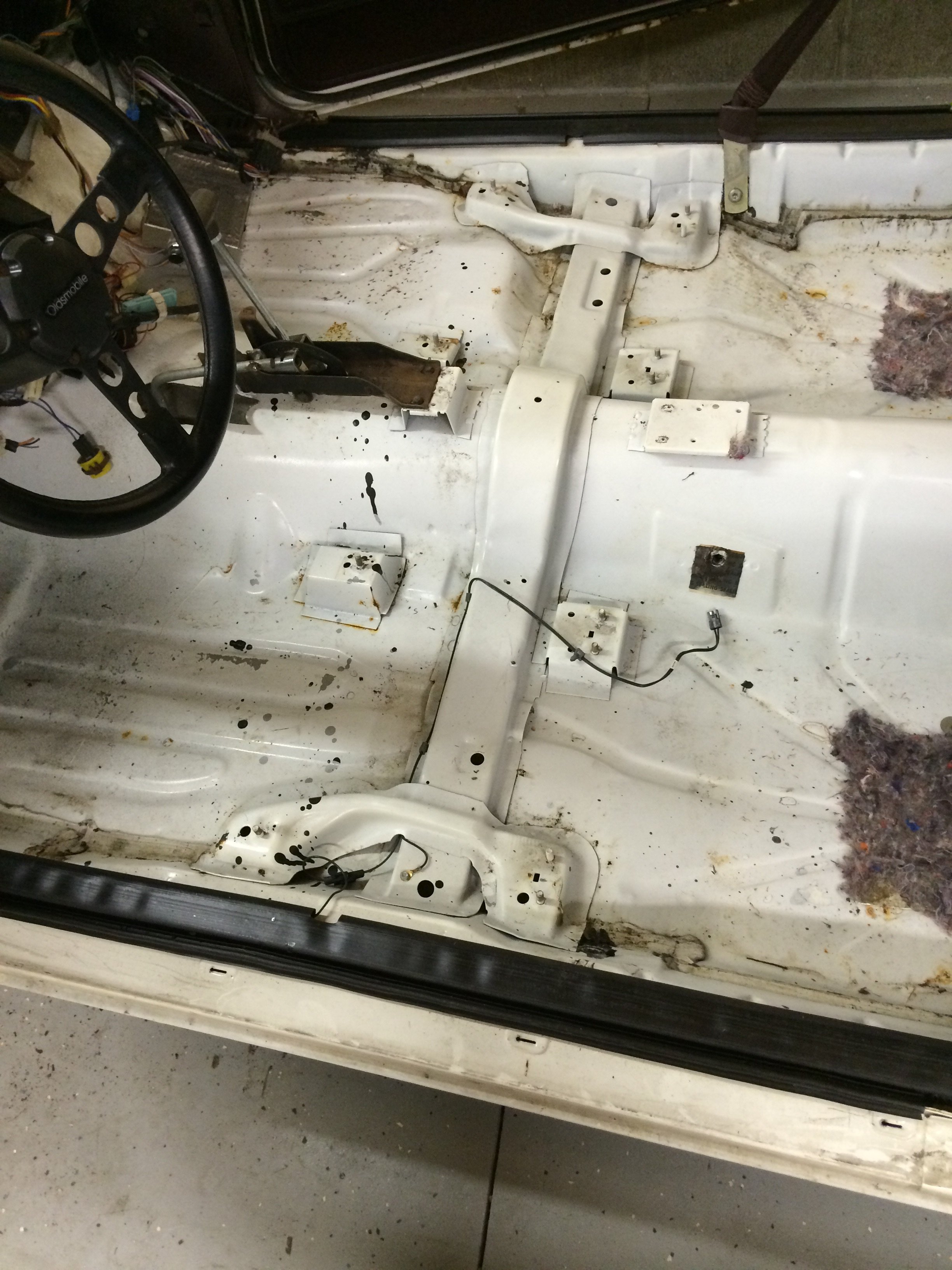

The previous owner installed a tilt column and steering wheel from a gen 2 trans am in my cutlass. Did a pretty nice job. Nothing hacked up that i can see and they even fabbed "Oldsmobile" into the horn button
View attachment 37887 The previous owner installed a tilt column and steering wheel from a gen 2 trans am in my cutlass. Did a pretty nice job. Nothing hacked up that i can see and they even fabbed "Oldsmobile" into the horn button
Nice clean floor!
