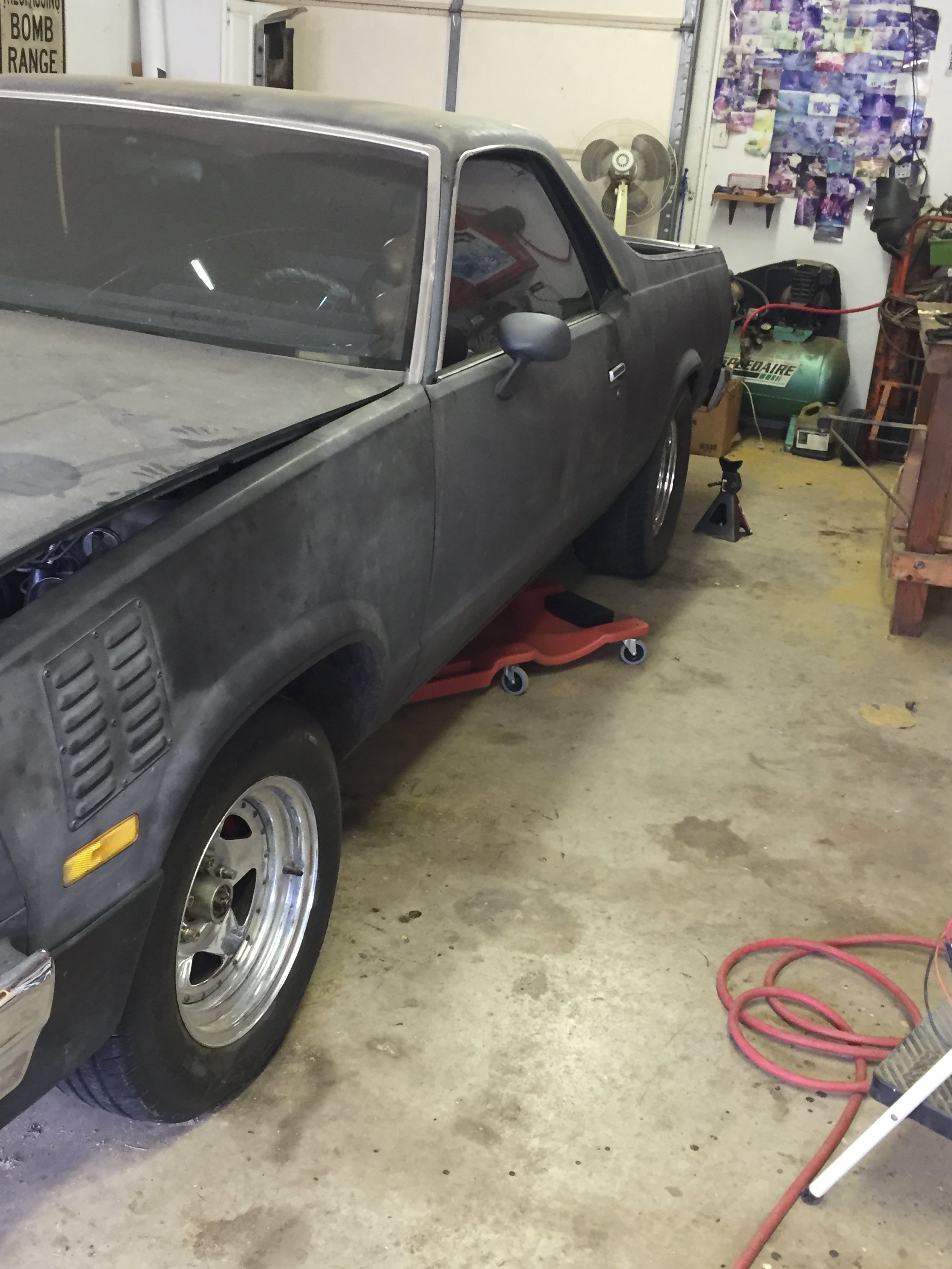

Yikes those "vents" are awful.
When I saw those things on the car for the first time I just wanted to touch the car and say, "well bless your heart you poor thing." The old man who owned the car couldn't pick a style. It had street rod wheels, a ricer wing, these vents lol. He did the interior very tastefully but he lost it on the exterior. Luckily I have a brand new driver fender. I need to find a passenger and I will do the swap, but I refuse to spend 400 on a GM good mark fender and that's all I can find locally. Can't find any decent pull offs on eBay or craigslist either.
