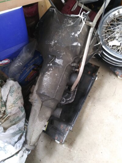

Gotcha. So the Older non-lockup metric has its own cover then? I just picked up a free trans from a friend. which has confirmed 52k on it from an ultra-mint 79 GP. Eng blew up. (301) they didn't wanna fix it.No.

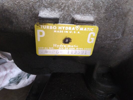

It is a 1979 Model THM-200 Metric. Non-Lockup. My starter is on the Passenger side. I was told by a friend since the Bellhousing is a BOP it has a different valley than the chevy. If that makes sense. I don't usually get down technical with it much anymore. Any idea what the Tag says?Depends on the application in most instances. What kind of transmission is it?
USUALLY, the cover pans are pretty close if they are bolted behind engines with the starter on the same side as the original transmission cover starter hole, and of the same class, like Metric, or SAE from the old days. Which doesn't mean much except the use of metric fasteners or not. Exact fits? Maybe, maybe not. In your case, the transmission came out of a car behind a 301, so the transmission cover should fit, or almost fit, with most BOP engine applications. I've never done any physical comparison of covers to check for angle differences, or width/spread between bolts, etc., so although it makes sense they should be at least close, exact fits can't be guaranteed.

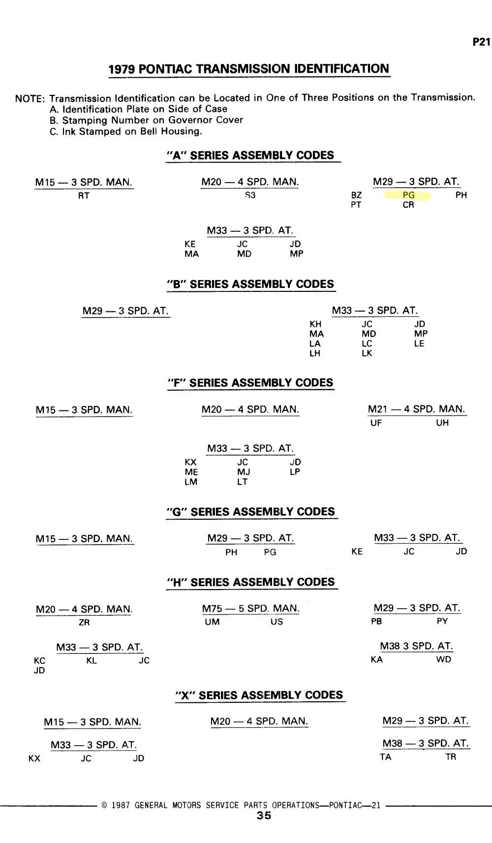

Wonderful! Thank you!!! I completely forgot about this. What book is it in again?Built in 78, 13590 car down the line. Likely late 78 so 79 model year. They used PG for both years.
