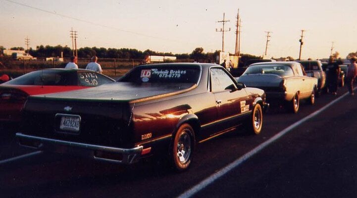

I had 225-70r-14's on a set of 6 window rallys and had no issues on an 86 El Camino. Should be the same backspace as the star styled wheel. I also ran 245-60r-14's on a set of 14 x 6.5 Monte Carlo Checkerboard wheels and had to just trim the lower inside front corner of the front spoiler/air dam for clearance.
This is with the Checkerboards.
