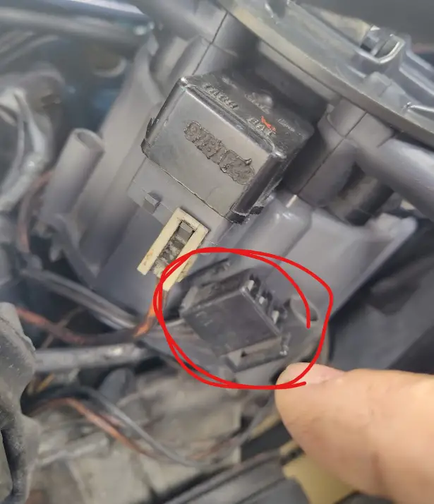

Since it seems we are chasing a no spark issue now...make sure you didn't dislodge the white connector on the cap when you pulled the EST. I've gone through a few ICMs on a Buick 455 as that seems to be such a horrible place for electronics. Anyhoo make sure you slather on a good amount of the thermal paste between the ICM and the distributor mounting surface. Since you had the dizzy cap off, one other thing to look for is the little carbon pellet in the bottom of the distributor cap making sure it didn't fall out.

With EST disconnected, the car won't start. I replaced the ignition module and coil and it still won't start. I thought it might be because it's too far out of base timing, or that it's not getting spark. If I turn the engine over with EST disconnected, the timing light won't flash, so It's not getting spark (right?). Where to go from here? Getting frustrated...
We seem to have a little confusion here. The connector you have circled in the 1st photo in post #7 is NOT what you would disconnect to do timing. That 3-wire connector you have circled there runs from inside the distributor to the coil. It must be connected or there is no coil, basically. So no start.
There is another connector from inside the distributor, that does not run to the coil. That's the EST connector, and that's the one you disconnect for timing.

This is not the plug to disconnect when setting timing. Those are the wires from the ignition module and pickup to the coil. The car will NOT start with this disconnected.
You need to disconnect the ECM wires to the distributor to set the timing.
The plug you want looks like this. View attachment 207958
Thanks for chiming !! Good grief I told him the wrong plug to disconnect 😵‍💫 my bad, its been almost 20+ years since I've timed one of these, I guess this forum is doing its job, because its relearning my brain too lol

When I changed the coil I should've noticed that the wires ran to this plug, & realized that it wouldn't run without these. It didn't occur to me.
