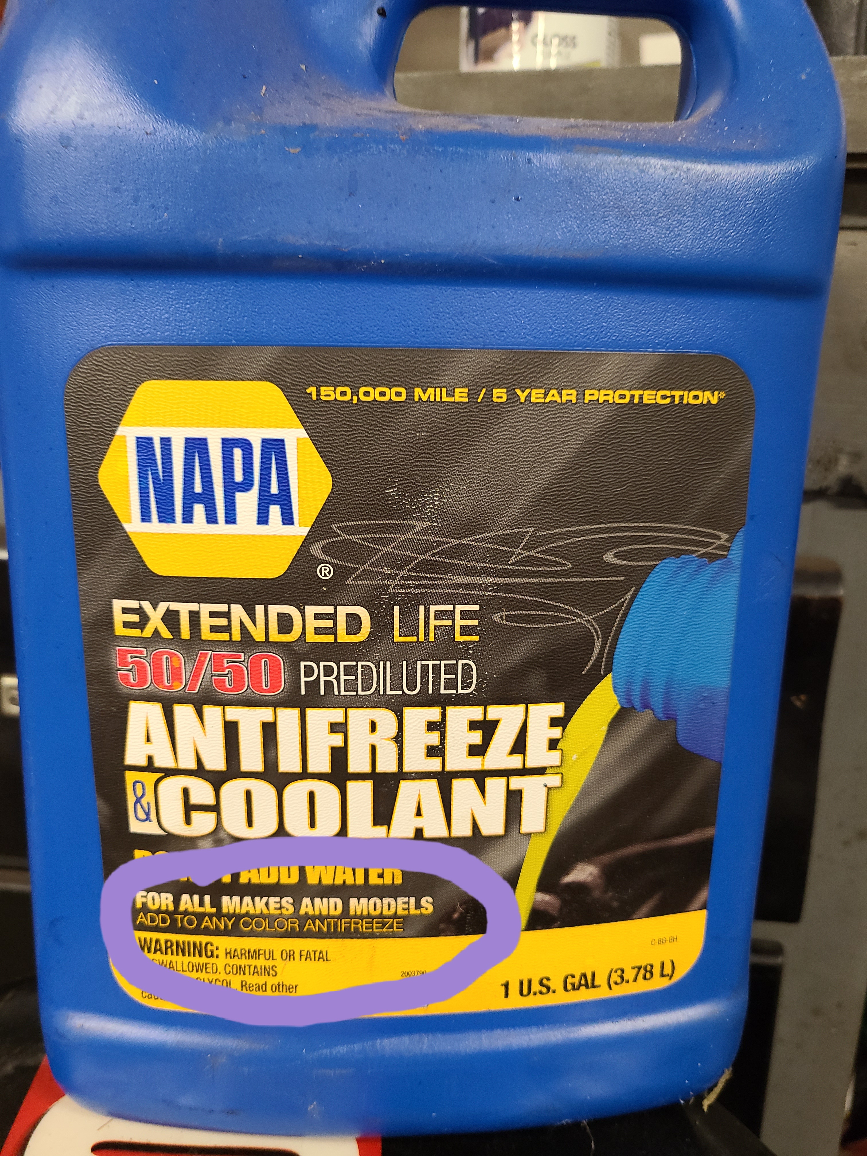

Green global coolant in everything I have to open up. Makes it easy for the next time. In case you haven't heard of it, the global coolant mixes with all types. Regular old green, orange dexcool, yellow Ford coolant, etc...
Didn't know that...
I believe most of the green coolant sold now is actually the global coolant. Look closely on the front of the container. They will say mixes with all types of coolant.
