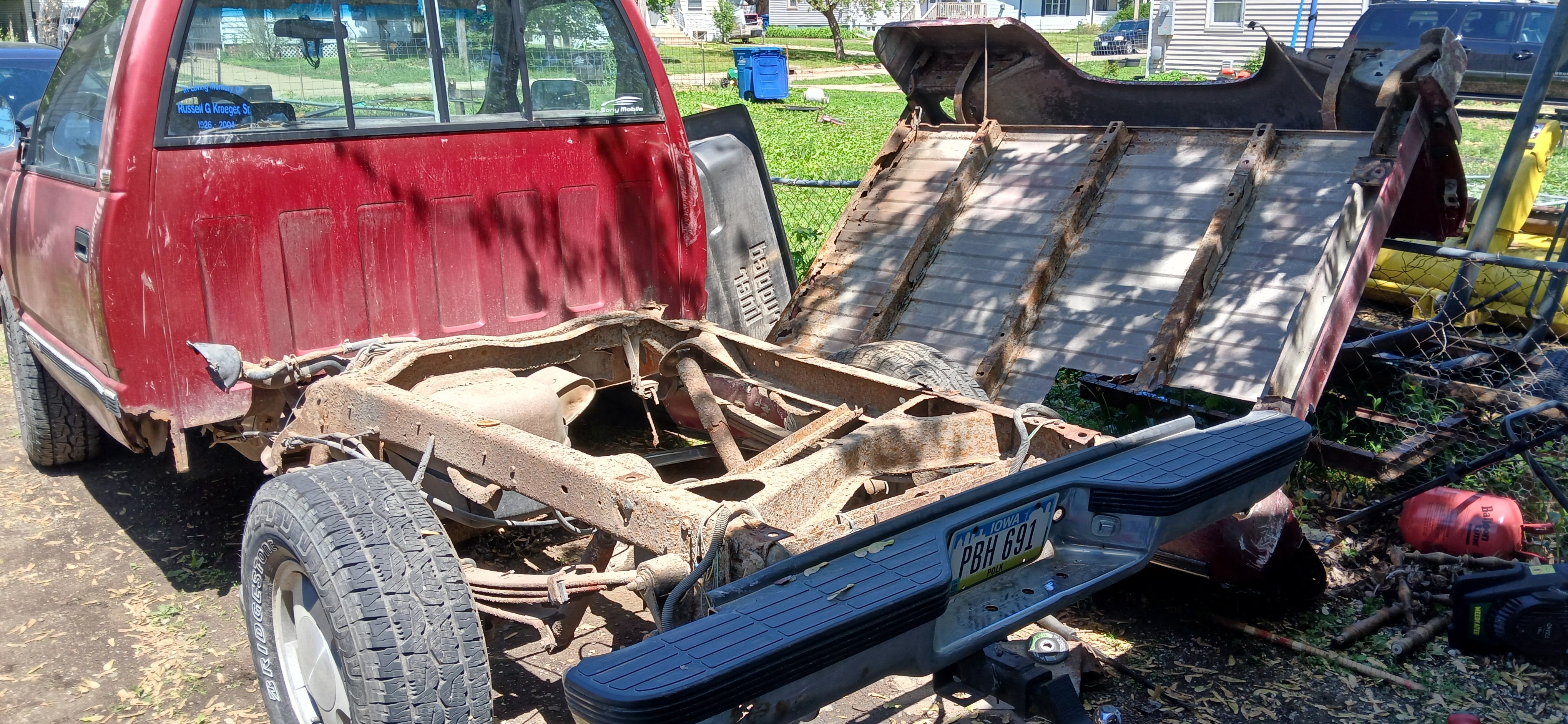

Bed off, fence bent, frame osphod (after pics).

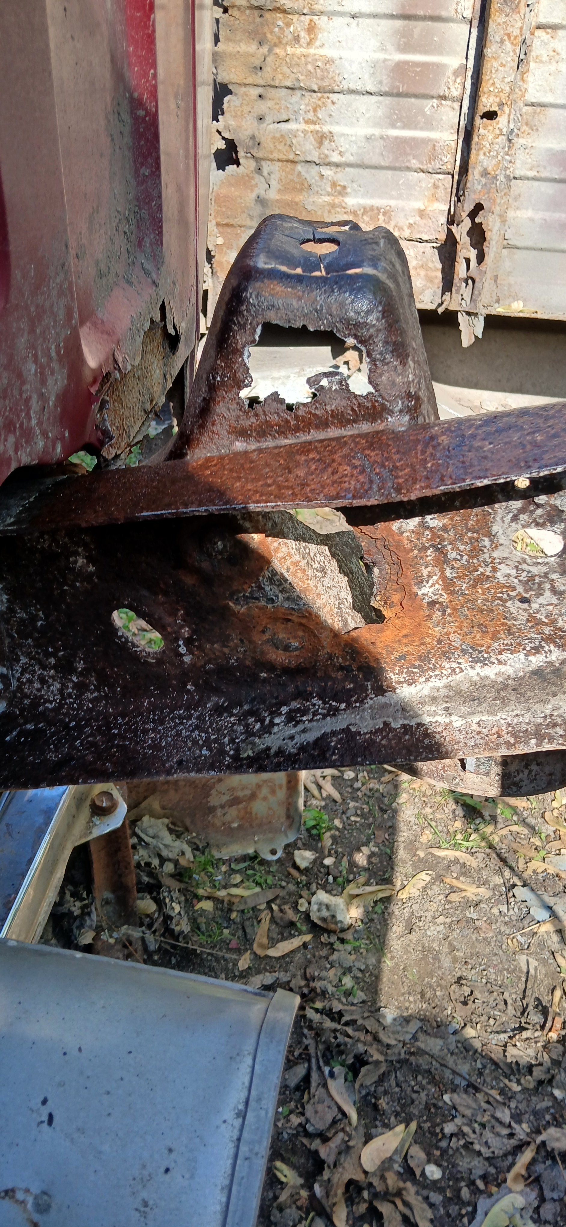

Found the only rot through. Probably gonna patch it from the back patch the bed mount on the top and call it good. It doesn't have to be pretty, it just has to last until the engine or trans gives out then it'll probably go bye bye.
