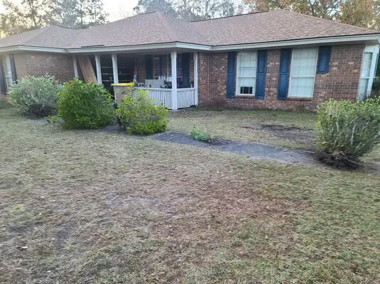

Removed a good deal (most) of the old shrubbery using tow chains on the front hooks of the yukon. Wrap around a few times, shackle to the hooks, no measly shrub will fight the 8.1L wrapped in a 3 ton beastie (yeah. I'm too lazy to unload it.)
Roots and all, one shot, it's gone. Much easier than digging. Place is looking better, quickly.
As for the replacement, I was leaning towards a Japanese garden style approach with rocks and ornamentation, not much in the way of new plants. And looking through the soils, I kind of want to put in a French drain situation to get water away from the slab on a related/unrelated note.
I've looked into the whole ditch witch thing, and, getting an older used unit upwards of $2k doesn't seem worth it for what I'm aiming for. At the same time, to do it right is probably 3 egress pipes running to the moat/ditch/defensive perimeter of the property. On one side of the house I have little options due to the buried utilities, so, I won't be running a drain across there. Instead it'll be front LH side of house to front road; frontnrh side of house, and rear rh side of house, to right side of road. Left rear side of house will need to go west to the border of the neighbor's land. All told without gis measuring it out I assume about 600 ft to lay

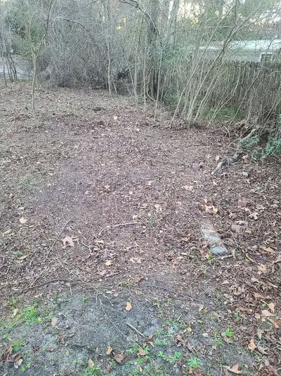

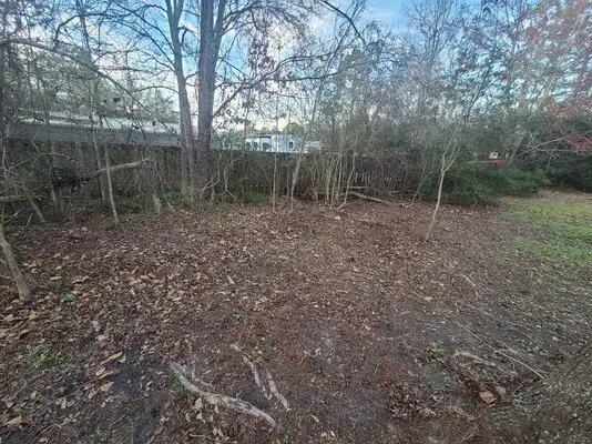

Today fully cleared another 12ftx40ft patch of brush and trees, then we burned it. Also burned 2 stumps. Then thinned out the brush and trees for another patch about 10ftx60ft
More of the land is getting cleaned up towards the fence line. At this point there's about 10 feet of buffer to the property line remaining, that's were I did the thinning. We've been getting mailers from the arbor day group, and I think both the wife and I will take them up on their 'special offers'.
Using the plants they let you choose from I'll likely finish clearing what's left behind under 8"DBH along that fence line and install the mix of crape myrtle and all the rest they let you get nearly free back there.
Still more work to do, but, it's coming along.

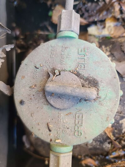

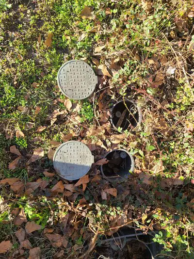

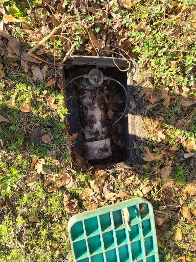

So, more adventures in tracking down dumb s*** people do...
At first I thought we had an issue related to various sprinklet system equipment that hasn't been maintained in... ???? years. My bet is at least 20.
Some kind of sprinkler/irrigation/fertilization system. Found it hidden by overgrowth.

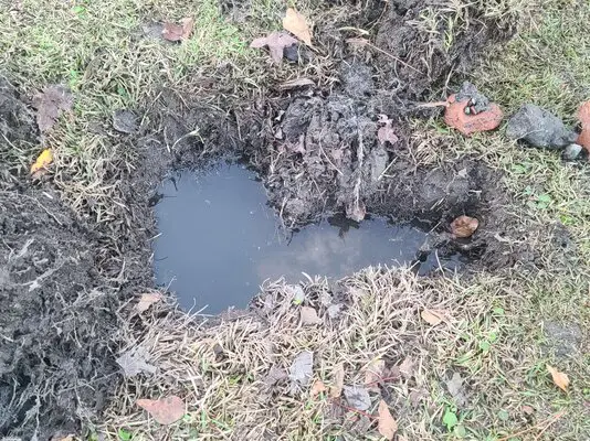

The only reason I found it is we had, I thought, a sprinkler leak based on some water coming from the ground through the grass when mowing on Thursday.
Well, today took some time for exploratory diggings, trying to trace water flow. I expected to find some buried hose, line, fitting, whatever.
Whelp, eventually I got to where instead of seepage flowing from the side of a hole, it came straight from the bottom.
Dug down with a small trench shovel, got to something hard I felt water flowing past. Turns out, it was a piece of broken brick. Then a piece of old wood/root. Then another piece of brick and some small crushed granite stone. Clearly backfill debris.
But solid water from below. Slowly.
Eventually, walking around, I heard noise from over by the house and see the water bubbling up faster. Got near the house, and, of course the noise stops for pinpointing purposes.
Open the door and notice the wife is running the washing machine.
So. It appears at some point a grey water line was run from the house with construction debris dumped on top buried a foot down, and just left there, leading to sunken areas in the lawn. Just so happens I caught it in a saturated phase.
Still not sure everywhere that is connected to this, as it's nowhere near the septic. Maybe test various drains and water sources with some dye of different colors a week or so apart, see if I can identify it with the colors? Then I can decide how to remediate.
