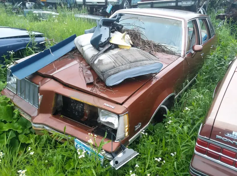

Started with these, pretty clean and cushions in nice shape. Someone swapped them into a Cutlass before the owner wanted original style seats. I got them from 85ss/85gn. The covers are available if anyone is interested, I'm sure they are better than some out there with this blue, out of a Grand Prix originally.
Wanted the f-body vertical pattern and I added PMD emblems I found when pulling a super rough set of PMD's out of a local yard (with new inlays). Cut out the emblems and sold the seats on eBay to someone in Europe. The bottom frames were rotted from sitting in the yard/exposed to elements for so many years, it was bad. The buyer was very happy with them though.
I'm glad to have such nice ones to use as cores, only damage/wear is the lower driver outer bolster had two cables broke coming through the foam a little. I rigged them together and covered with some foam off my stock bench but they aren't really noticeable or can you feel it, these seats are comfy yet pretty firm.
