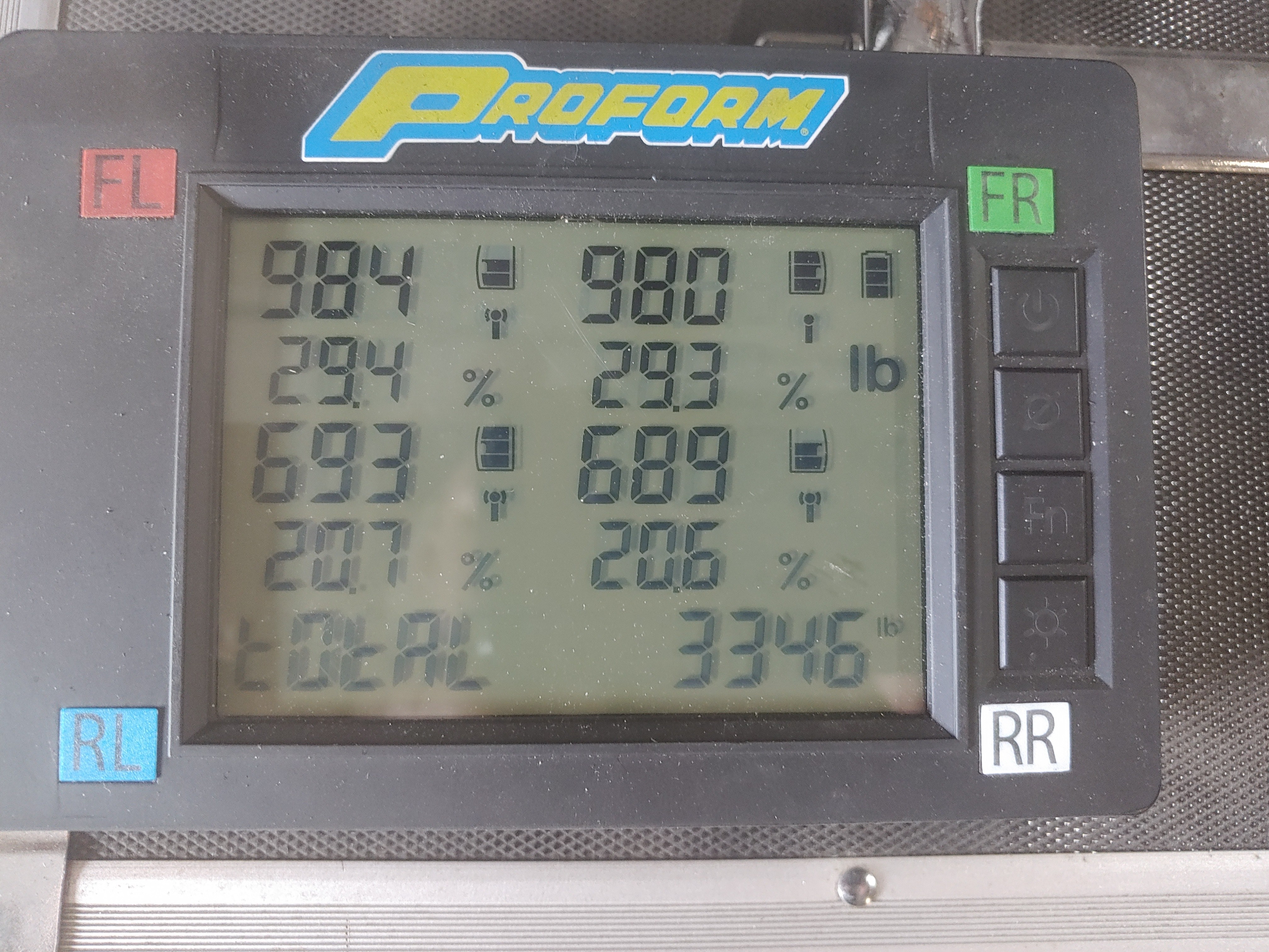

That's light, but....the percentage is not fabulous. You still have the battery under the hood, correct? And is that with a full tank of fuel?
Reactions: Tony1968
Full tank. Battery under the hood. My buddy says they shoot for 58-60% on the nose for a fast radial car.
MUCH lighter than mine!! Holy smokes!!
Reactions: Tony1968
Lol. It has no heat, ac, radio, a kirkey and a back seat, and manual steering. The blower and intercooler definitely add weight tho. Wallace calculator nailed my 1/4 time to within 0.04 seconds and 1 mph.
