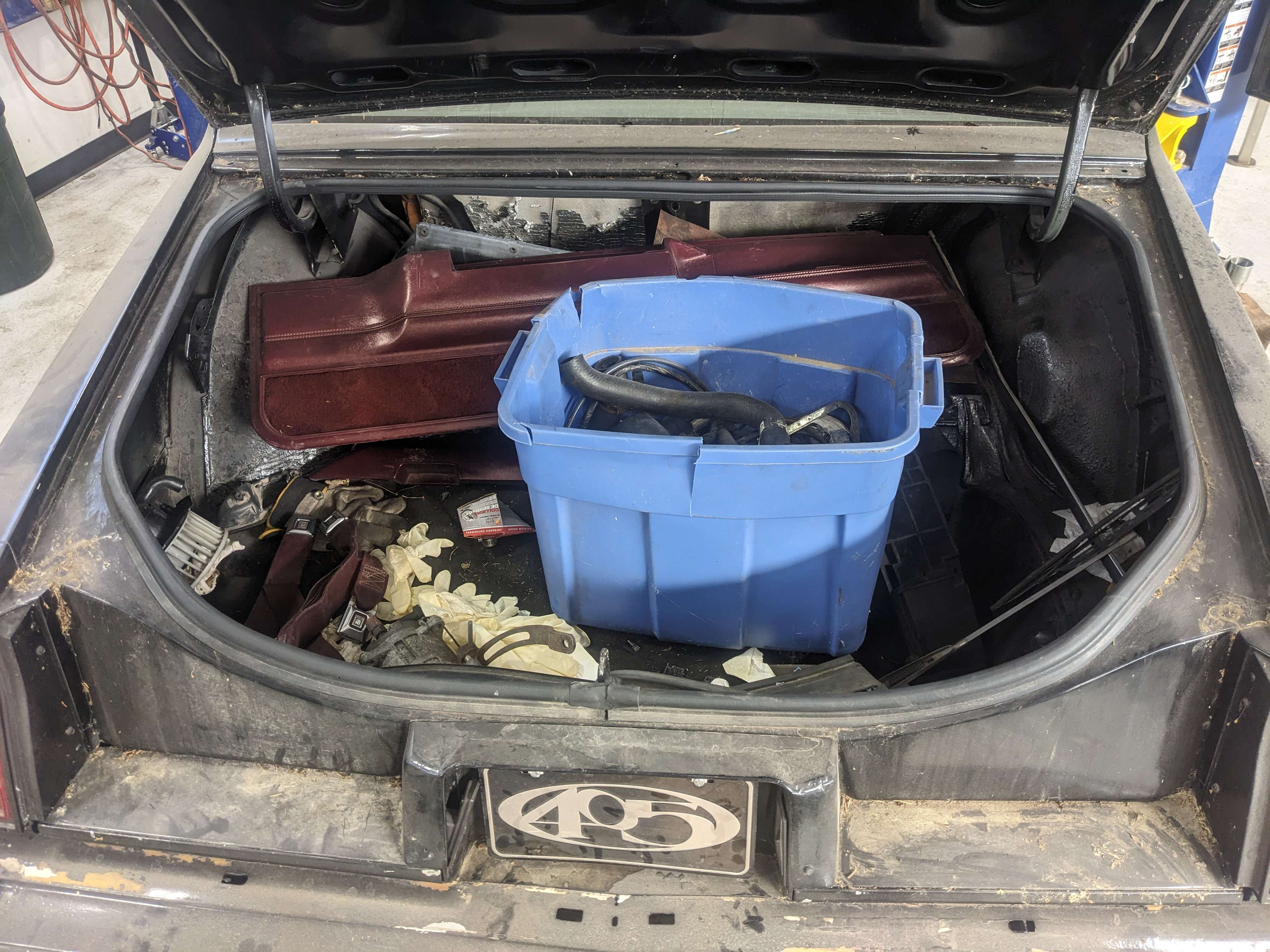

On my 88 monte the fuel gauge wire off the tank is pink, it connects to a red wire that pops out of the tail light harness. Both are 12awg. From the harness it runs to the connector in the trunk.Cracking into this now, started with the shop vac. I'd forgotten about this treasure chest.

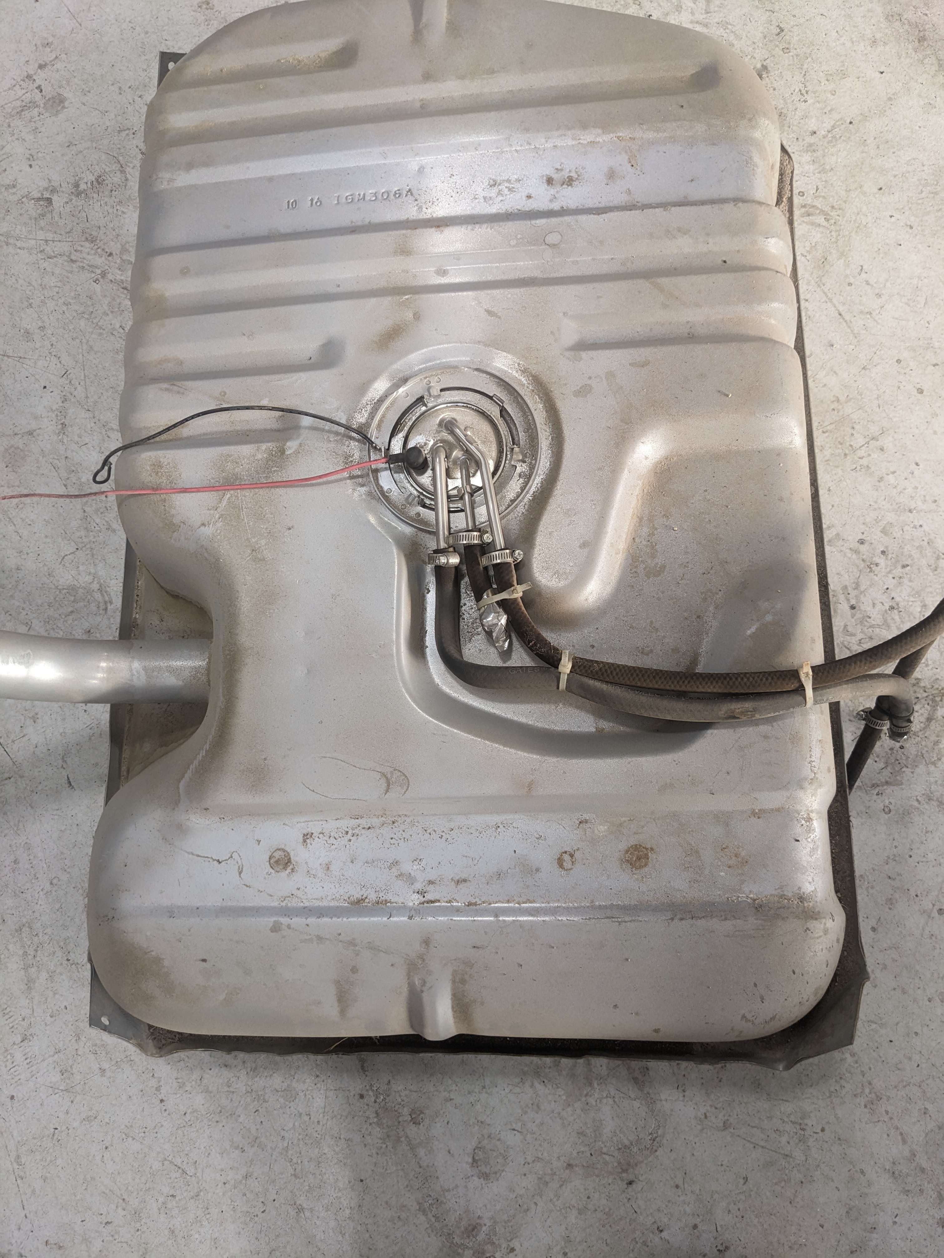

Did the interior and exterior, so much better. It wasn't terrible like 20 years of neglect or anything, too much has been replaced in recentish years, but good to have it where it is now. I'm kind of doing an inventory as I go, found some seat belt receptacles in the trunk. Good thing I bought some off of here a couple years ago. Next I dropped the tank to get rid of the wires that were crappily zip tied the length of the frame. I had this sender on hand.
So I figured he'd done the tank with old sender and had a problem.
Nope. Looks like he got one without the charcoal canister line. May as well swap it since I'm here. Can anyone confirm if this wire is for the fuel gauge?
It dips into the factory harness. The fuel gauge has always read E and that's an item I want to address, at least back here. Inside the car is easy.
