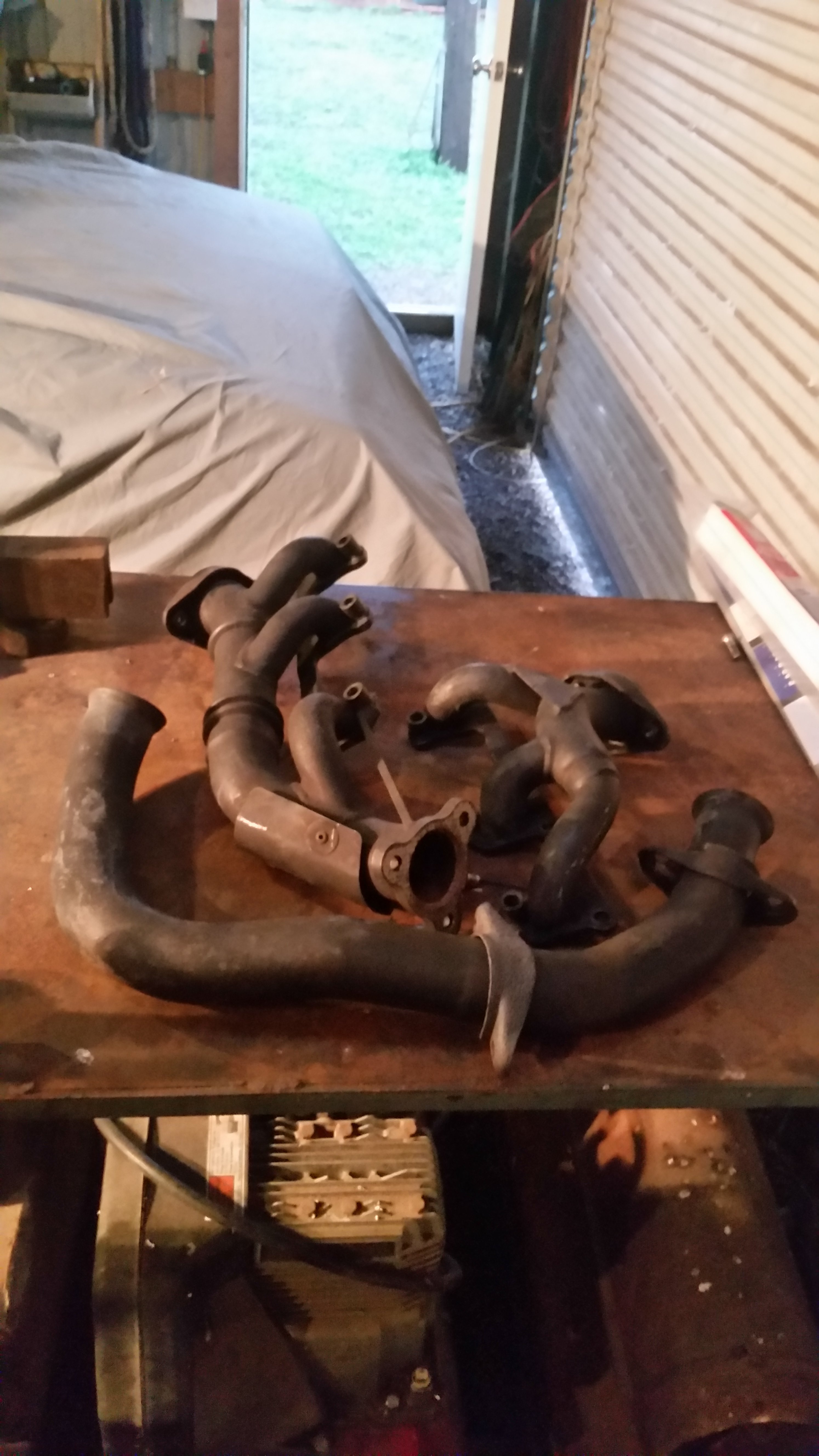

View attachment 86437 Here is what stock 87 intercooled headers look like.
And the turbo bolts directly to the 3 bolt flange just forward and above the passenger side exhaust manifold and not "left turn, Clyde" straight up to a 2 bolt flange to attach to a bent 1 foot pipe to a 4 bolt turbo flange that puts the turbo who knows where?
Running 800 degree exhaust pipes over the top of a motor is usually a stupid idea, with all those melty plastic bits, which is why the '86-87 header design came to be.
