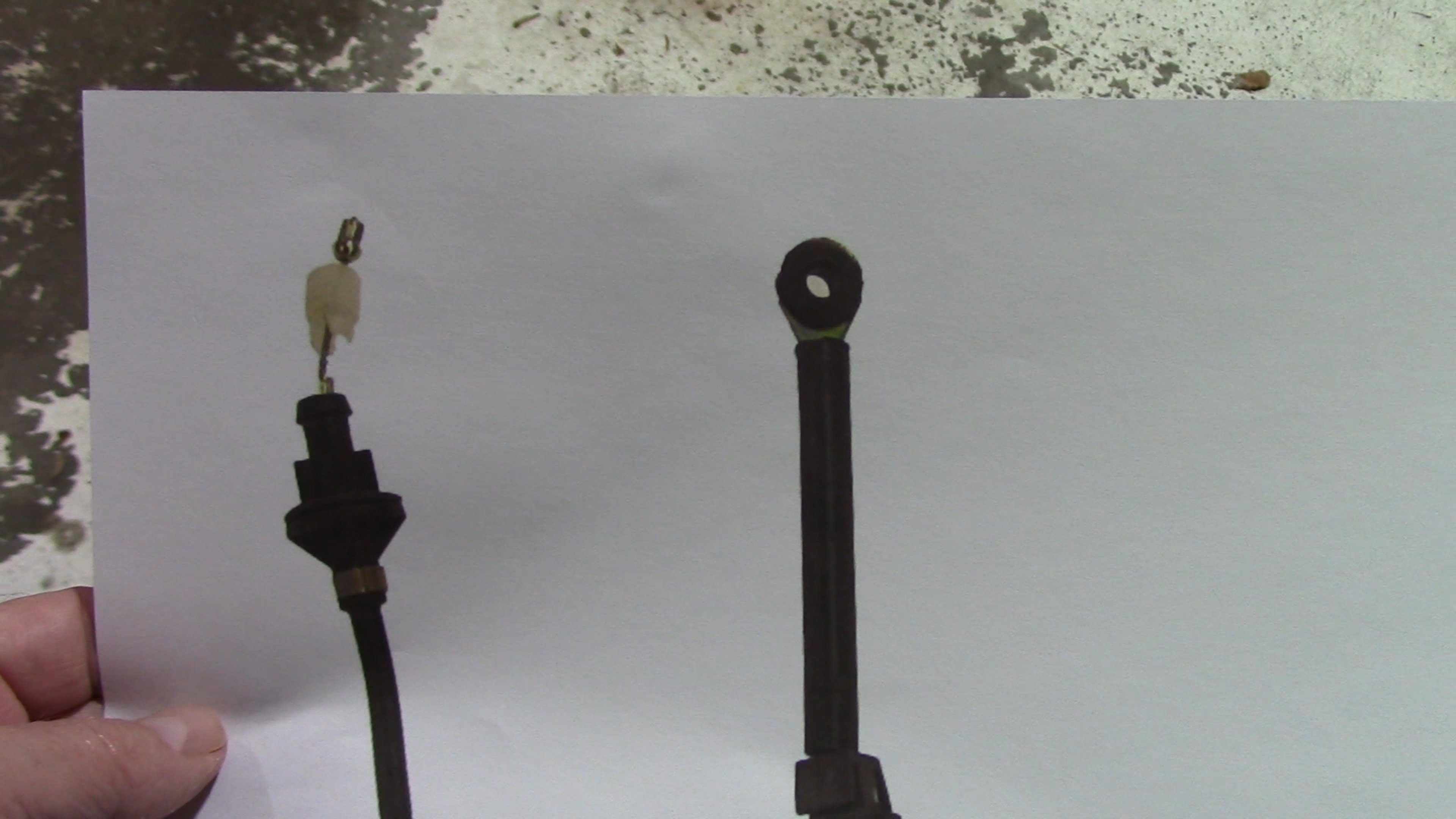

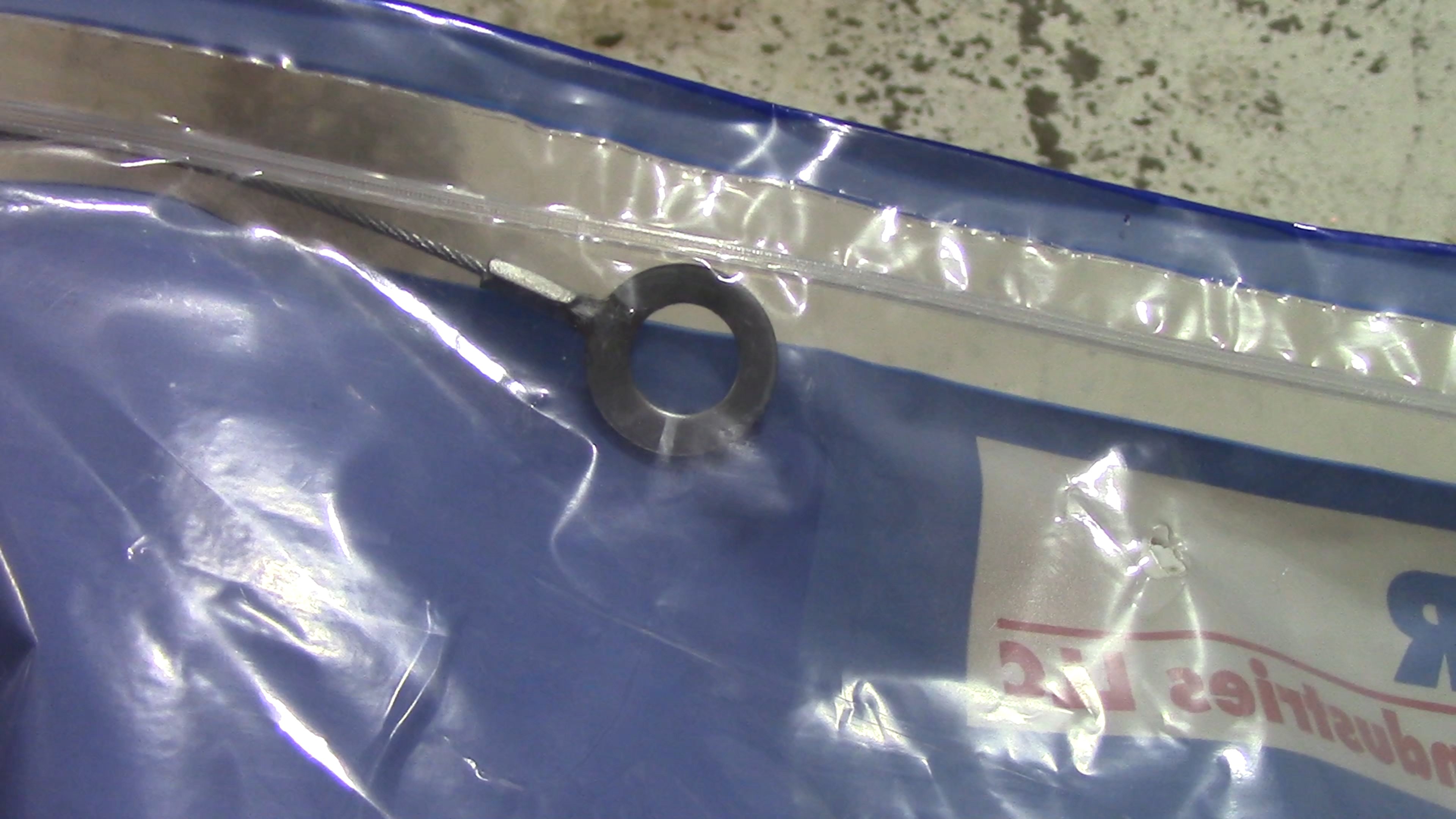

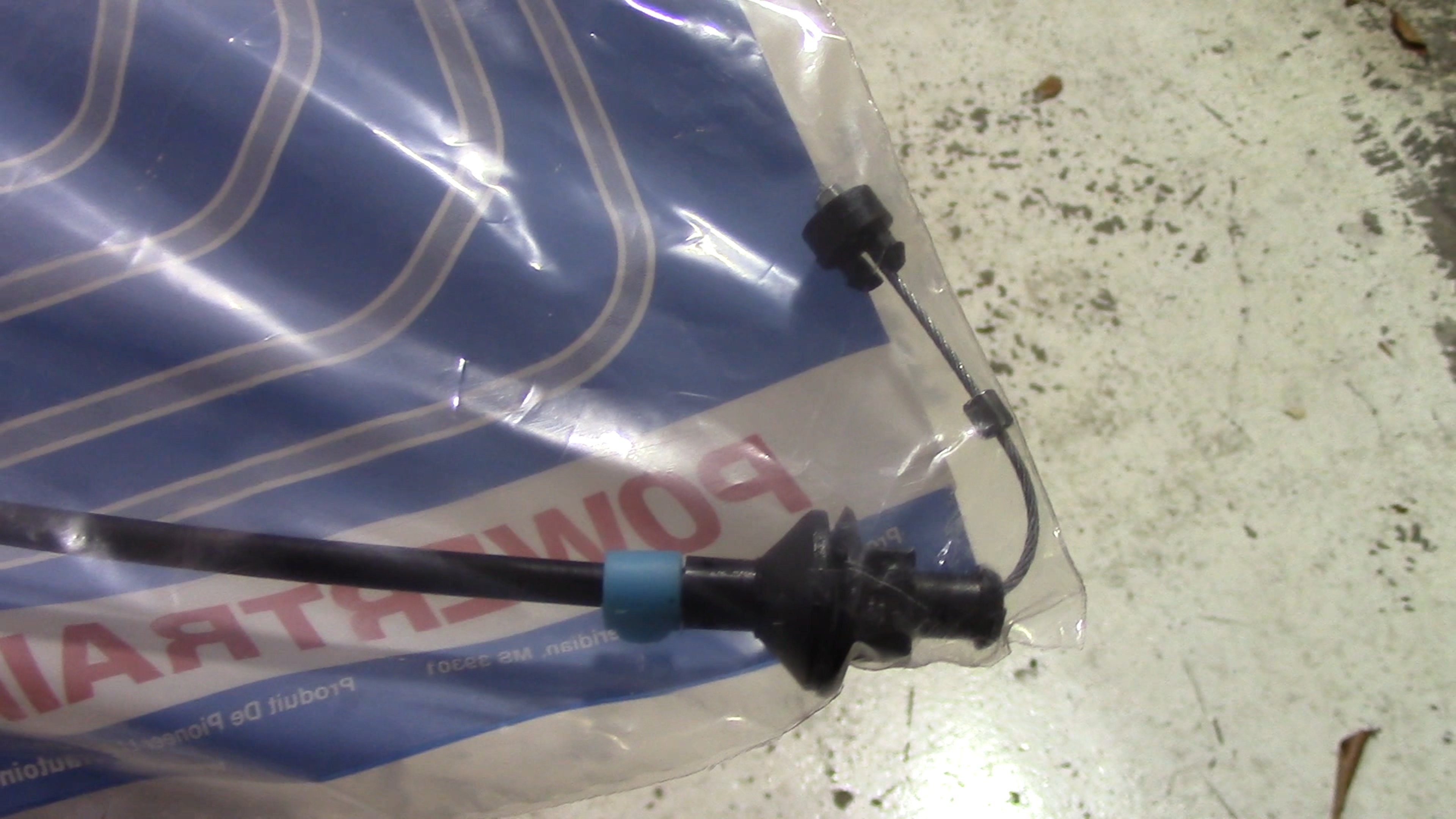

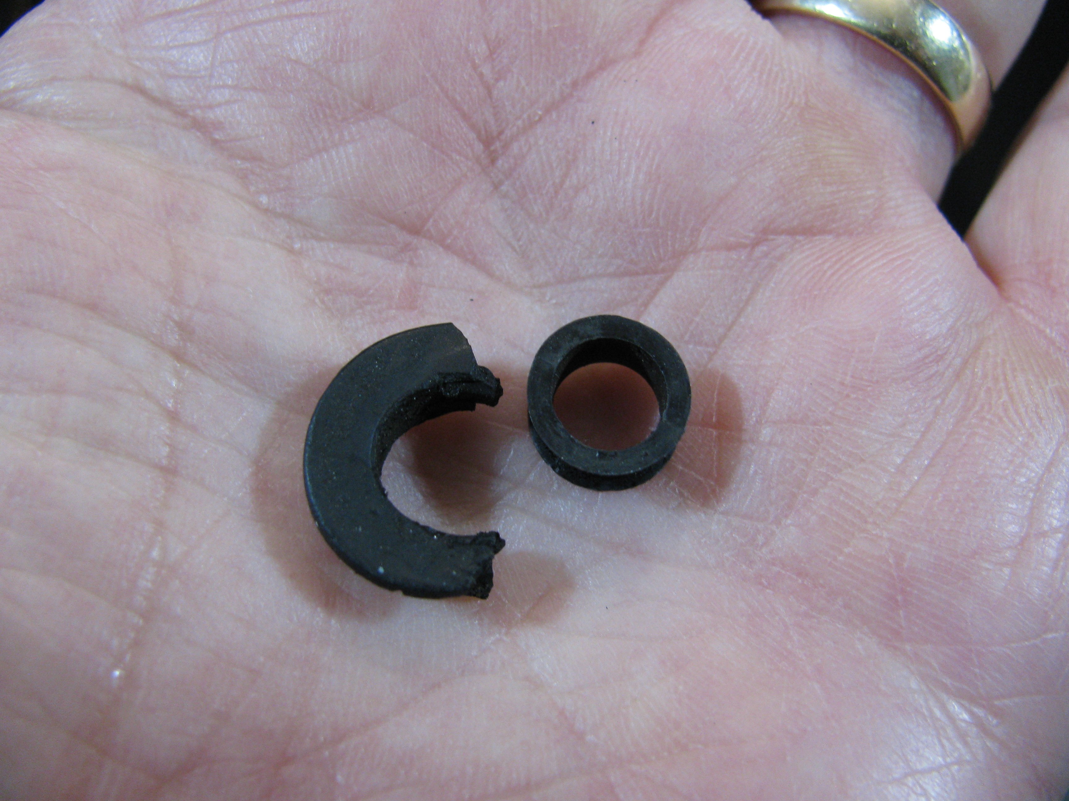

I was looking at my Throttle Cable. The bushing/o-ring is cracked and brittle. You can't find the bushing by itself, so I ordered a new one. First one was by ATP, the second from Pioneer. Both are wrong for my 442.
The manufacturers picture says it looks like this:
This is what I got. It looks like a head bolt washer on the end of a cable:
Both companies cable looked exactly the same except one had a Red plastic collar on it and one was Blue:

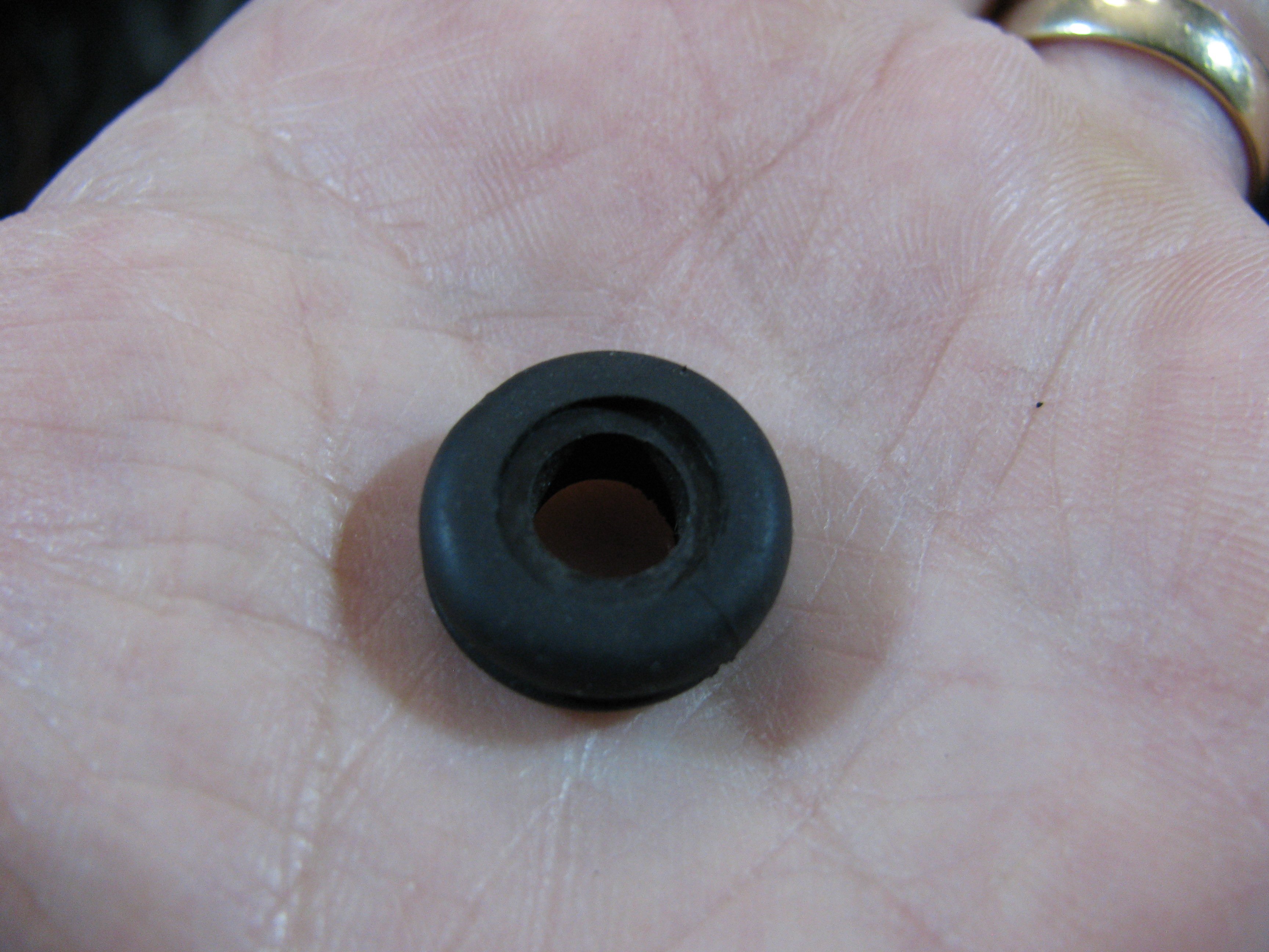

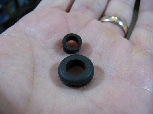

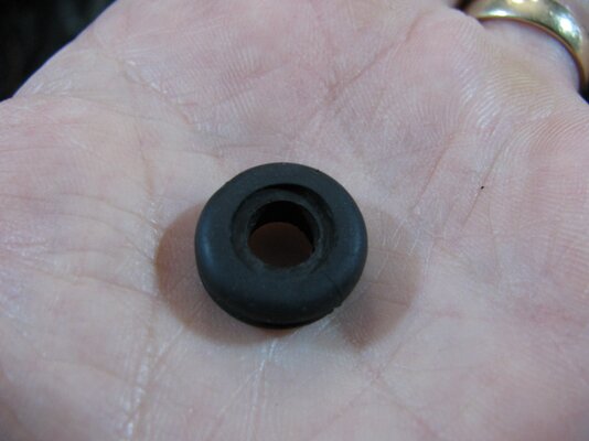

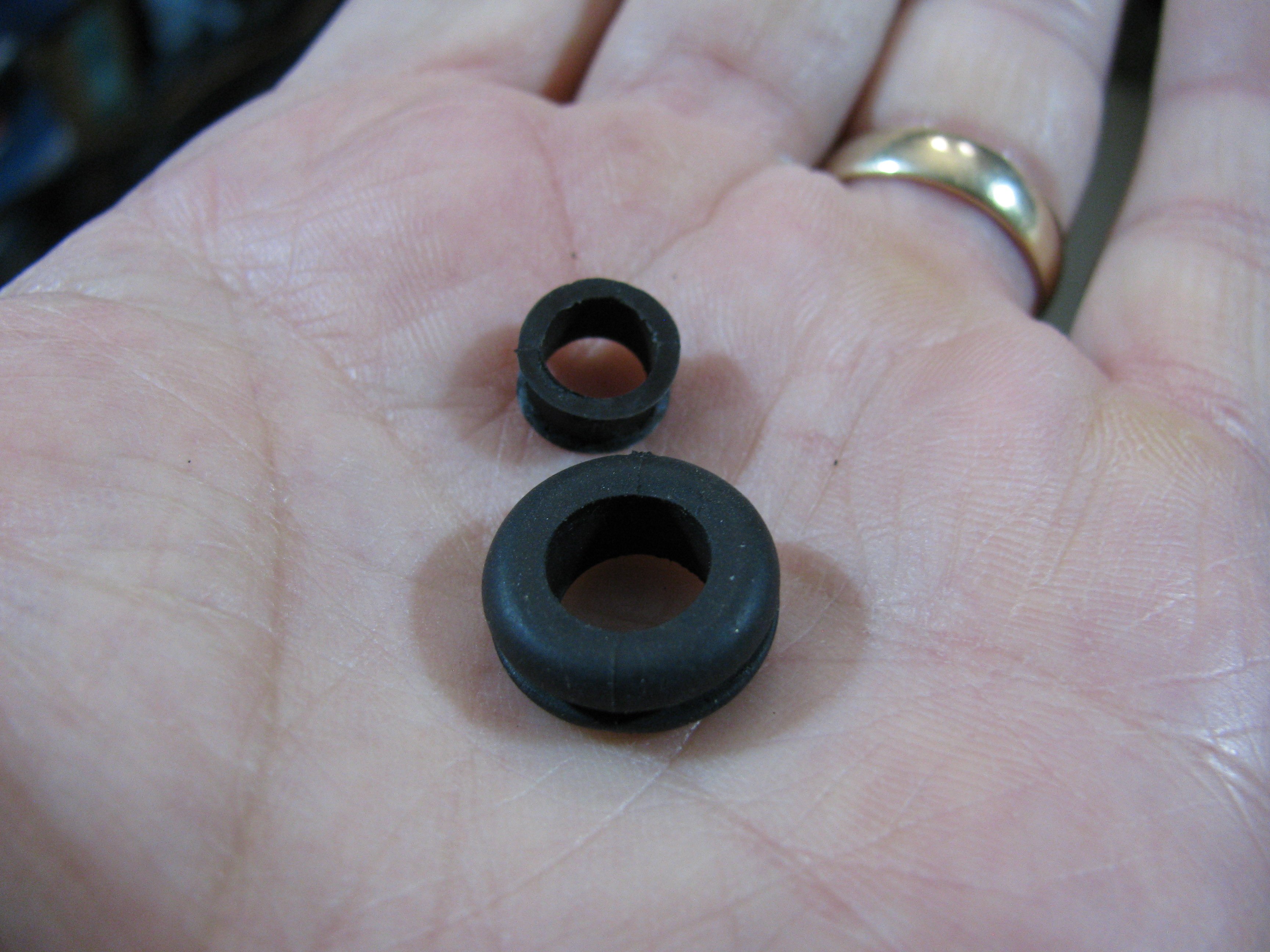

Guess I have to make my own. I started with an O-Ring kit I had laying around:
The 7/16 grommet fit the eyelet of the cable perfect. If the plastic center to your bushing isn't cracked or brittle, you can fit that perfectly in the o-ring:
I didn't trust the 38 year old plastic to not crack or fall apart at some point, so I looked for an alternative.

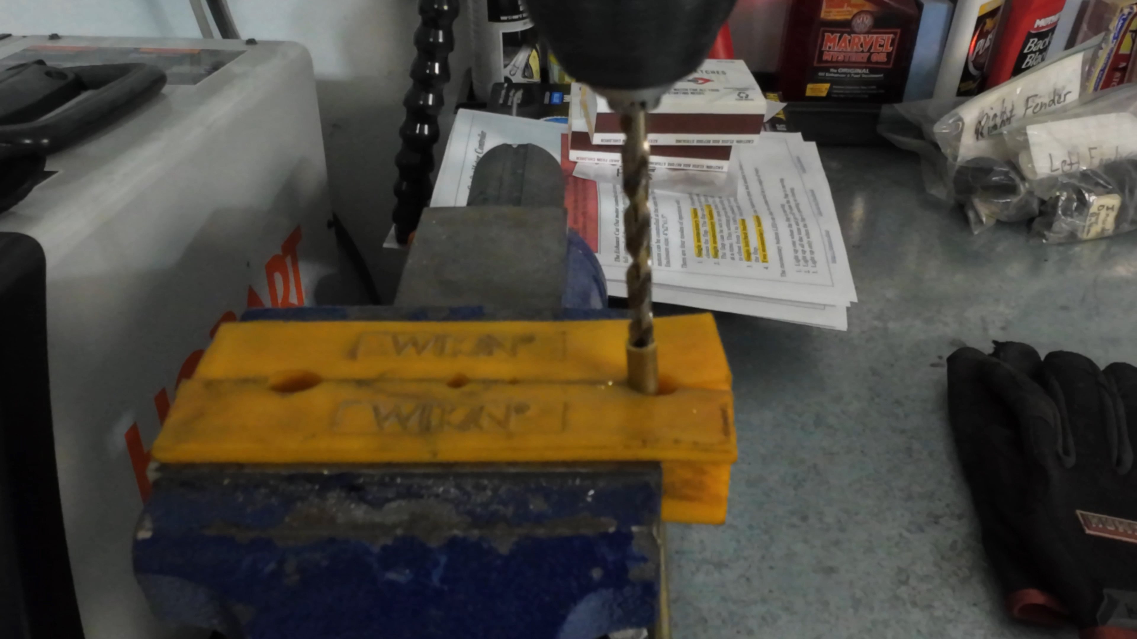

I found a Brass Round Tube on amazon. It's 300mm long, with an 8mm OD and a 1.5mm wall thickness. I drilled it out to 1/4" to match my carb stud.
I trim it to match the thickness of the grommet. It fits like a glove.
All better.
View attachment 255961View attachment 255962View attachment 255963

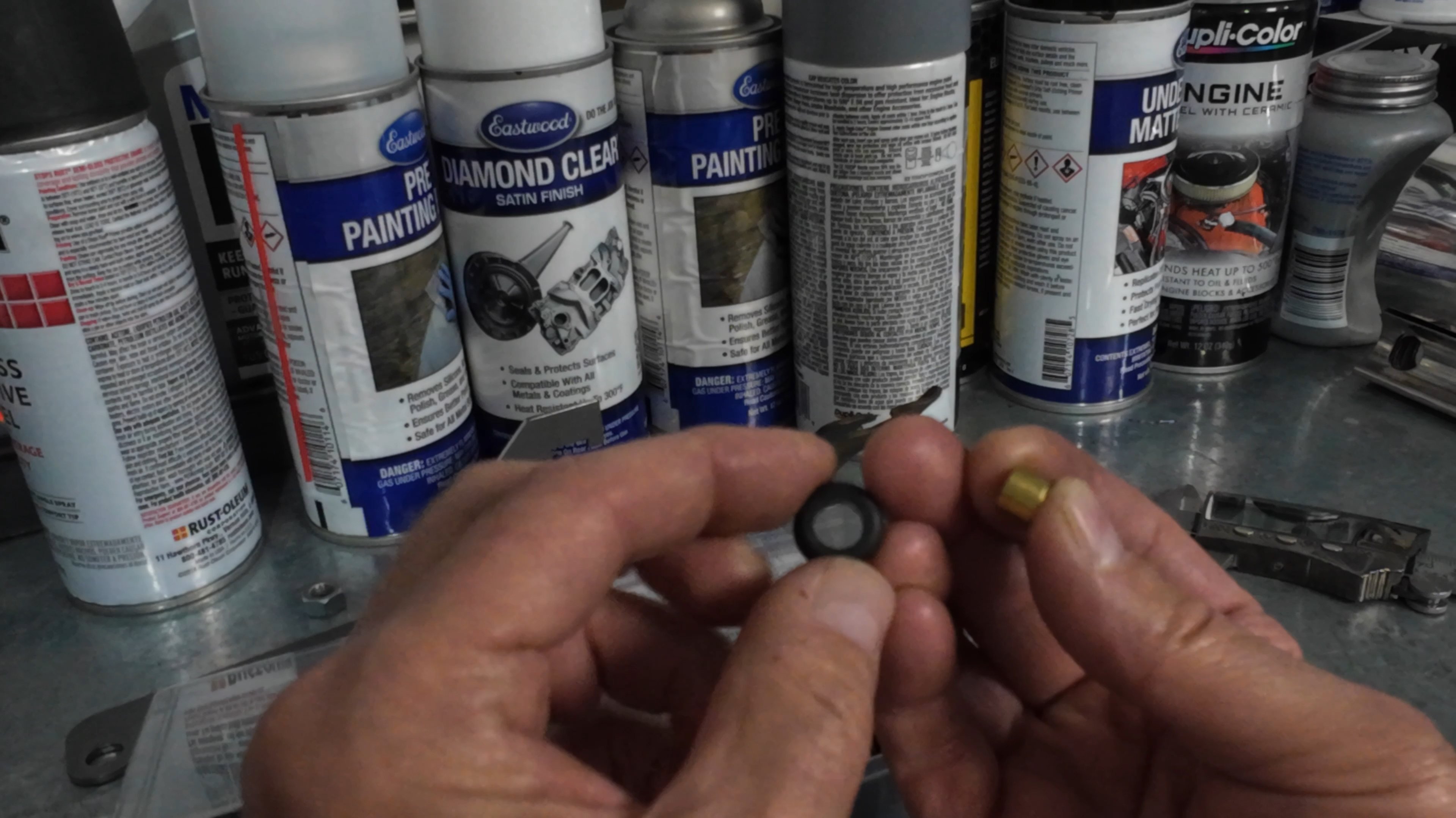

All better.
