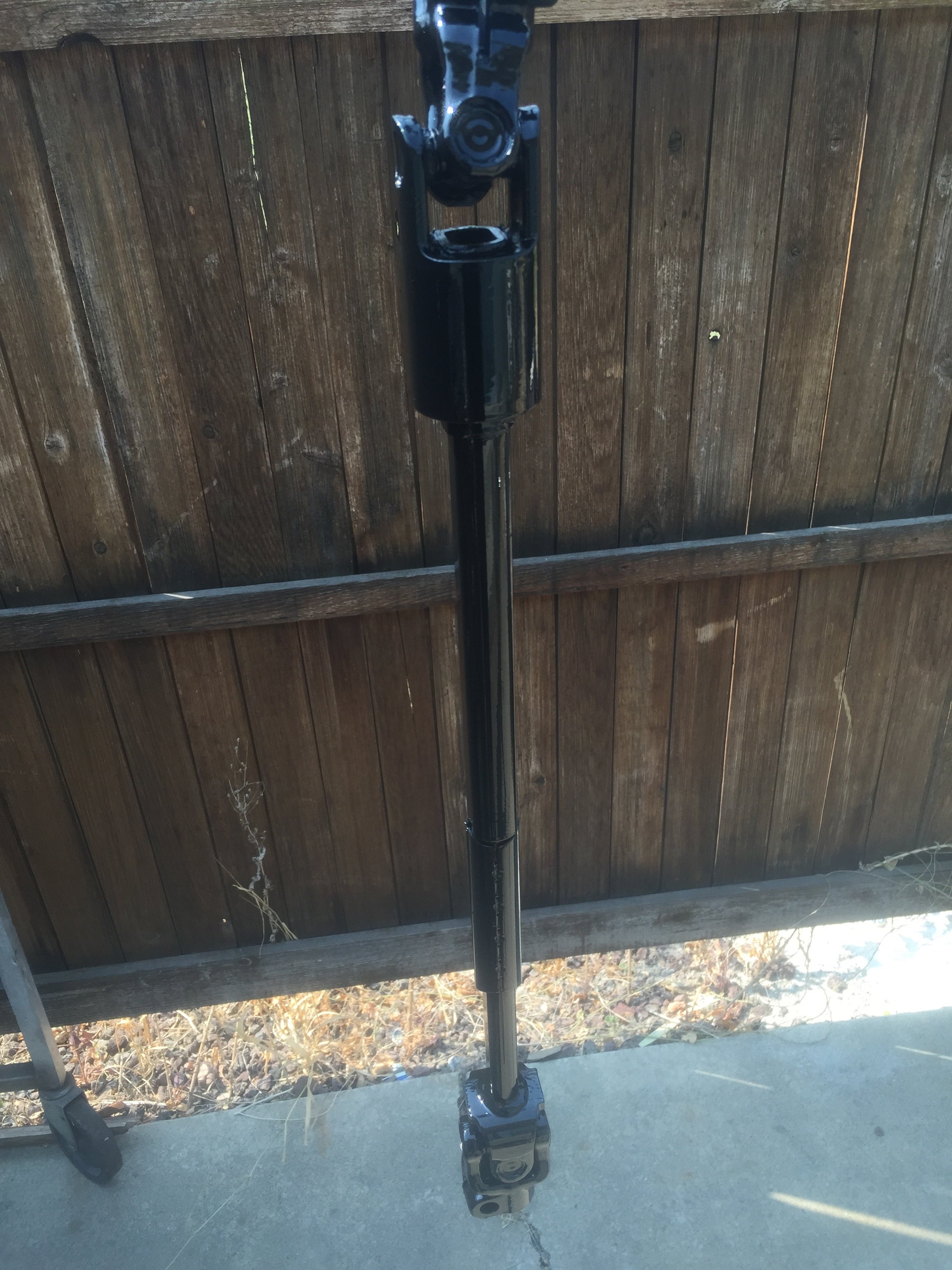

what should be the over length on these?
I would have to check not sure off hand. I do know u have to collapse them cuz they to long all you do is heat them with a torch where the smaller piece goes in the bigger shaft u heat it till the plastic burns out then it allows it to move in n out.
