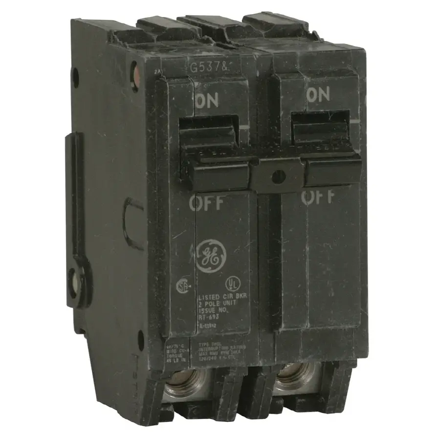

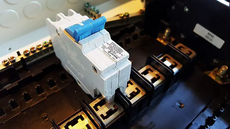

I did some more reading yesterday cause it made no sense to me why all the guys setting up a 240v compressor used a common 2 pole breaker. Turns out I had the 2 pole breaker installed incorrectly. The way I had it installed was to use it for 2 120V circuits. It does send 240v volts by line 1 and 2 but it has no way to alternate the current to allow the motor to run. The way I need to install the breaker is like in the picture so it can alternate the current. I had the breaker installed in between the dividers.
Main panels usually alternate legs down each side, so if you put a two pole in, it would work.
Yours looks like you could pull from the same leg. Could create a short that way.
It didn't even dawn on me until I saw the pic of that cute little blue and white breaker. I bet your panel is mounted horizontally and you're running metric current. CH is configured for American freedom units only. You've got some major retrofit ahead of you.

that picture was just an online picture to show what I mean (a picture is worth more than a 1,000 words in my case) The breaker box is instsalled in the upright position. The Snap Loc breakers come in different colors depending on the brand, white beige, gray and black
