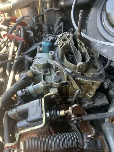

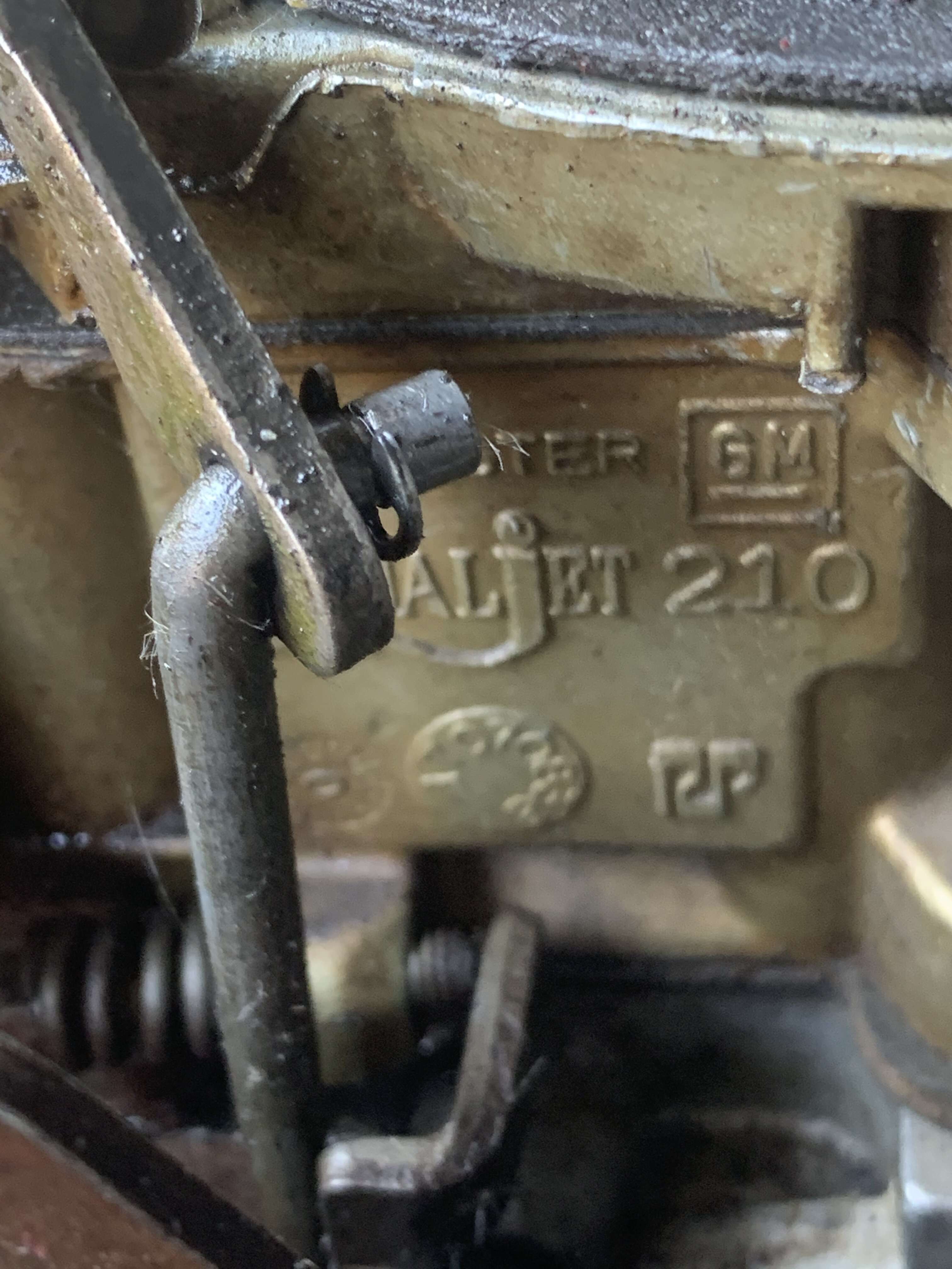

What kind of carburetor do you have? Post a picture.

Colorado? Like mile high? My guess, you need altitude adjustment. At higher speed the throttle is open, so more air. The air is thinner up there, it needs more air with the throttle plate closed.
would I adjust that with the two screws at the base of the carb? And it’s also throwing code 42 intermittently.
Yes. Clone can chime in on that, too. You watch a dwell meter while you turn. (Ironically enough, given your Code 42. The distributor has no use for a dwell meter.)
Clone TIE Pilot
Aug 14, 2011
3,859
2,611
Galaxy far far away
Yep, you use an analog dwell meter set on the 6 cylinder scale, regardless how many cylinders the engine has. The idle mixture screws are the course adjustment for both idle and off idle mixtures. While the idle airbleed in the choke horn is the fine mixture adjustment for only the base idle. Most of the time only the idle aif bleed needs adjusting.
