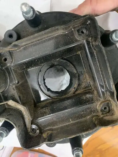

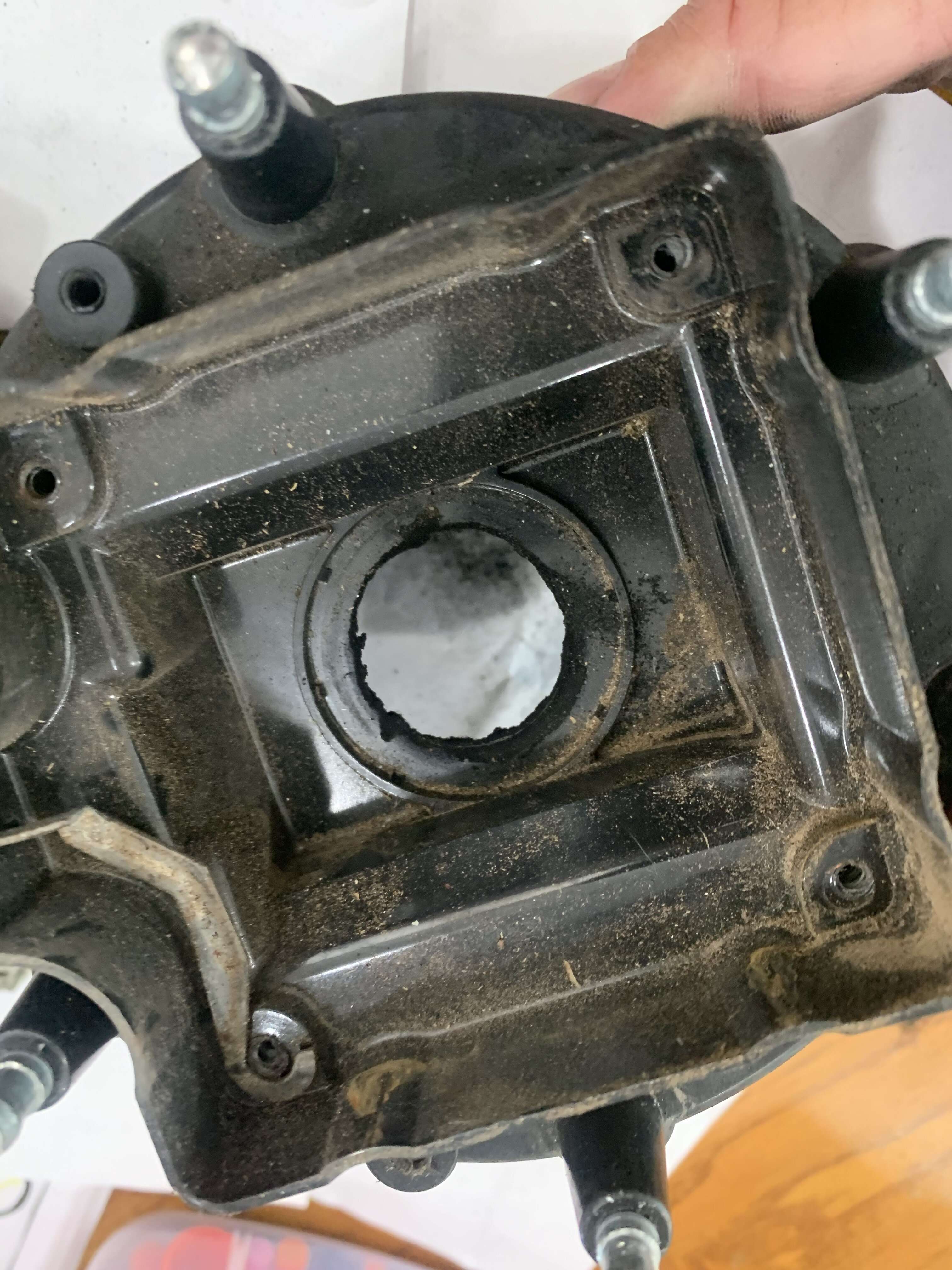

One thing I don’t understand is how the rotor, brush and cap go back together. I’ve looked all over for pics for a reference but all I can find are pics of vacuum advance carbs. Usually I’m pretty good at figuring how to put things back together but my distributor was so trashed I don’t get it. Mainly the brush.

Are you sure I need a new cap lol

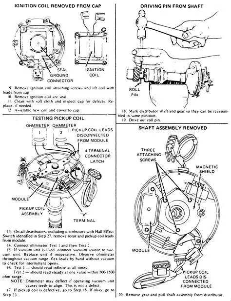

Carbon button goes first into the cap then the rubber seal with the spring going through the hole in the center of the seal. Then the coil goes in.

Have a new AC 336X cap sitting on the bench and it does come with the button and seal. Can't say for others brands but I imagine they do.
