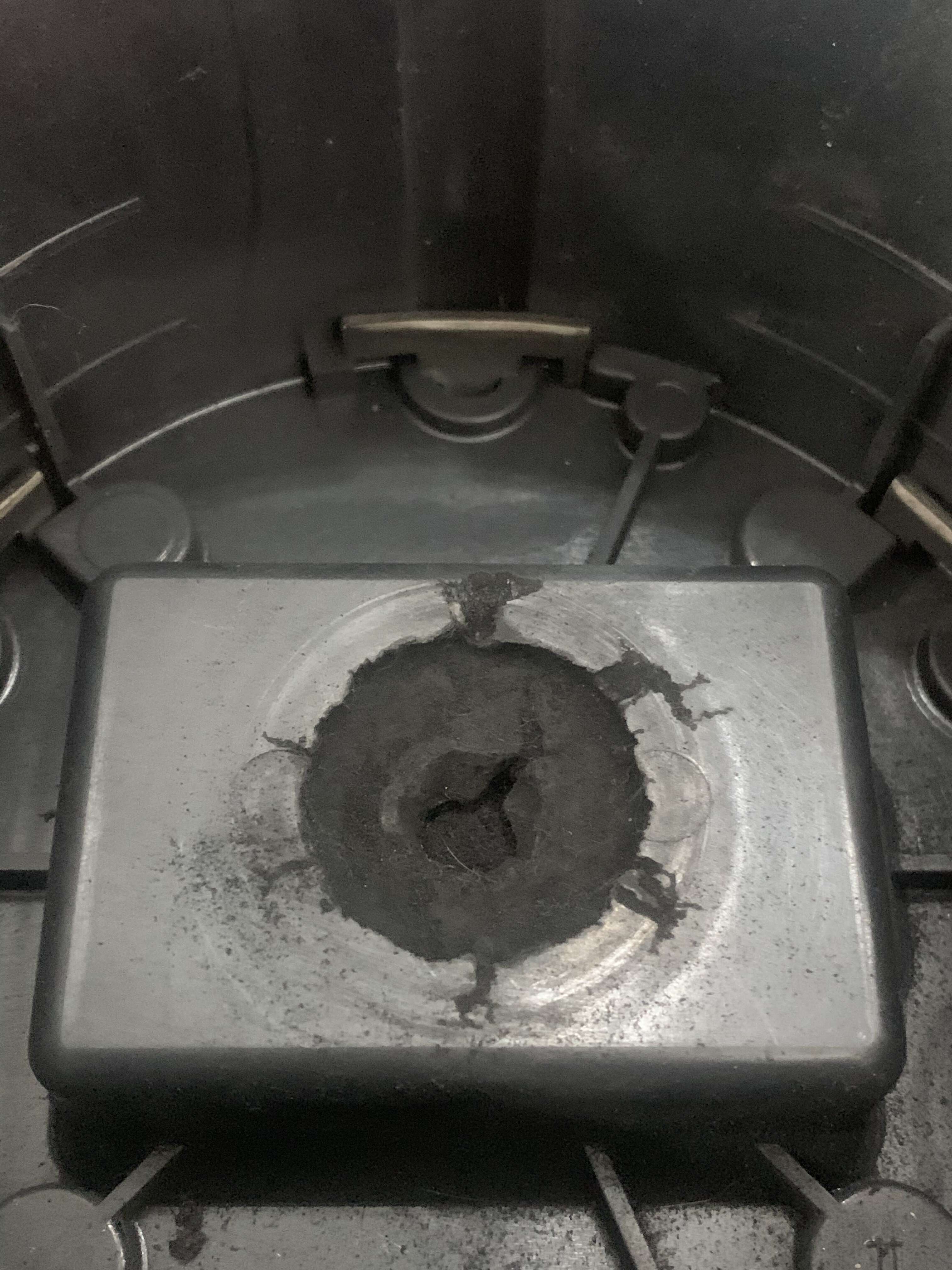

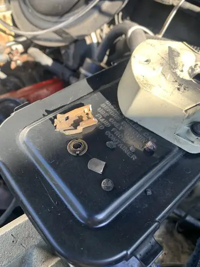

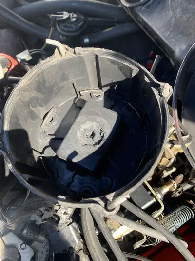

That makes sense. This is what I found when I pulled the HEI module. What is all this shrapnel from and what should I replace?

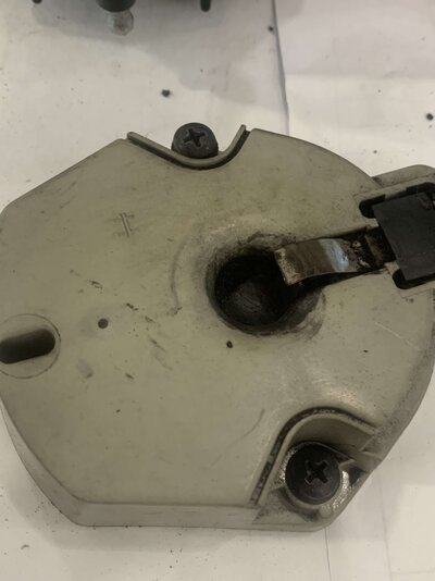

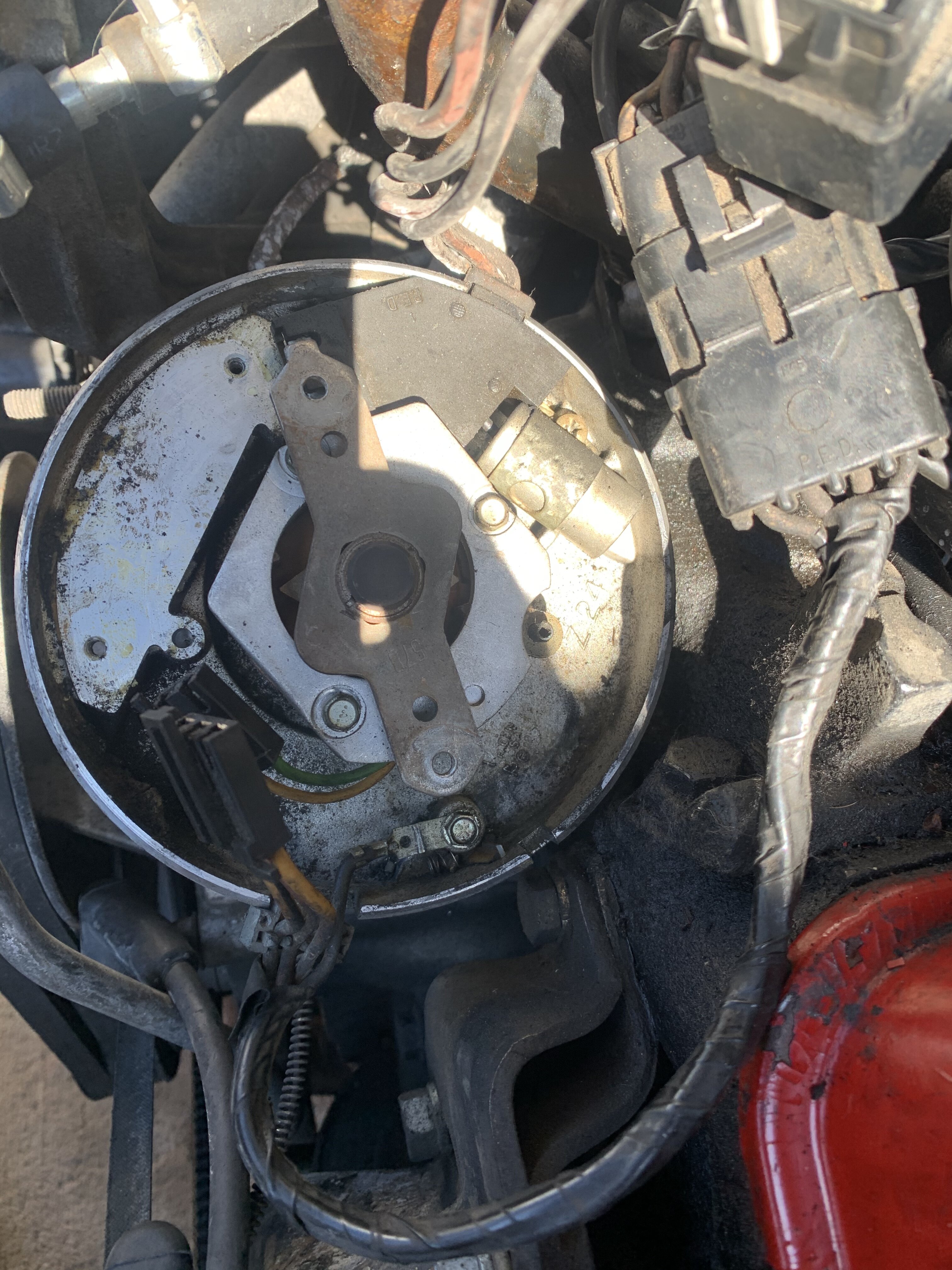

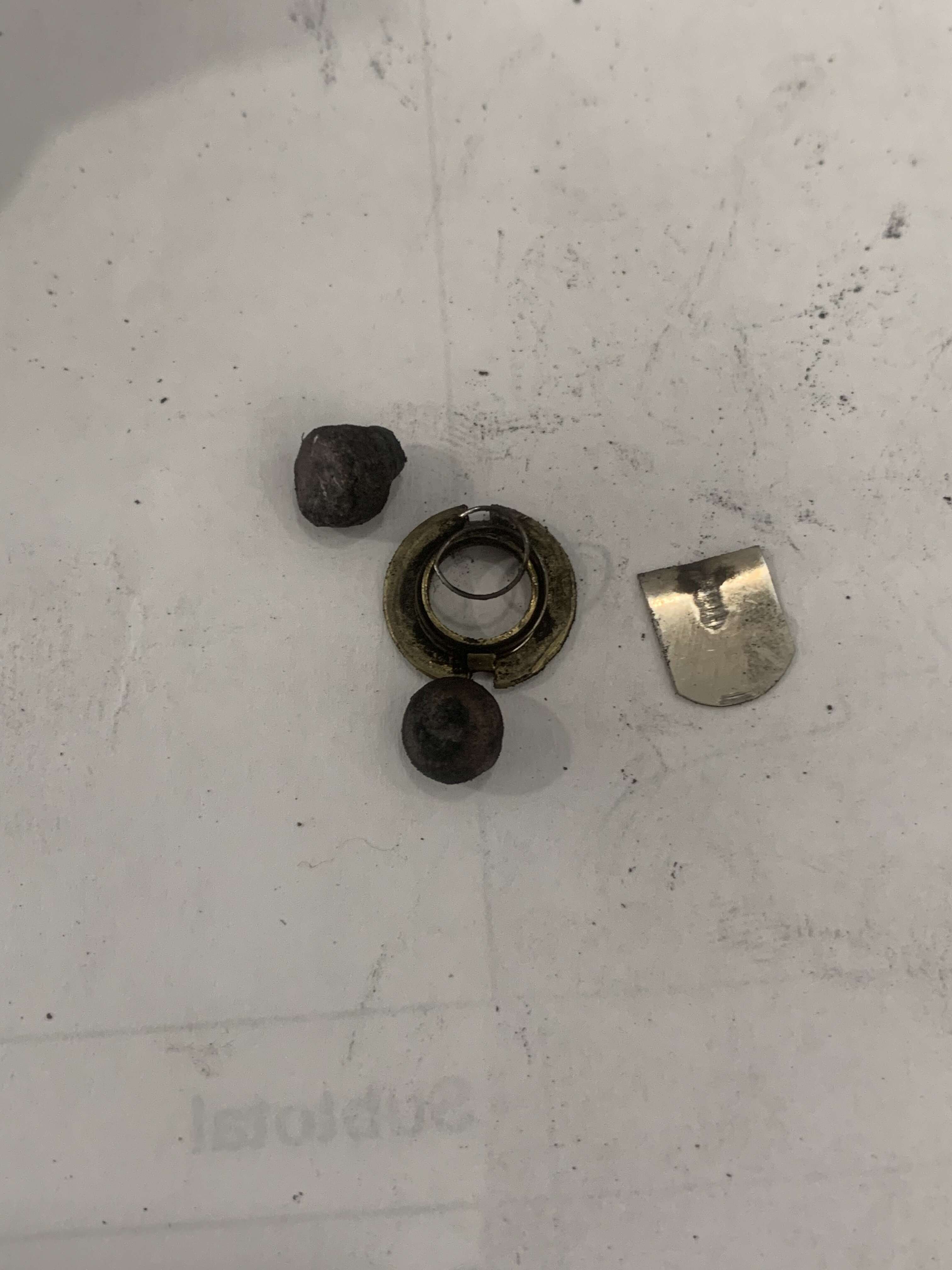

This is what’s left of the brush, rotor and cap. The is brush is literally dust. How did it even run lol. Would it be cheaper to just get a whole new distributor or parts? I’m a little apprehensive about installing a new distributor. Any help is appreciated

At a minumum you are going to need to replace the rotor, cap, and bushing. Looks like someone installed thd bushing wrong. Also better clean all that carbon dust out of the distributor to prevent shorts. Be sure to use the correct heat sink compound on the module, just a little.

I’ve put almost 15,000 miles on it since I got it. Crazy how that brush turned to dust.

Just a thin smear of that white heat sink compound, NOTHING ELSE! Make sure to cover the whole metal surface of the module.
I don't know if you can buy remanufactured ccc Buick 3.8 distributors, but I would try to save yours anyhow.
Its amazing that it even ran like that. Probably better inspect the coil for damage while you are at it. Try to get a cap with brass contacts instead of aluminum contacts.

Does a cap and rotor kit come with the brush already in it or do I have to buy that too? And thanks for al your help
