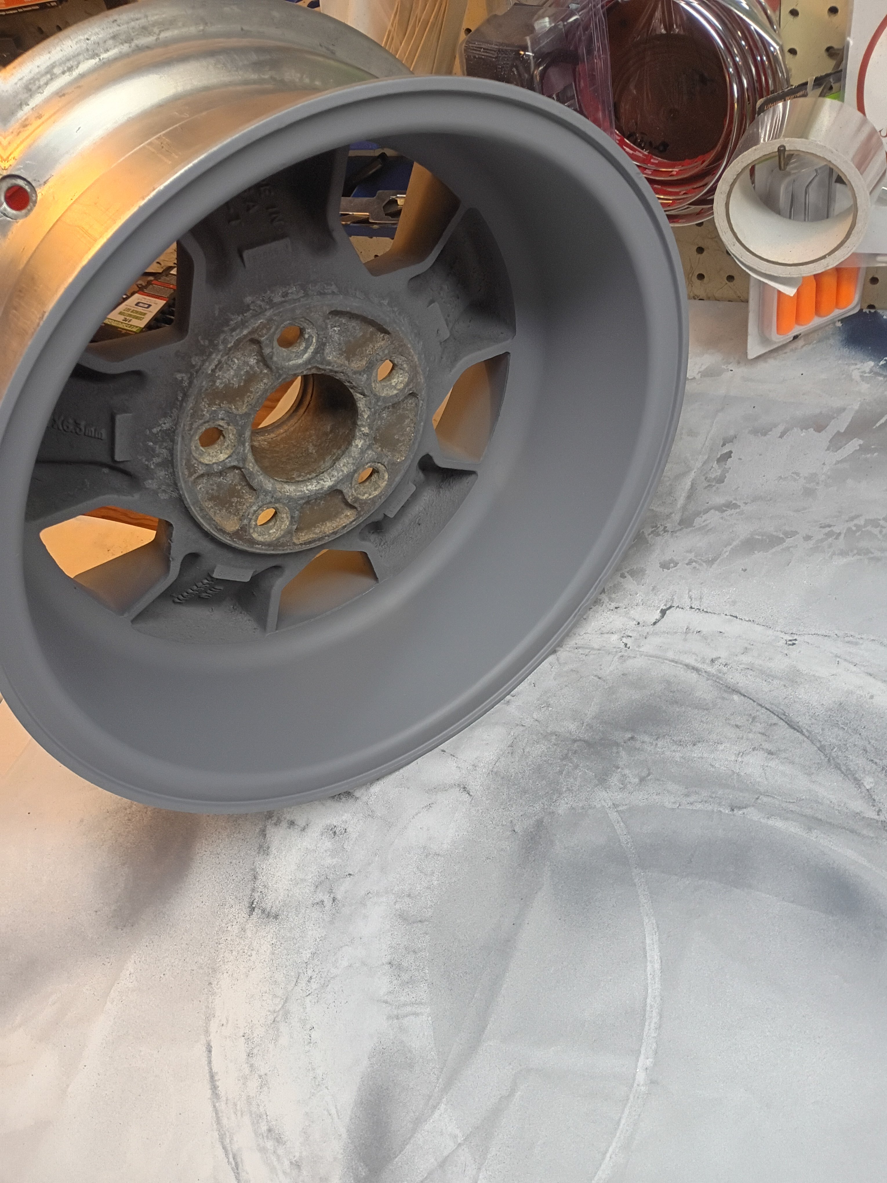

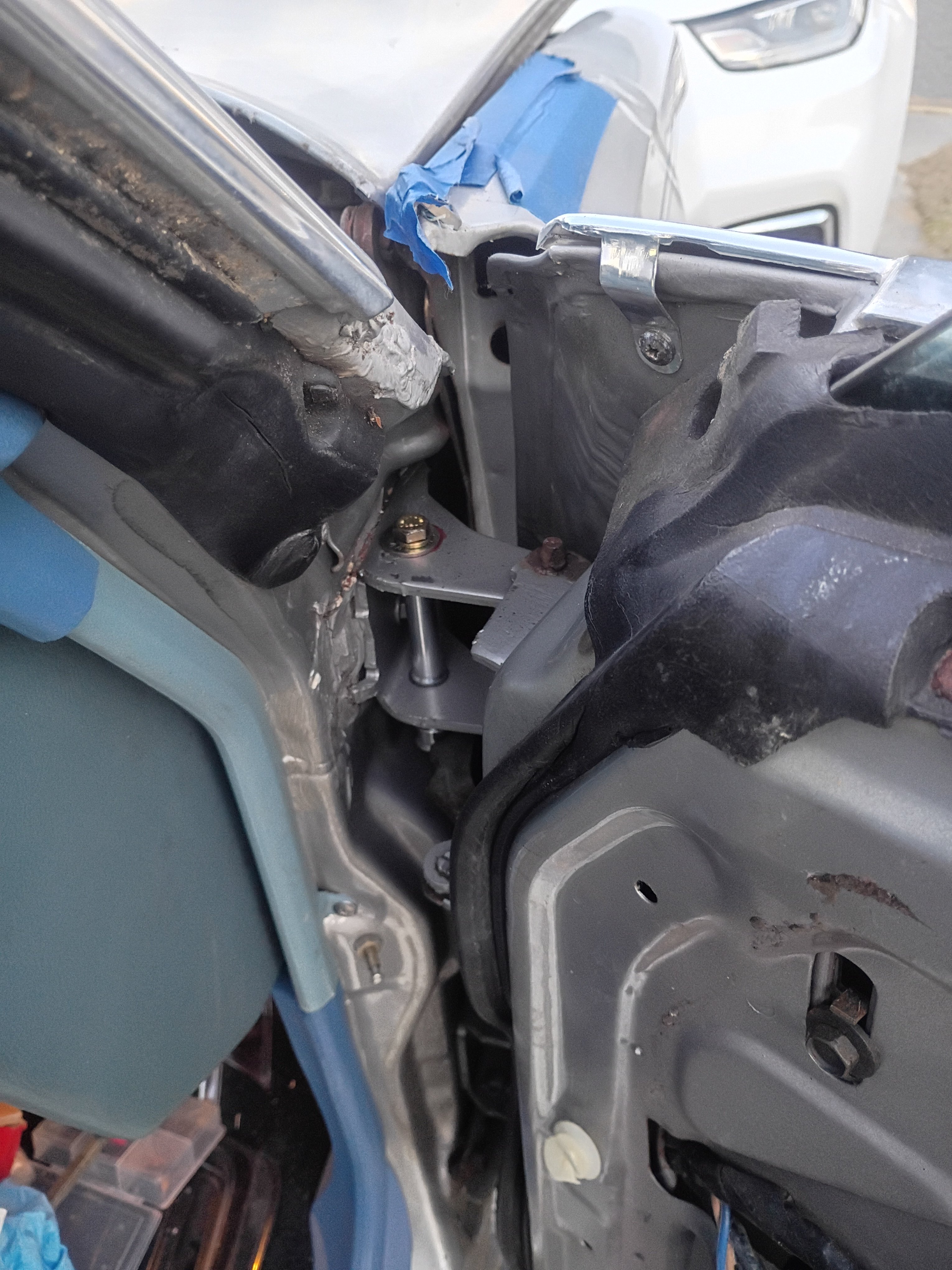

Did the other roller pin on the other side today... The old pin had lost its press fit and roller Head was bent... I hope I get years out of these hinges now. Going to put the door panels on soon after I find out why the power locks are non-functional; I just read there is a relay involved. Also experimenting with refinishing these alloy wheels; had to use 180 grit just to remove the oxide, still pitted, so I applied some sandable primer. Wasn't planning on it, but they will now be painted and probably clear-coated.
Looking good, what color(s) are you thinking of using?
Did the other roller pin on the other side today... The old pin had lost its press fit and roller Head was bent... I hope I get years out of these hinges now. Going to put the door panels on soon after I find out why the power locks are non-functional; I just read there is a relay involved. Also experimenting with refinishing these alloy wheels; had to use 180 grit just to remove the oxide, so they will be painted and probably clear-coated
View attachment 253758View attachment 253759View attachment 253760View attachment 253761
I have a believable chrome for the rim and ridges that were polished (and the inboard side) - I am thinking a powder blue for the part that was originally grey. I'll have to experiment on a test piece to see if the 2k gloss I never used for other project will peel the urethane paint before I gloss the painted wheels. Although we'll all know the wheels don't belong on the car, they'll prolly look pretty good on the car - my wife might even stop cringing when she looks at the car. It is on steelies now without hubcaps.
