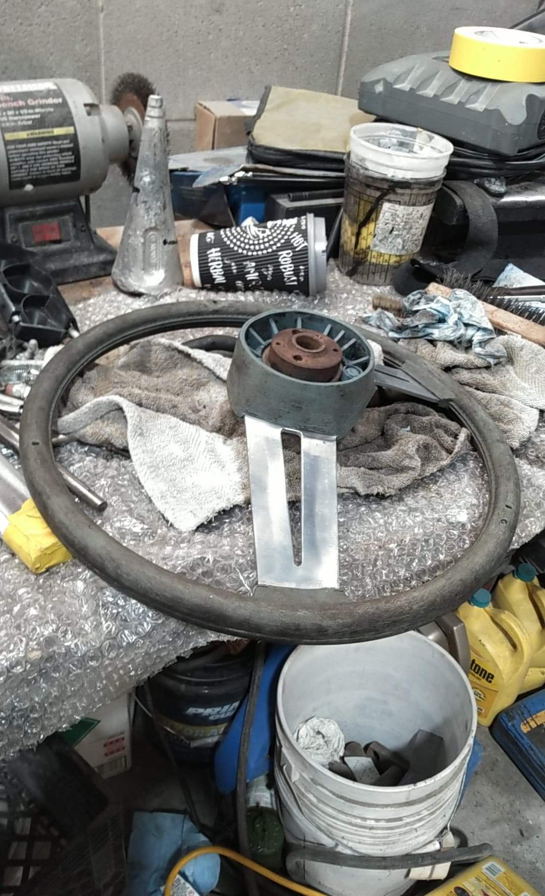

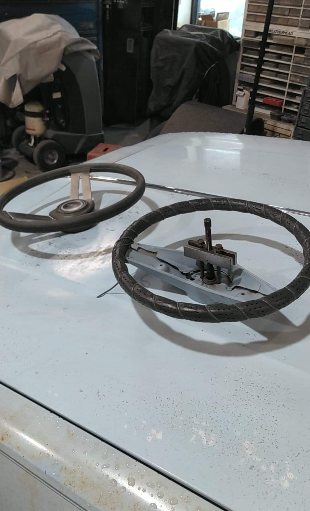

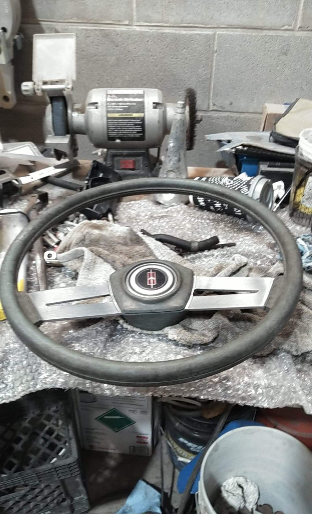

Filled the power steering pump first so that annoying noise is gone. Then I spent way to much time trying to clean up the batwing wheel.
It was from an 81 t-top car that was at my uncle's yard the car was a late model wreck from copart when it went there with low miles unfortunately it sat 20 or 30+ years up there with no tops and the mold stained it pretty badly. You can see from the back it's supposed to be the correct color blue.
First I took it to the detail bae and hit it with purple cleaner and a scrub brush before power washing it. Not much result so I tried wheel acid. Still no luck. Back to my bae lacquer thinner and a paint gun cleaning brush a little more results. Then I lightly went at it with lacquer thinner and a wire brush. Better but not good.
So I moved on. I brought what was left of a theft recovery 84 Monte Carlo SS column and and what I had of an 83 Camaro column with me. It's really just a bucket of parts now.

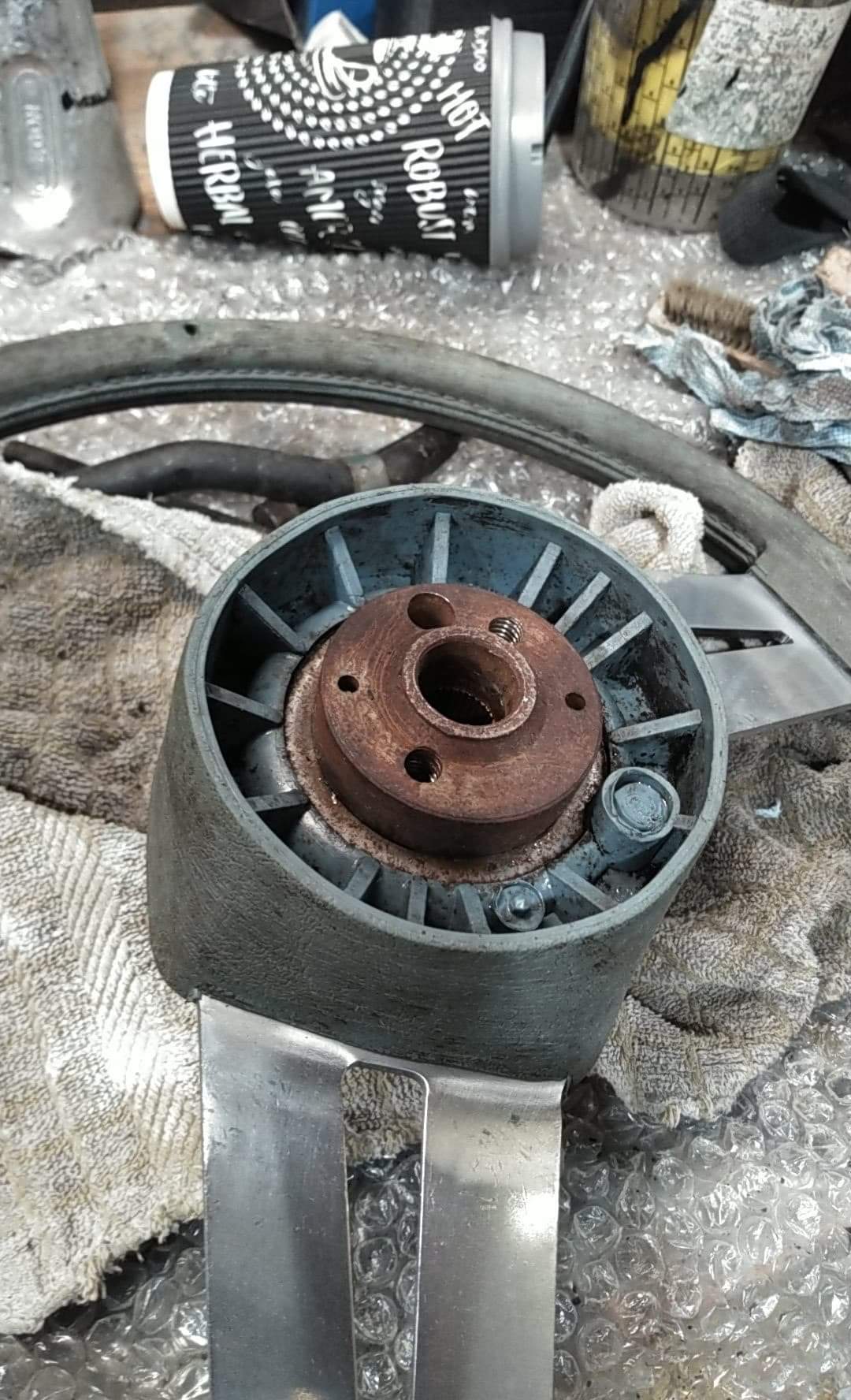

I wet on to removing the old wheel that's falling apart. In the beginning of this build many years ago I redid this wheel filling the cracks with panel bond. If anyone is wondering the panel bond held up but the wheel was just to far gone and continuing to crack.

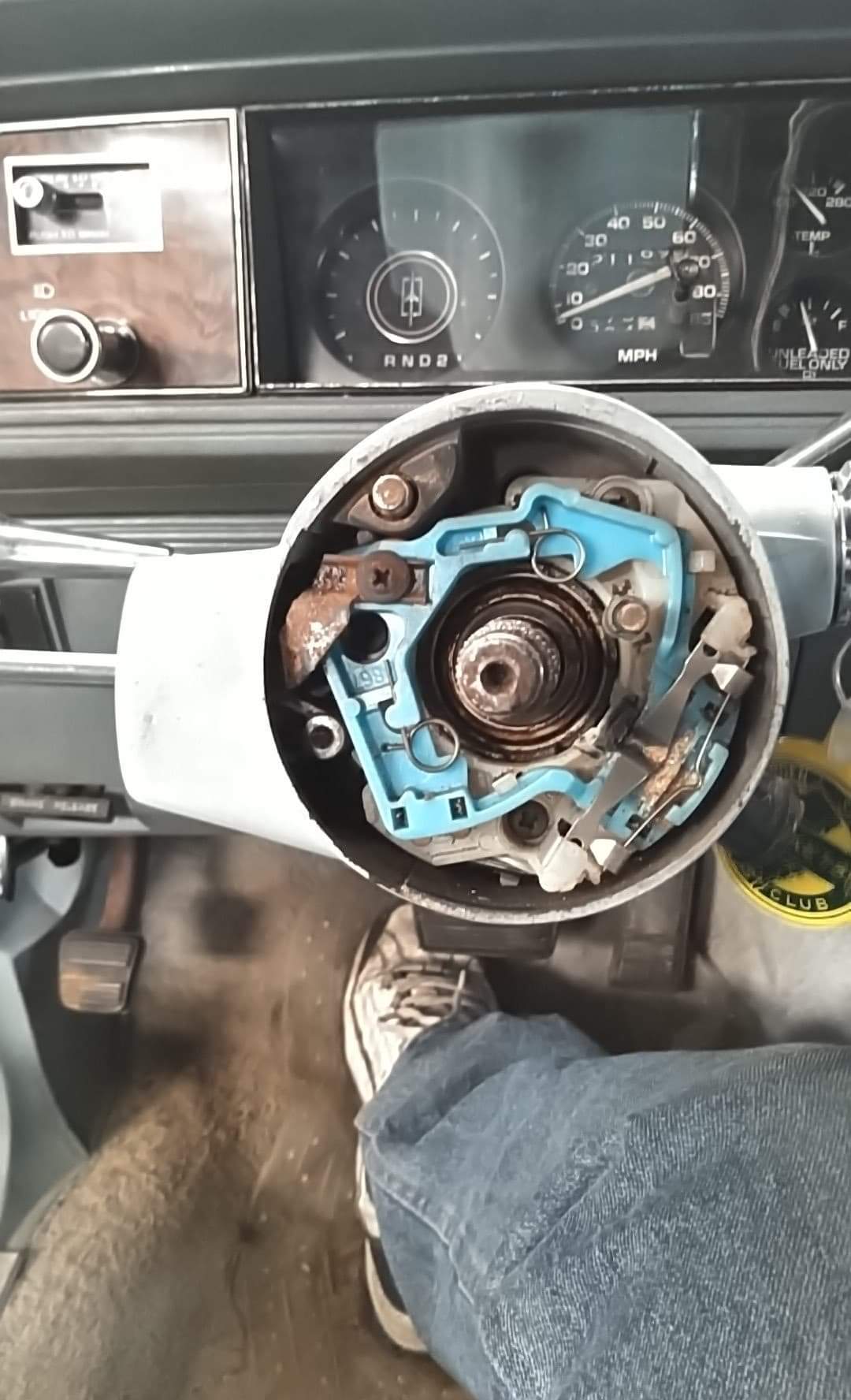

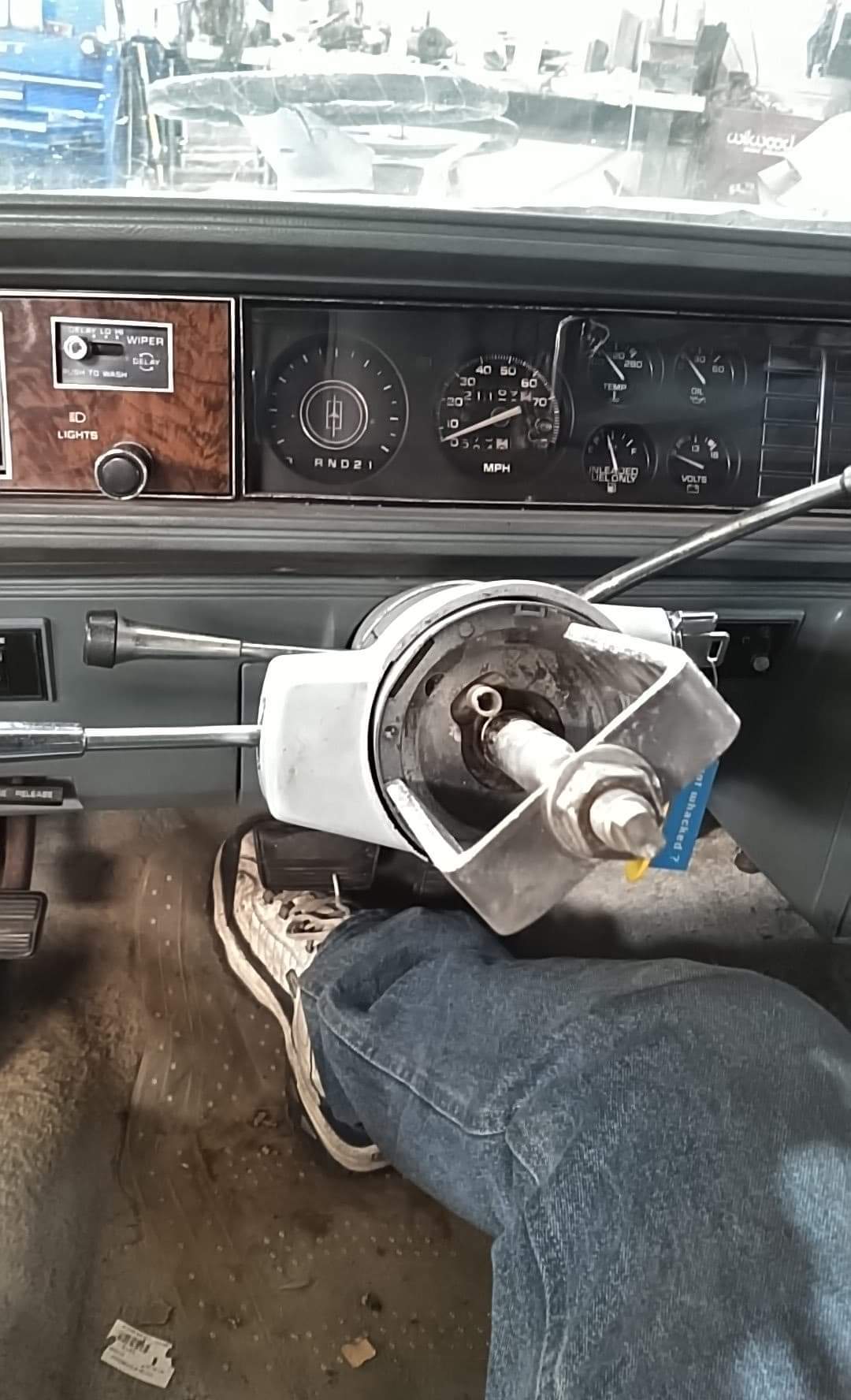

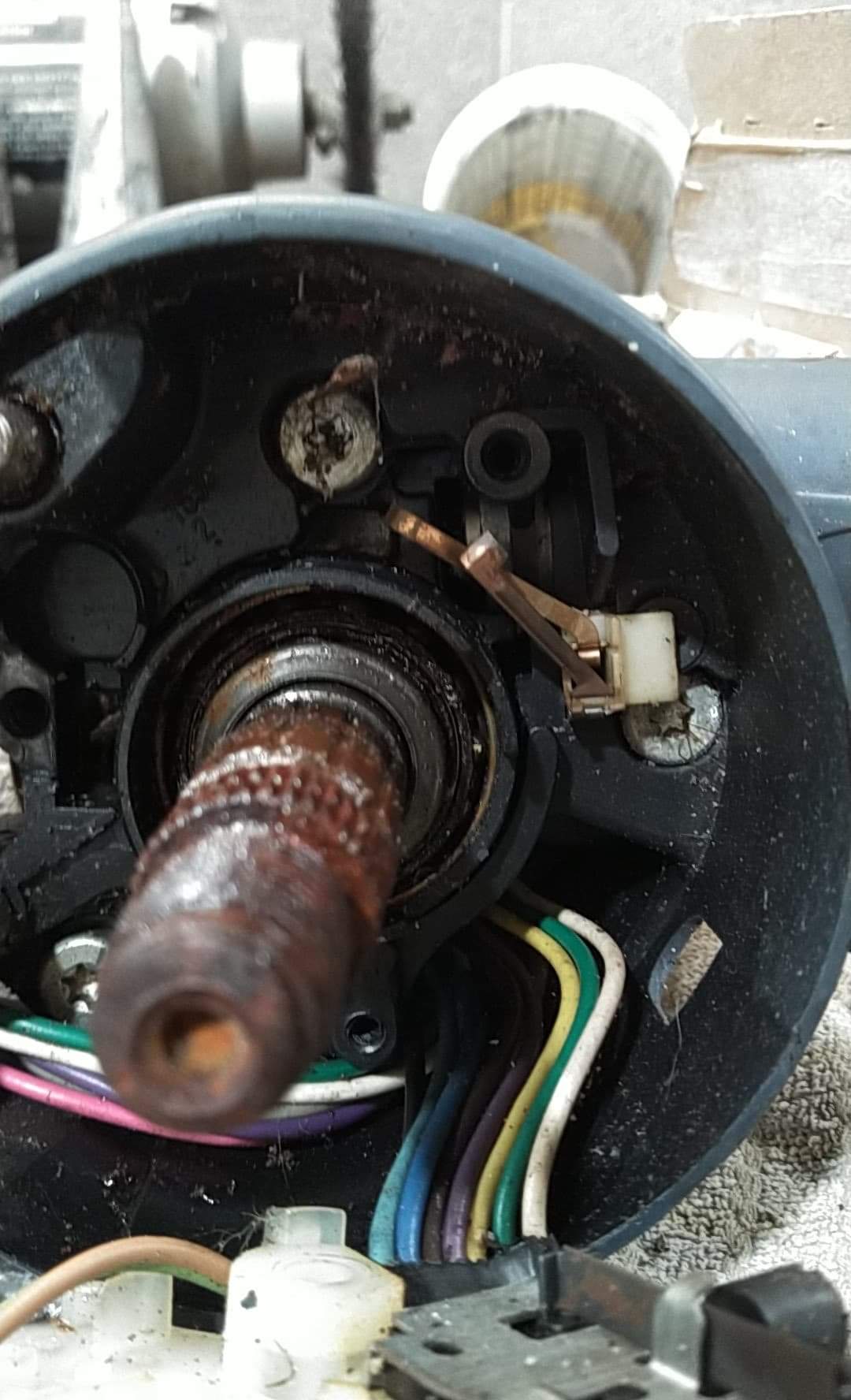

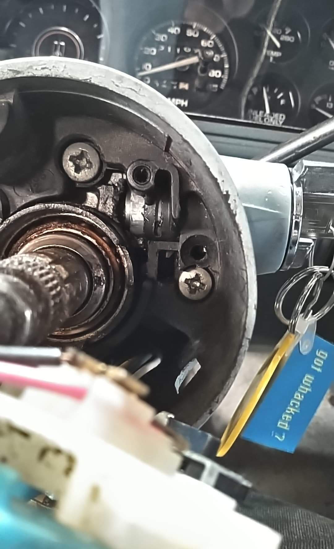

Then I dug into the column itself
and came to find I never installed the blinker contact pice that locks in under the lock cylinder or the spring or the lock cylinder bolt

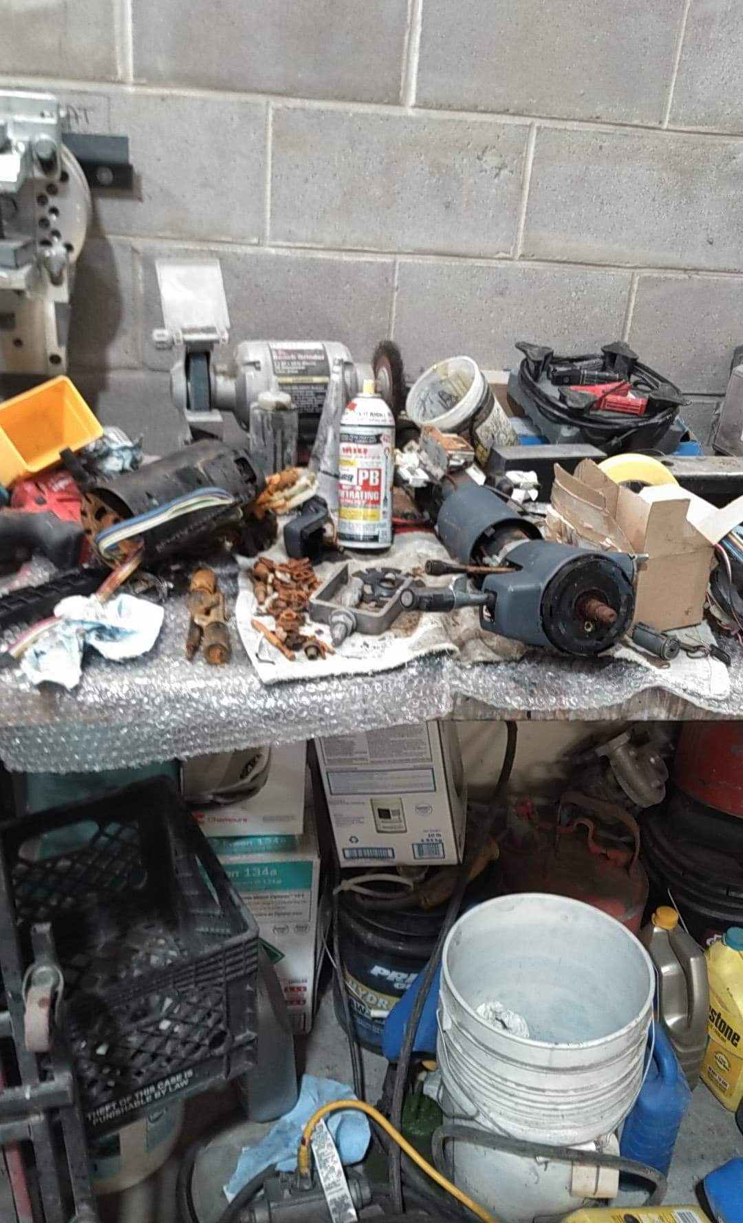

obviously I needed parts and the Camaro pretty much already gave up the coast so I went into the theft recovery Monte column and there they were
some careful dissecting and I had my missing parts I used to do these columns all the time years ago buying a theft recovery g body was a good source of income if you could change locks and the top of the steering column you had a good car to sell. That's what my last Monte Carlo SS was but I changed the hole column in that one that's where these parts came from and there's not many changes in the Saginaw design car to car or even different car companies take Jeep for example same shot! I got you a picture of the parts out too

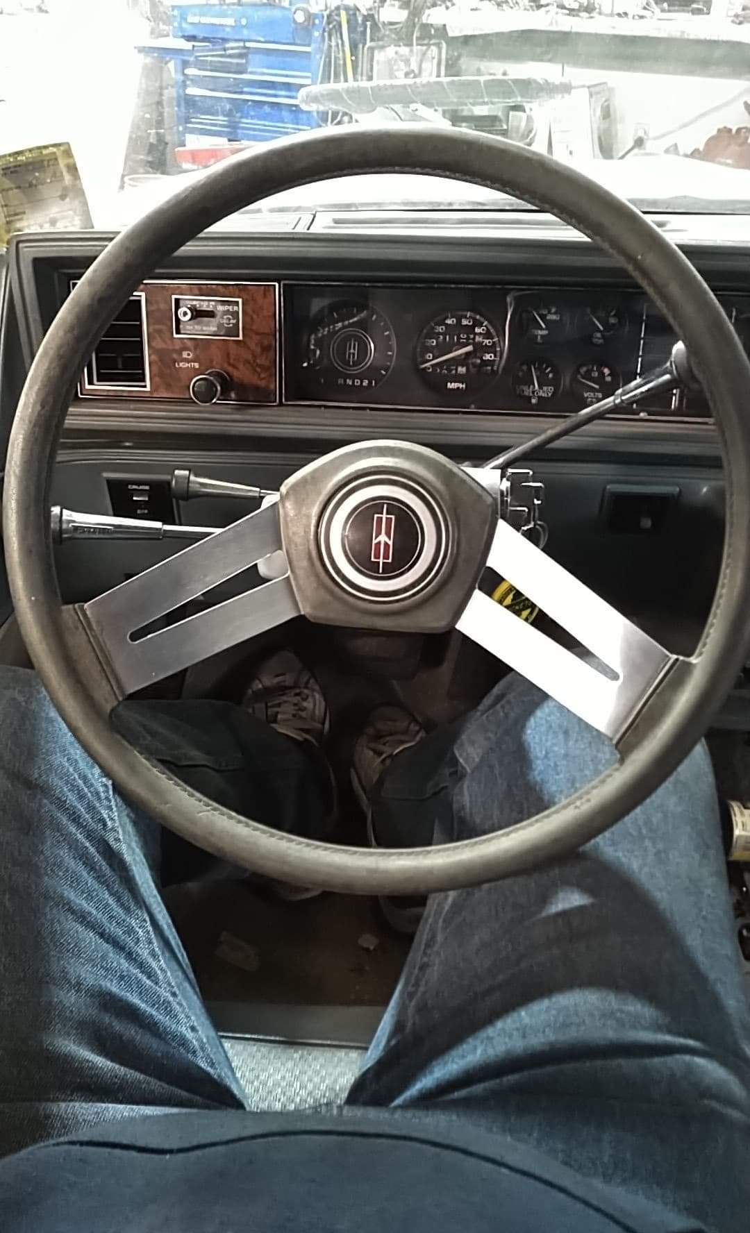

I then very carefully put it back together. I was missing the horn contact pin for the batwing so I 🤔 umm..... Borrowed! The one from my bosses 77 holiday 88.. I'll order him one no harm no foul. Maybe 🤔. All back together I did some testing

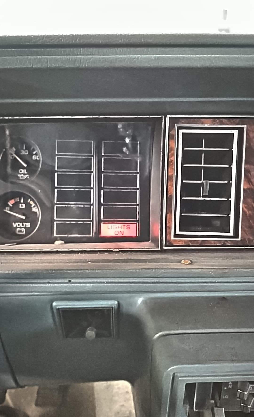

even dirty it looks mucho better imo and not only does it have blinkers now the cornering lights work!
and it has an annoying chime to let you know you left your lights on and a warning light on the dashboard that works

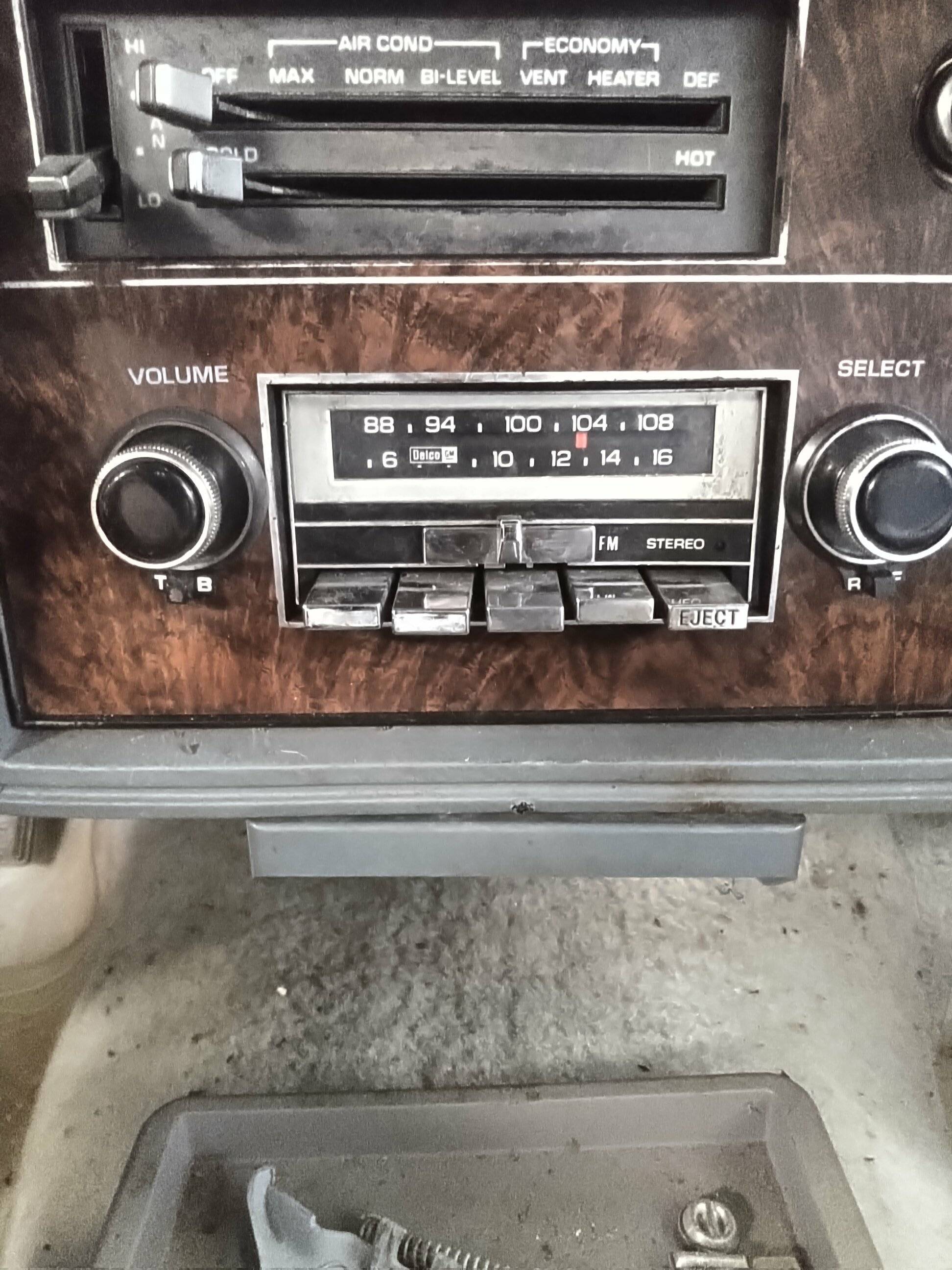

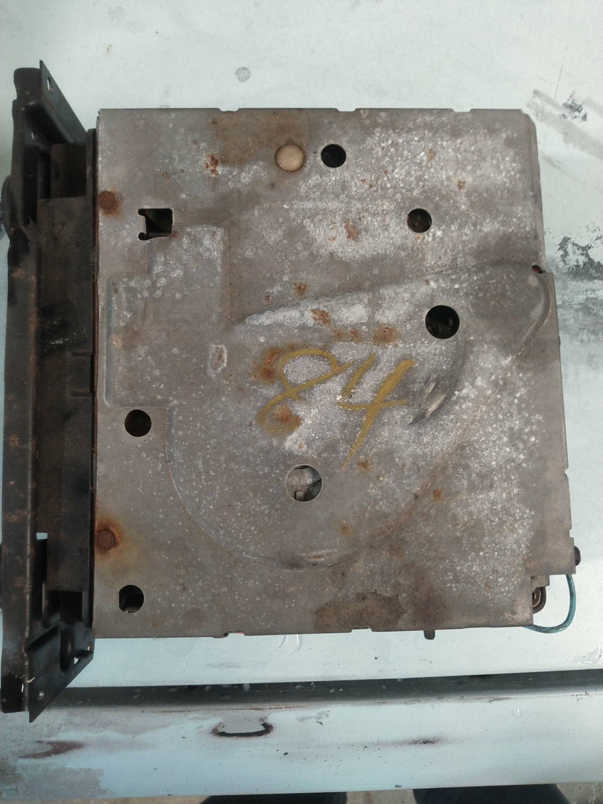

I wanted to revisit radio but I was hungry so I just took off last weekends vicegrips and reinstalled it with the nicer bezel and knobs I picked out last week.

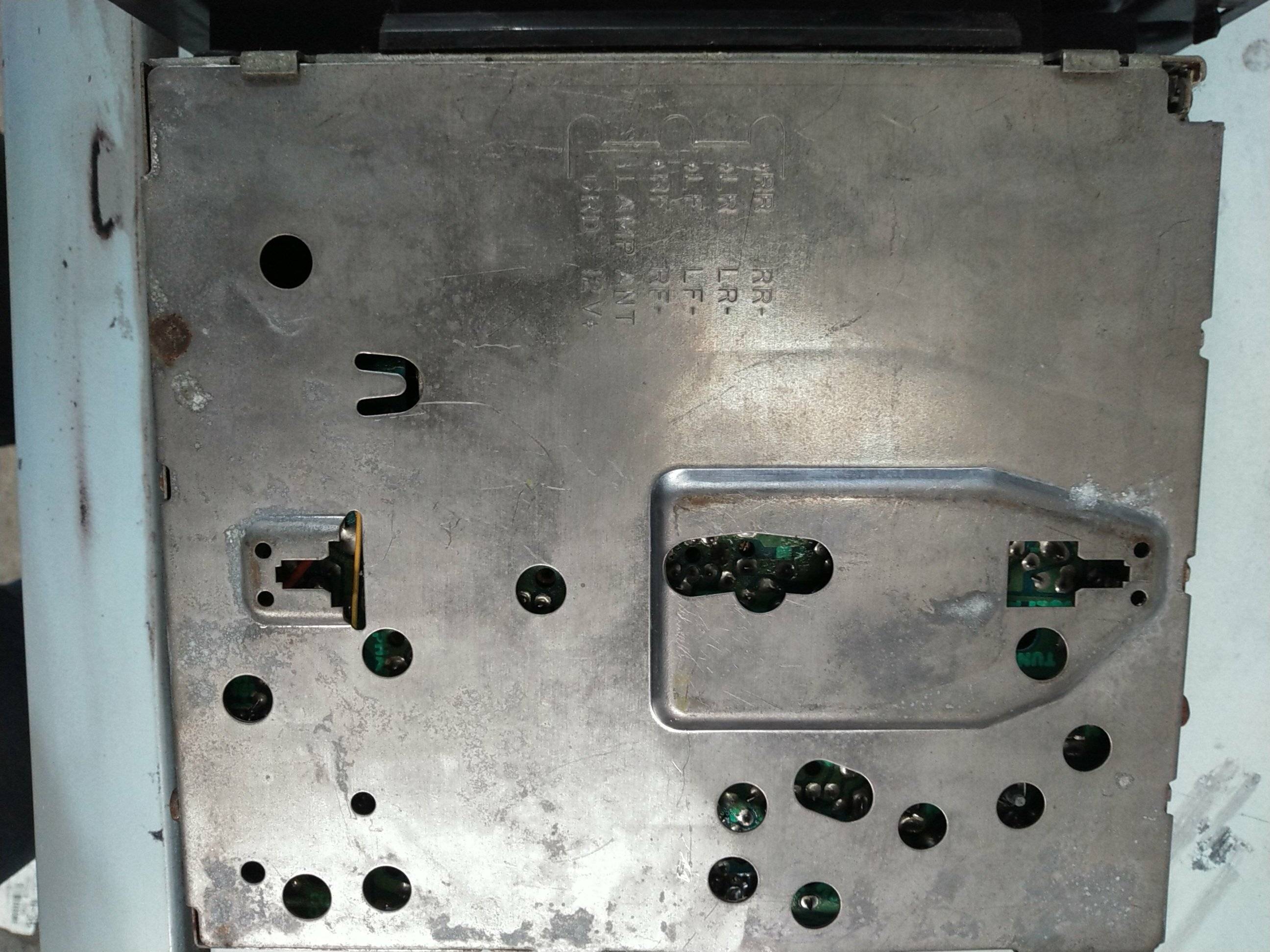

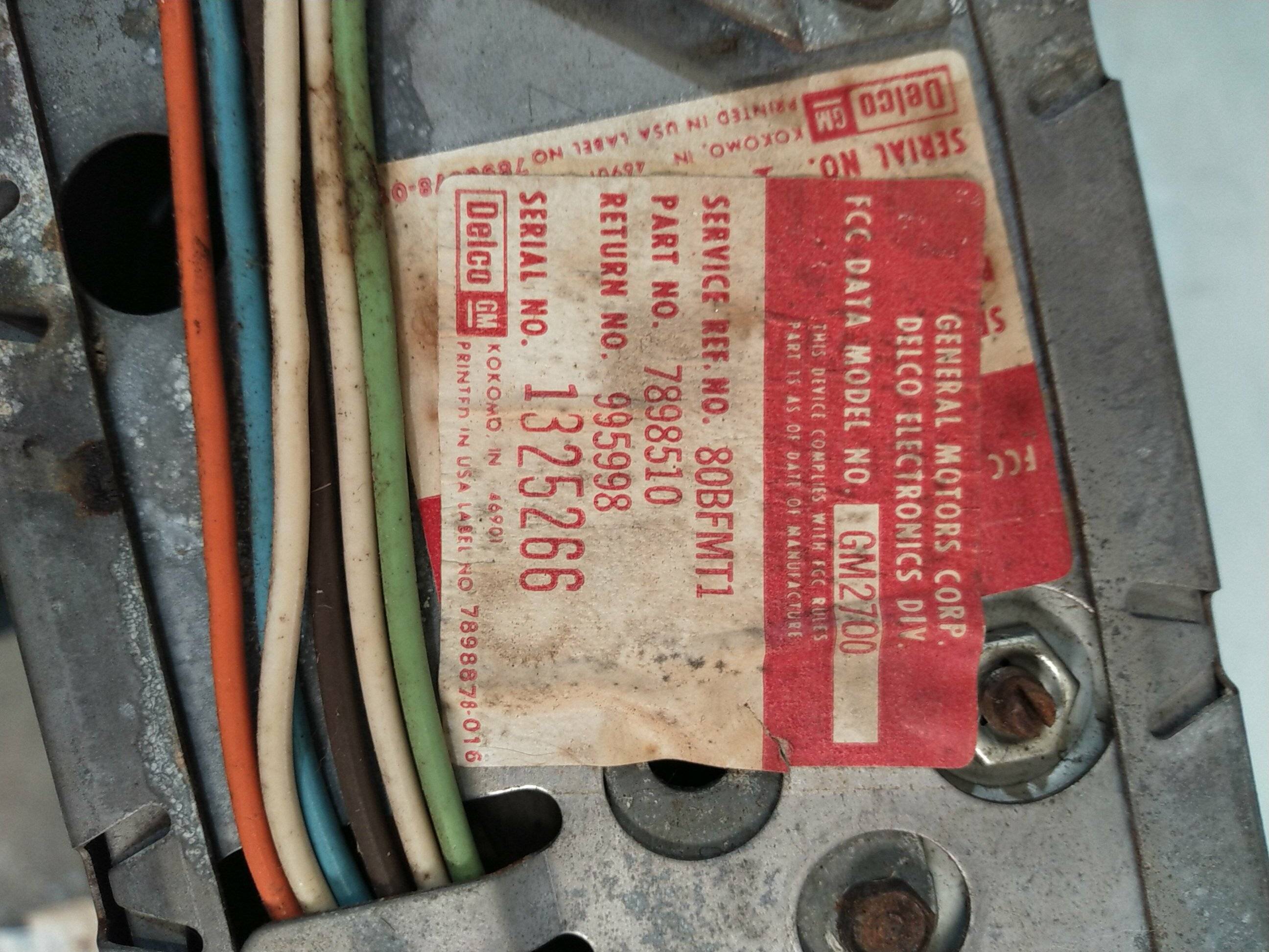

i tried it but no tunes. It's broke. While I had it out I took some pictures of it to try and get parts for it online. I don't know how I'll make out with that but it's worth a shot because it doesn't work now and I want to stay with a stock look

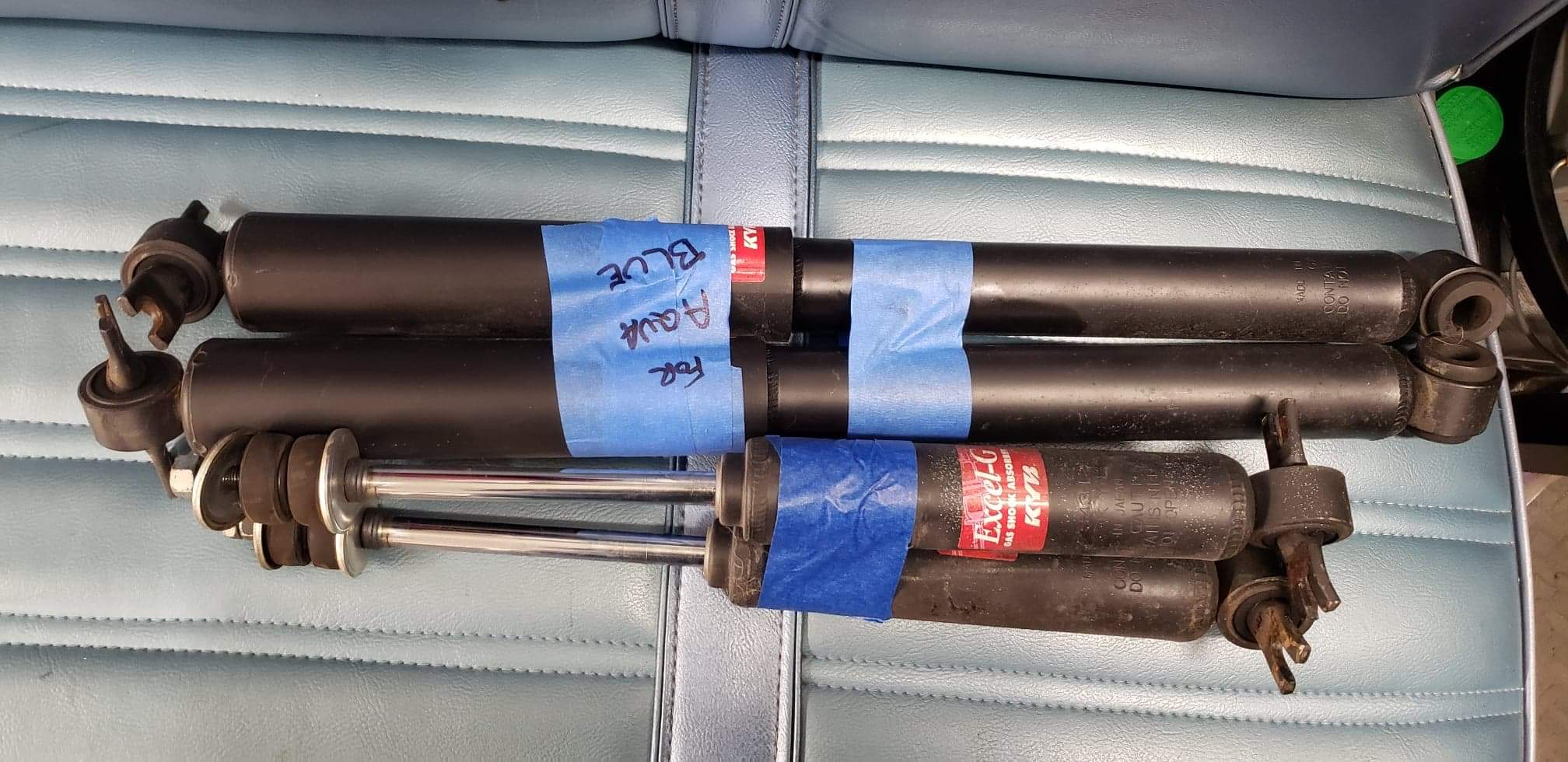

Tomorrow is another day I've got to go back because I left the car inside and it can't be there Monday morning. I'll probably do something while I'm there tomorrow I just don't know what maybe I'll shoot to my brother's house in the morning he's got a new used set of kyb shocks off one of his cars I'm going to put on here he likes cars to have the original air in the tires and I want this one to drive nice. Maybe he want the shot original ones that are still on this car lol

Filled the power steering pump first so that annoying noise is gone. Then I spent way to much time trying to clean up the batwing wheel. View attachment 194185It was from an 81 t-top car that was at my uncle's yard the car was a late model wreck from copart when it went there with low miles unfortunately it sat 20 or 30+ years up there with no tops and the mold stained it pretty badly. You can see from the back it's supposed to be the correct color blue.View attachment 194186 First I took it to the detail bae and hit it with purple cleaner and a scrub brush before power washing it. Not much result so I tried wheel acid. Still no luck. Back to my bae lacquer thinner and a paint gun cleaning brush a little more results. Then I lightly went at it with lacquer thinner and a wire brush. Better but not good.View attachment 194187So I moved on. I brought what was left of a theft recovery 84 Monte Carlo SS column and and what I had of an 83 Camaro column with me. It's really just a bucket of parts now.View attachment 194189 I wet on to removing the old wheel that's falling apart. In the beginning of this build many years ago I redid this wheel filling the cracks with panel bond. If anyone is wondering the panel bond held up but the wheel was just to far gone and continuing to crack.View attachment 194188
Then I dug into the column itself View attachment 194190View attachment 194191and came to find I never installed the blinker contact pice that locks in under the lock cylinder or the spring or the lock cylinder bolt
View attachment 194192View attachment 194193obviously I needed parts and the Camaro pretty much already gave up the coast so I went into the theft recovery Monte column and there they were View attachment 194194some careful dissecting and I had my missing parts I used to do these columns all the time years ago buying a theft recovery g body was a good source of income if you could change locks and the top of the steering column you had a good car to sell. That's what my last Monte Carlo SS was but I changed the hole column in that one that's where these parts came from and there's not many changes in the Saginaw design car to car or even different car companies take Jeep for example same shot! I got you a picture of the parts out tooView attachment 194195 I then very carefully put it back together. I was missing the horn contact pin for the batwing so I 🤔 umm..... Borrowed! The one from my bosses 77 holiday 88.. I'll order him one no harm no foul. Maybe 🤔. All back together I did some testingView attachment 194197even dirty it looks mucho better imo and not only does it have blinkers now the cornering lights work!View attachment 194196and it has an annoying chime to let you know you left your lights on and a warning light on the dashboard that worksView attachment 194198I wanted to revisit radio but I was hungry so I just took off last weekends vicegrips and reinstalled it with the nicer bezel and knobs I picked out last week.View attachment 194184i tried it but no tunes. It's broke. While I had it out I took some pictures of it to try and get parts for it online. I don't know how I'll make out with that but it's worth a shot because it doesn't work now and I want to stay with a stock lookView attachment 194181View attachment 194182View attachment 194183
Tomorrow is another day I've got to go back because I left the car inside and it can't be there Monday morning. I'll probably do something while I'm there tomorrow I just don't know what maybe I'll shoot to my brother's house in the morning he's got a new used set of kyb shocks off one of his cars I'm going to put on here he likes cars to have the original air in the tires and I want this one to drive nice. Maybe he want the shot original ones that are still on this car lolView attachment 194199
Nice work Eric.
I’ve got 2 factory 1980 Cutlass radios that still work if’n you’re interested. I’m never going to do anything with them, so they might as well go to someone that can use them.
They’re yours for the price of shipping, but they’re fairly heavy so up to you…
