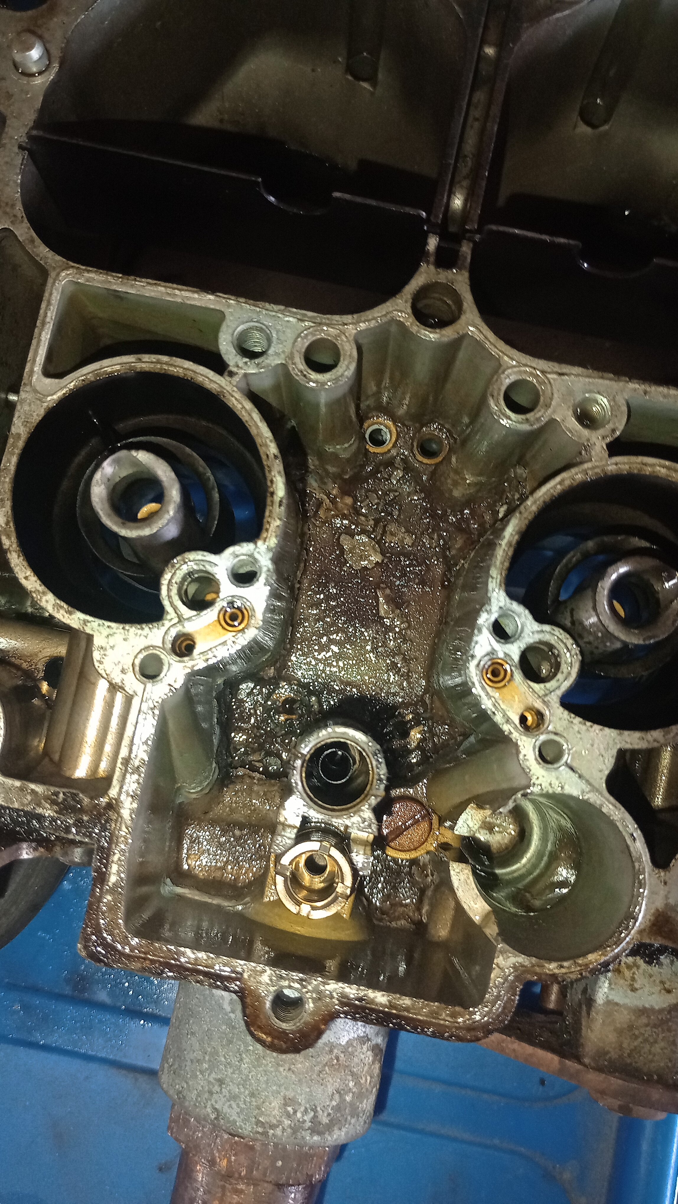

Contact 78delta88 about that Rochester- he'll get you set up.
