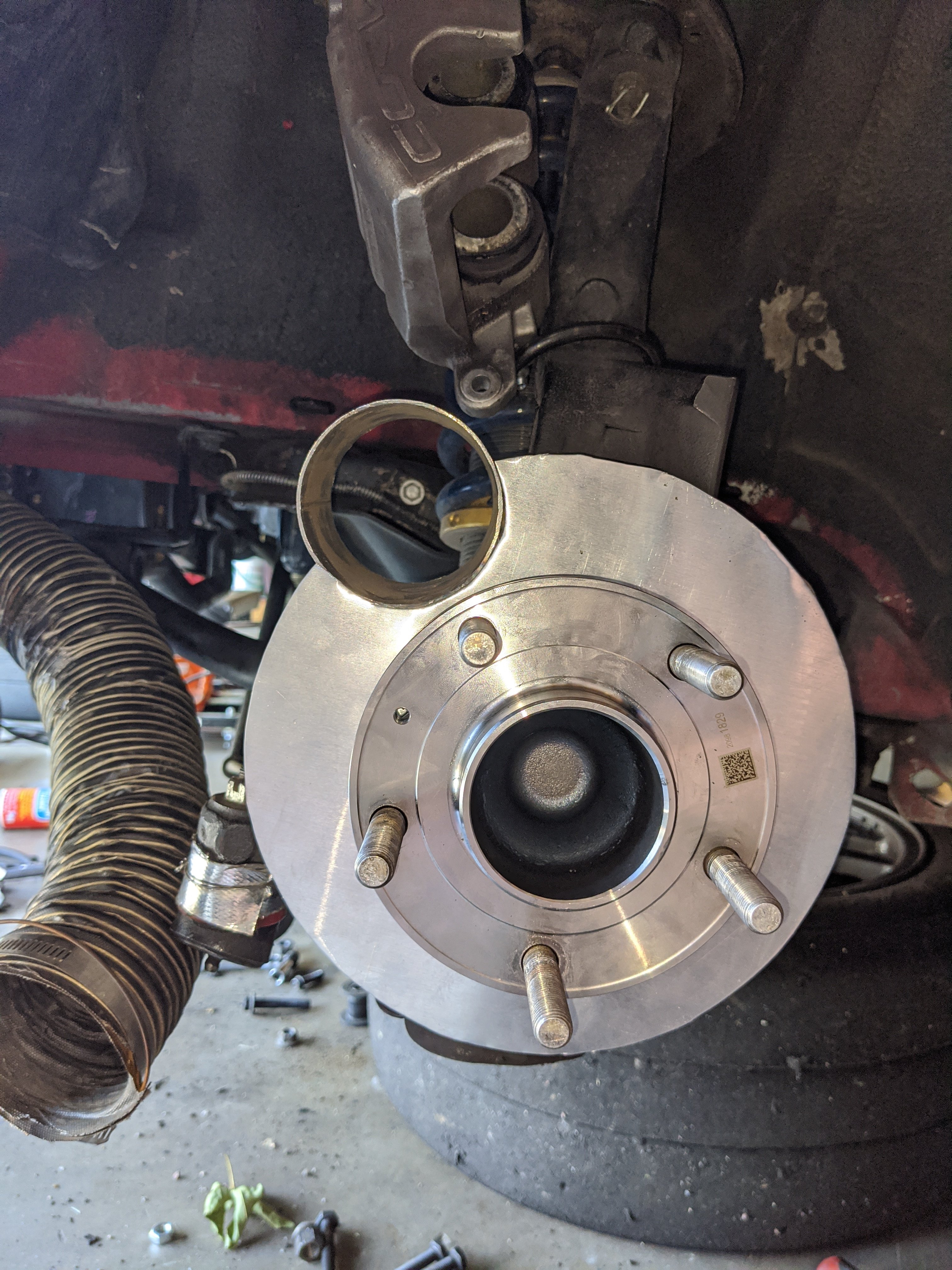

Awesome update! How much caster will you be running with the spc upper arms? Also, what are you thinking for brake cooling ducts? I’d like to possibly shamelessly steal your ideas
Nice optical illusion. I believe that’s one of those new vented rotors.
