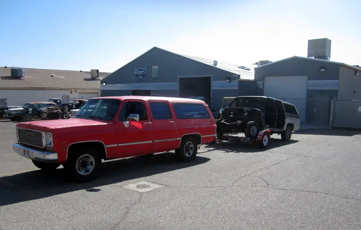

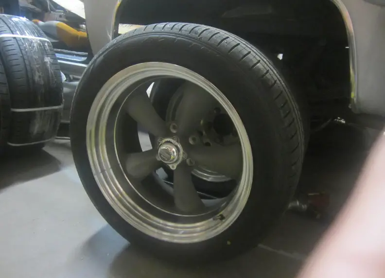

Scoti - Good question. When I first started planning this out it was more $ to drop a 3/4 ton and almost all the wheels I saw within my budget were doofy "off roadie" bling things. I wanted a Pro Touring/ old school flair to the build so nothing in 8 lug appealed to me. Last year a client/ friend stripped a 1/2 ton '91 Suburban to update the body and interior of his lowered and 1/2 ton converted crew cab. He also decided to go with bags and aftermarket arms and all. So I got the rolling 1/2 ton Burby carcass, a frame notch kit, his old stock control arms with Poly bushings installed, short shocks, a set of drop springs and new in the box set of drop spindles all for $400. Doing it this way I can build the 1/2 ton frame while still being able to drive the Burb. I plan to keep the 3/4 rear springs out back tho'. Since I was set up to tow a G-body with another G-body I bought a tow dolly rather than a trailer. Yes it's a bit of a hassle to have to pull out the drive shaft but other than that it's not much tongue weight and is a lighter overall combo, perfect for towing a car with a car. With all this in mind I don't necessarily need the 3/4 ton suspension and the 1/2 ton fit the build design better. Pics are the extra Burb, the wheels and tires I ended up buying and my friend's truck with the drop parts that I now have. Even with taller 22" wheels and tires his truck was decently low for a static drop, but he complained that getting the alignment right was tough. That's why I want to Z the frame a couple inches, so I can keep that in check and maintain decent suspension travel. The way I want to do it will also create more ground clearance under the whole frame.
Make sense if the 1/2 ton swap stuff was cheap & fresh. The 'Z' will definitely help on travel related issues.
I raised/pancaked/notched the front x-member for my dually 1.5". That combined w/the dropped spindles & bags up front will plant the front x-member on the ground @ the same time as the leading edge of the frame rails make contact (29" tall front tire). If you don't cut the frame rails down, no need in going beyond a 2" 'Z' which should help keep the floor mods to a minimum. The way I did mine kept the motor in the stock location so no floor pan clearance related issues.

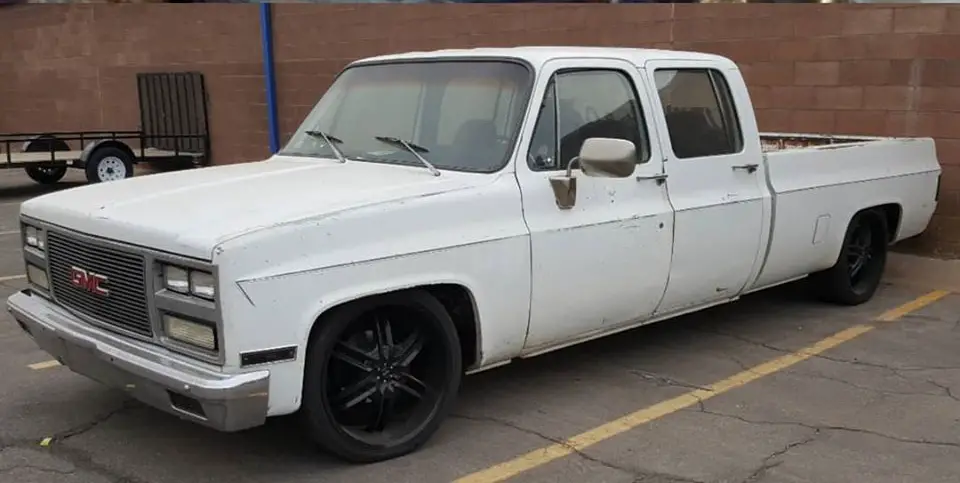

Just did my '99 OBS CC SWB 3/4 ton & left it 8-lug as well. Shorter tow pig w/narrower hips but still 8-lug. No intent of slinging corners though.

The 70s/80s 1/2 ton 2 wheel drive trucks were 5 lug which is what I was after. 4x4s were 6 lug. Not sure what year but the 5 lug was eventually eliminated leaving only 6 and 8 lug options. My 3/4 ton has a full floater rear axle with it's massive hub poking out, so (I think) you're kinda stuck with 8 lug wheel options only.

The 6-lug bolt pattern change on 1/2 ton 2wd trucks was '99 (w/the GMT800 platform introduction). The 3/4 ton rear housings were available in both Semi-Float & Full-Float 8-lug options @ least through 2000 or so.
