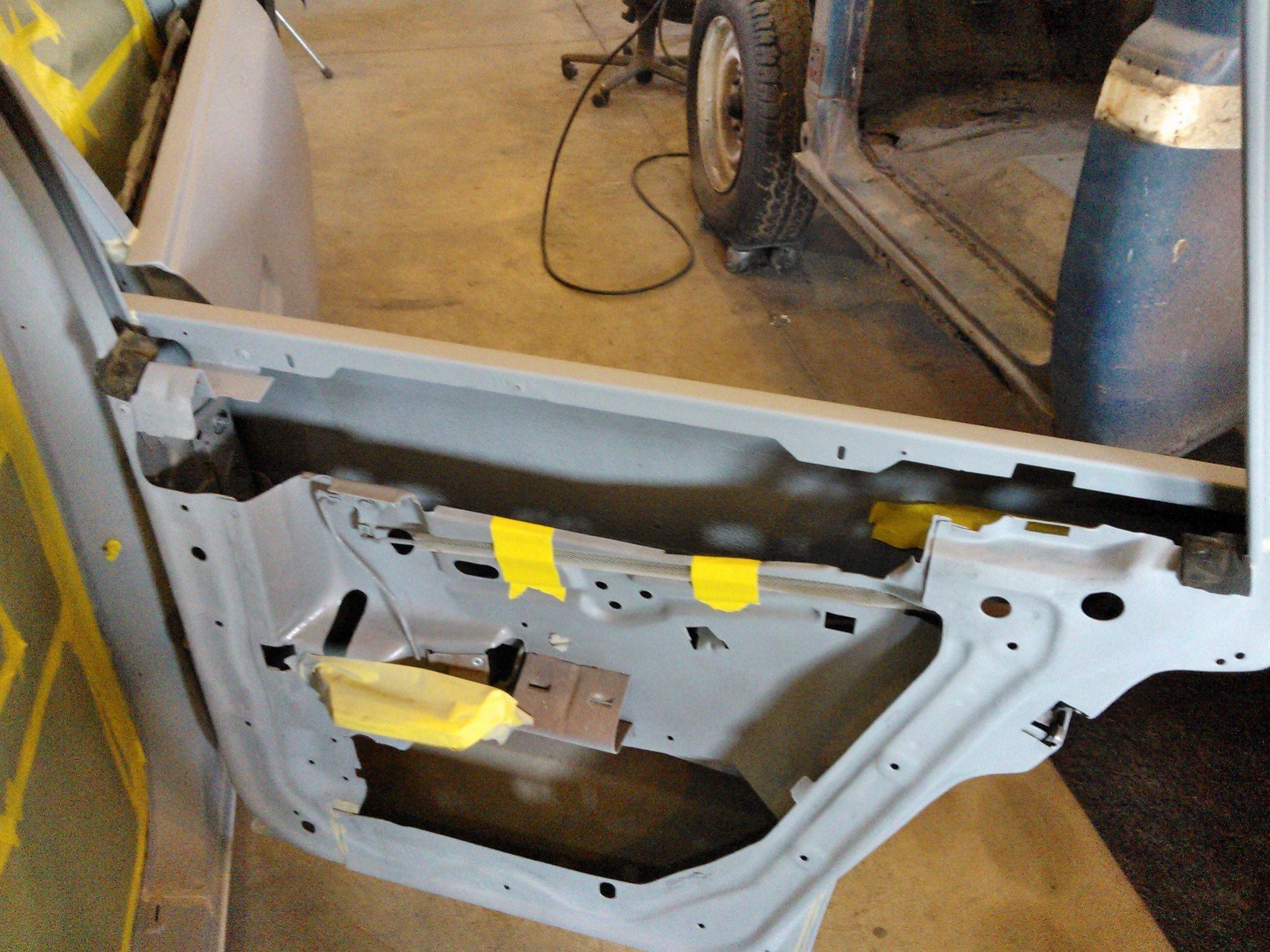

I'll keep looking around for the lock rod, I may find it. I still have to locate my power window regulators and motors for the front doors.
I'm going to start the thread in the wanted section for some of the stuff that I need. I would like to have everything on hand for when the car is in paint. This way I can assemble it over the winter.
As a side note, I ordered the front and rear door weatherstrip, the rear plate pocket, new taillights, and some new black door locks. I mounted the drivers side 3rd gen fbody power mirror. I have to come up with a clean "gasket" for it since the 3 different styles I have aren't exactly right. I may have to drive up to chophead's and have him make me something.
Today I am rebuilding my spare door hinges, new rollers, oversize bushings, fixing the detent arm holes, etc.. I hope to have them all apart and ready to prime and paint tomorrow.
