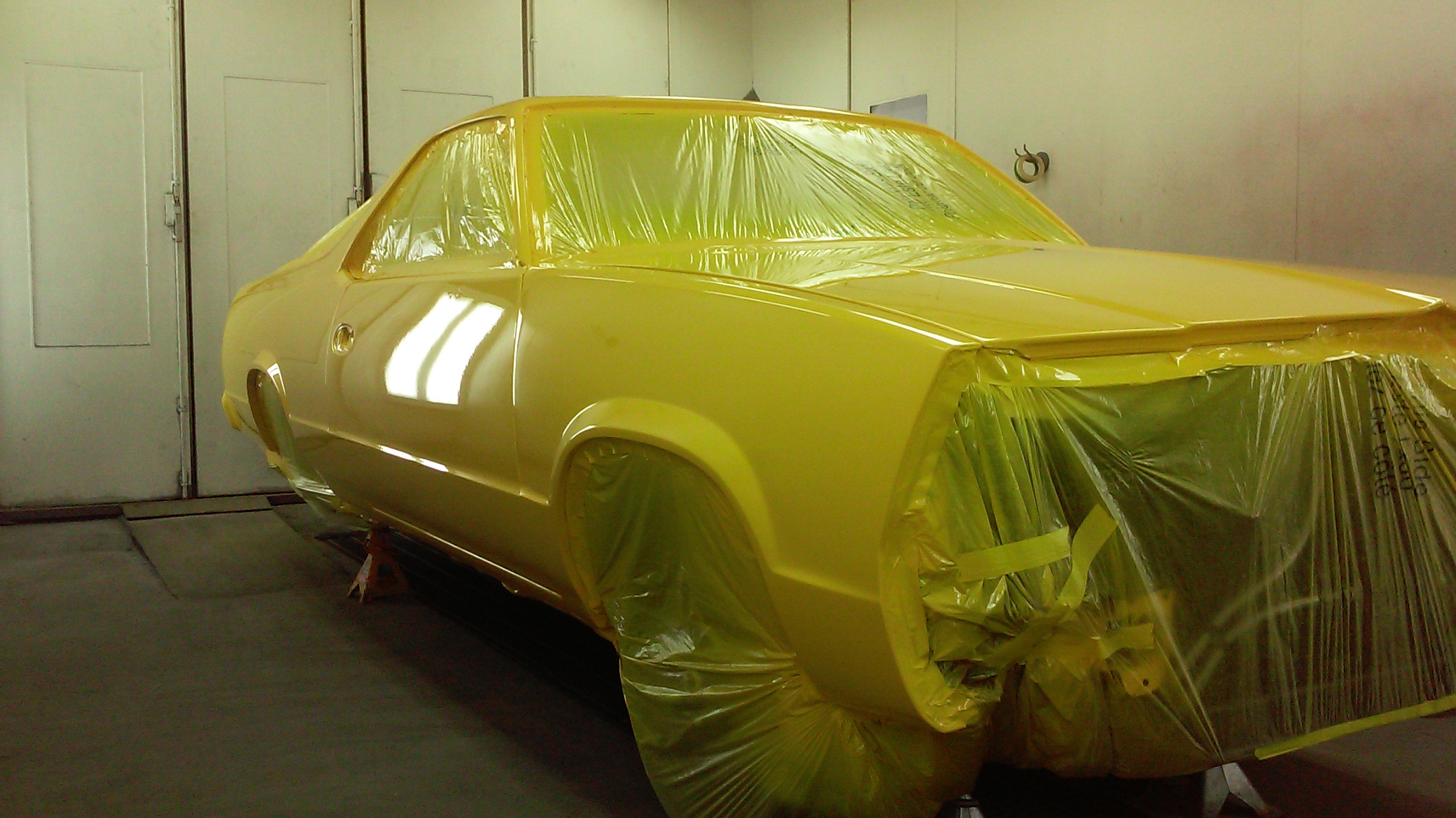

Only G body ever in that one too. It’s only a year old.
same here going on 20 years with this one.
Oh My apologies,i thought you ment the booth was only a year old and your gbody was the only one in there.my mistake.i replied my booth was twenty years old and my gbody's the only one that's been in there.🙂 sorry bout that.I'm close though going on 15 years with the elco.
Getting it all sealed up is a good feeling,milestone for sure.
You were correct. I was just being a little jealous that you’re a lot further along than I am.
