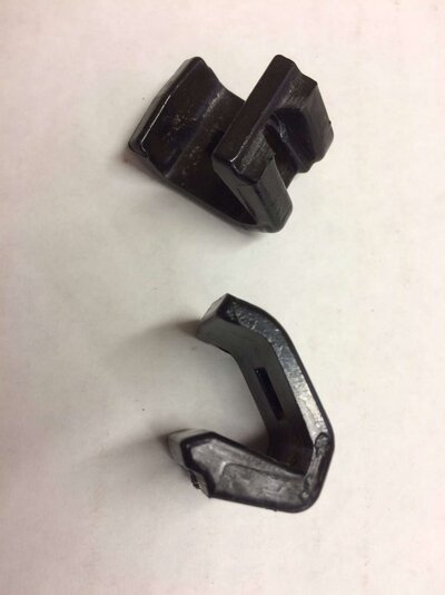

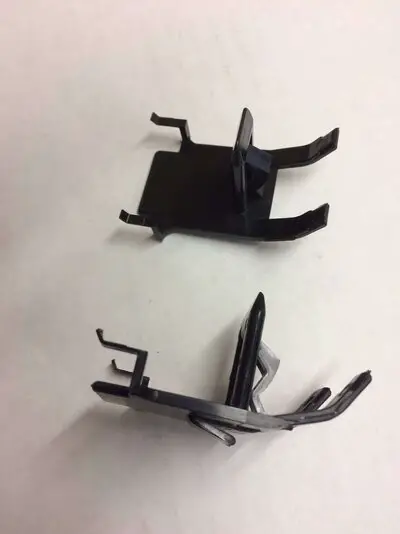

These are the side clips over the quarter windows. They're being worked on currently. There's also these which I believe are available. They help hold in the forward side moldings, and are screwed on.
Btw, I know which metal clips you're talking about. I actually broke one of those. It's a T-shaped spring clip that helps support the headliner shell while you're installing the garnish moldings.
