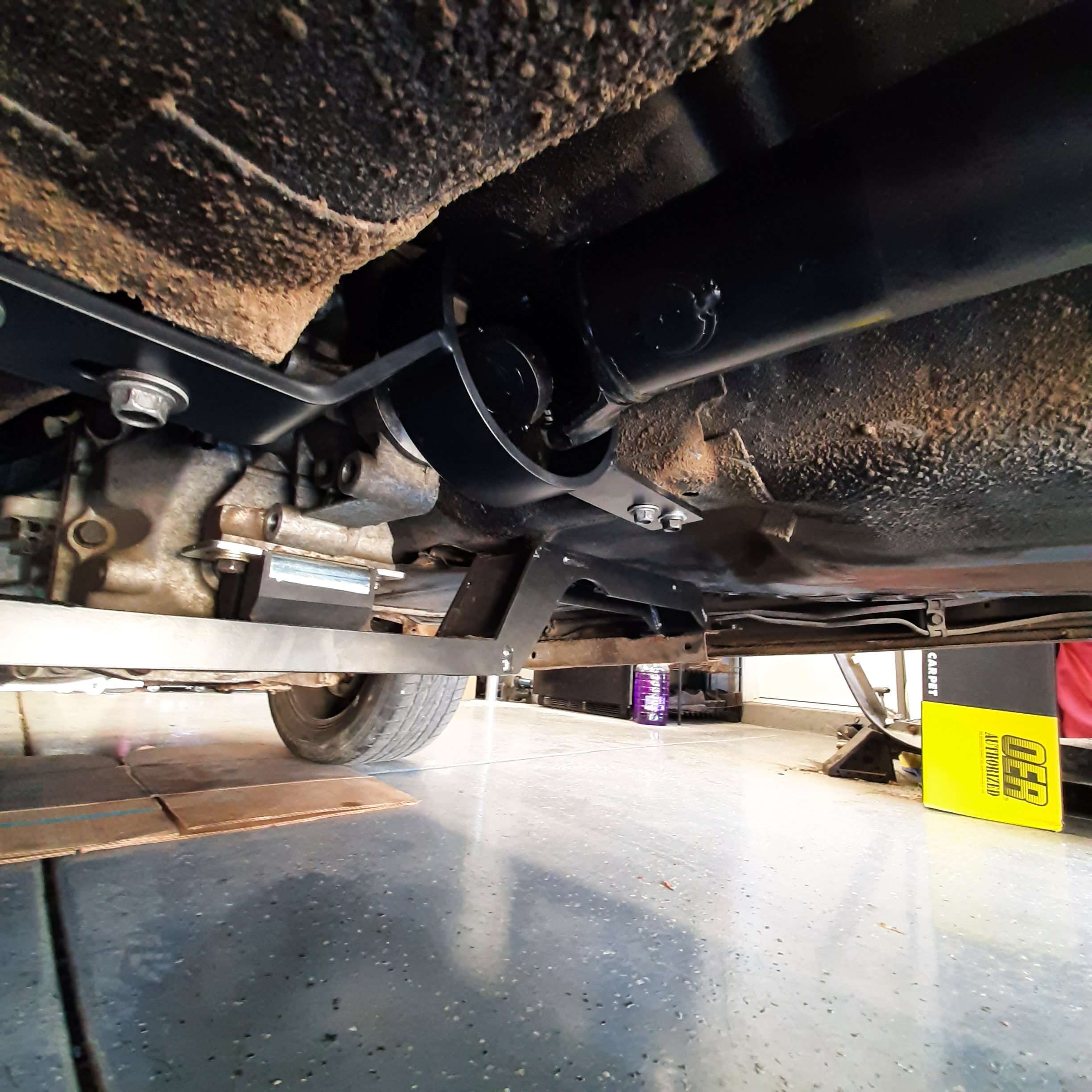

Well this shouldn't been a surprise to me but it was. I ordered a driveshaft loop and went to bolt it in and noticed it's too close to my transmission. Well then i though i did shorten the drive shaft 4 inchs. So it's a "brace" right now

Same situation here. Going to make some plates and move it back eventually.

Within 6" of the center of the UJ.
