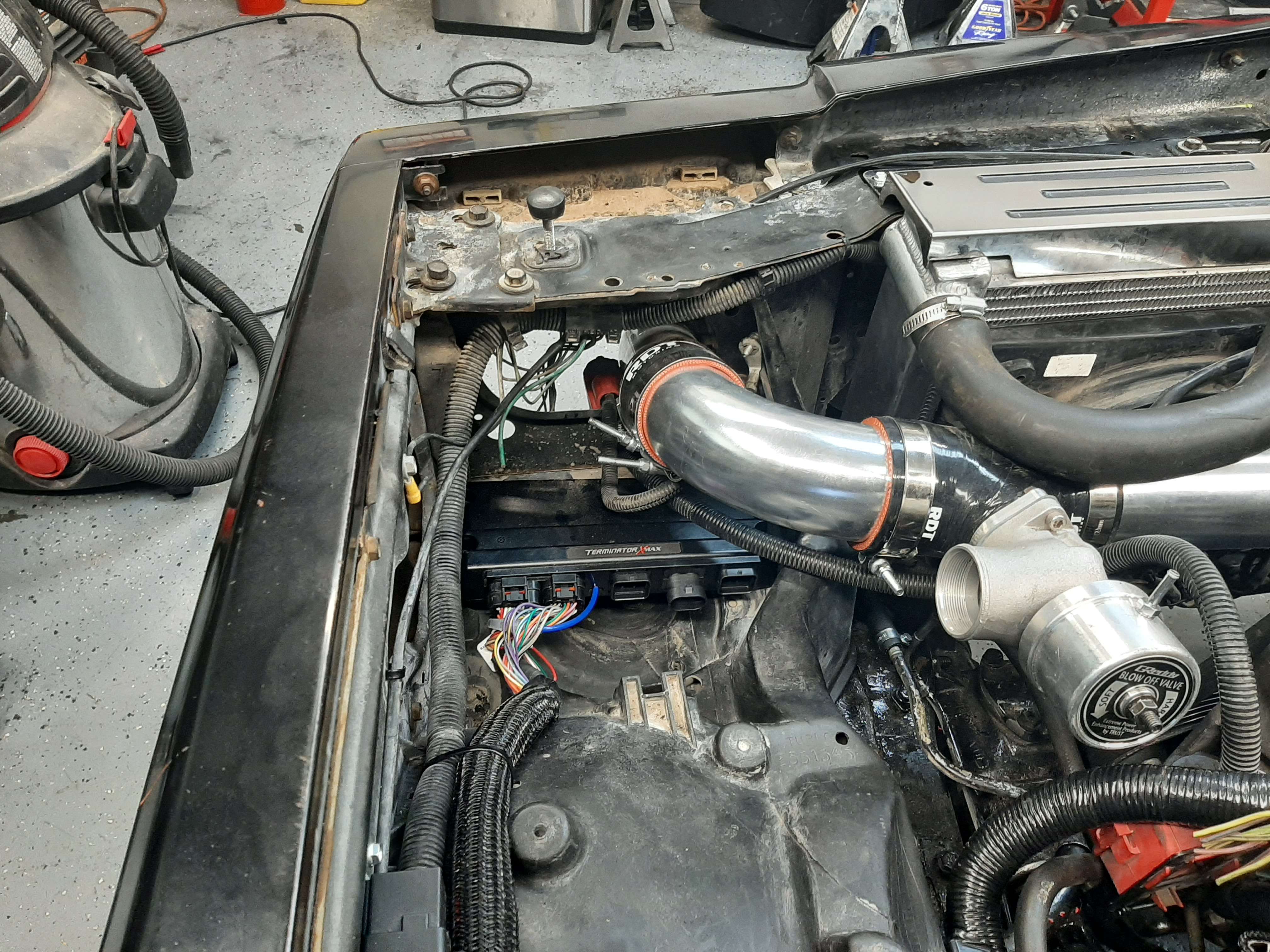

Some more work done. Ran Ptfe an8 feed and an6 return lines running thru a aeromotive FPR. Also added a flex fuel sensor to the return fuel line and wired it up to the terminator ecu.

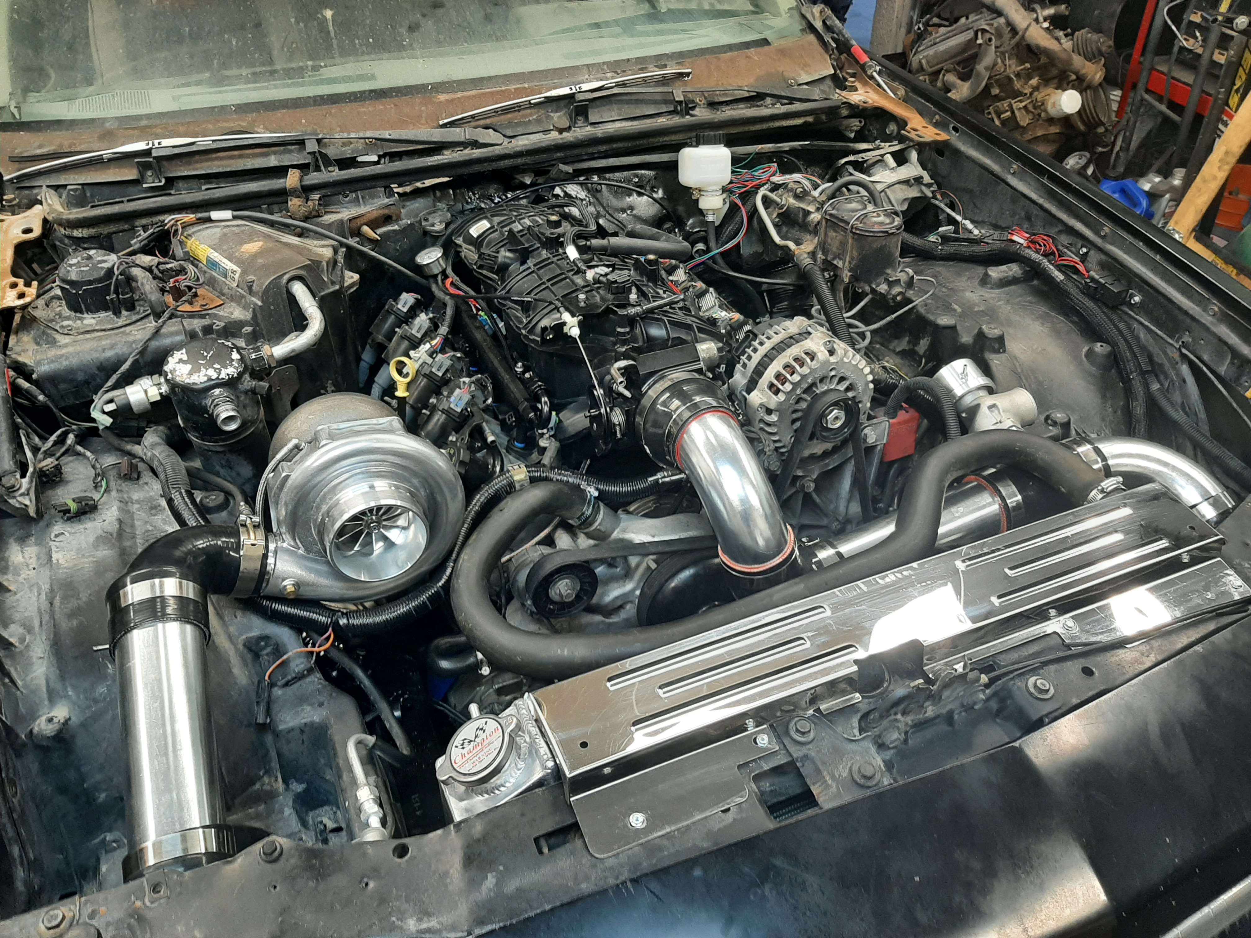

The turbo intake is done "for now". I'm going to redo it later to get a true cold air setup.
Strongly recommend putting a check valve in the PCV valve hose. It looks like you’re relying on the PCV valve to keep from putting boost into the crankcase. And that will work, until it doesn’t due to the PCV failing.
If it does, then you’ll be blowing tons of air through the crankcase and out of the vent which you don’t have hooked to anything presently (passenger side valve cover) .
None of this is a big deal until you blow oil all over the turbo at WOT and 80mph.
My two cents - $15-20 from McMaster-Carr is well spent imho.

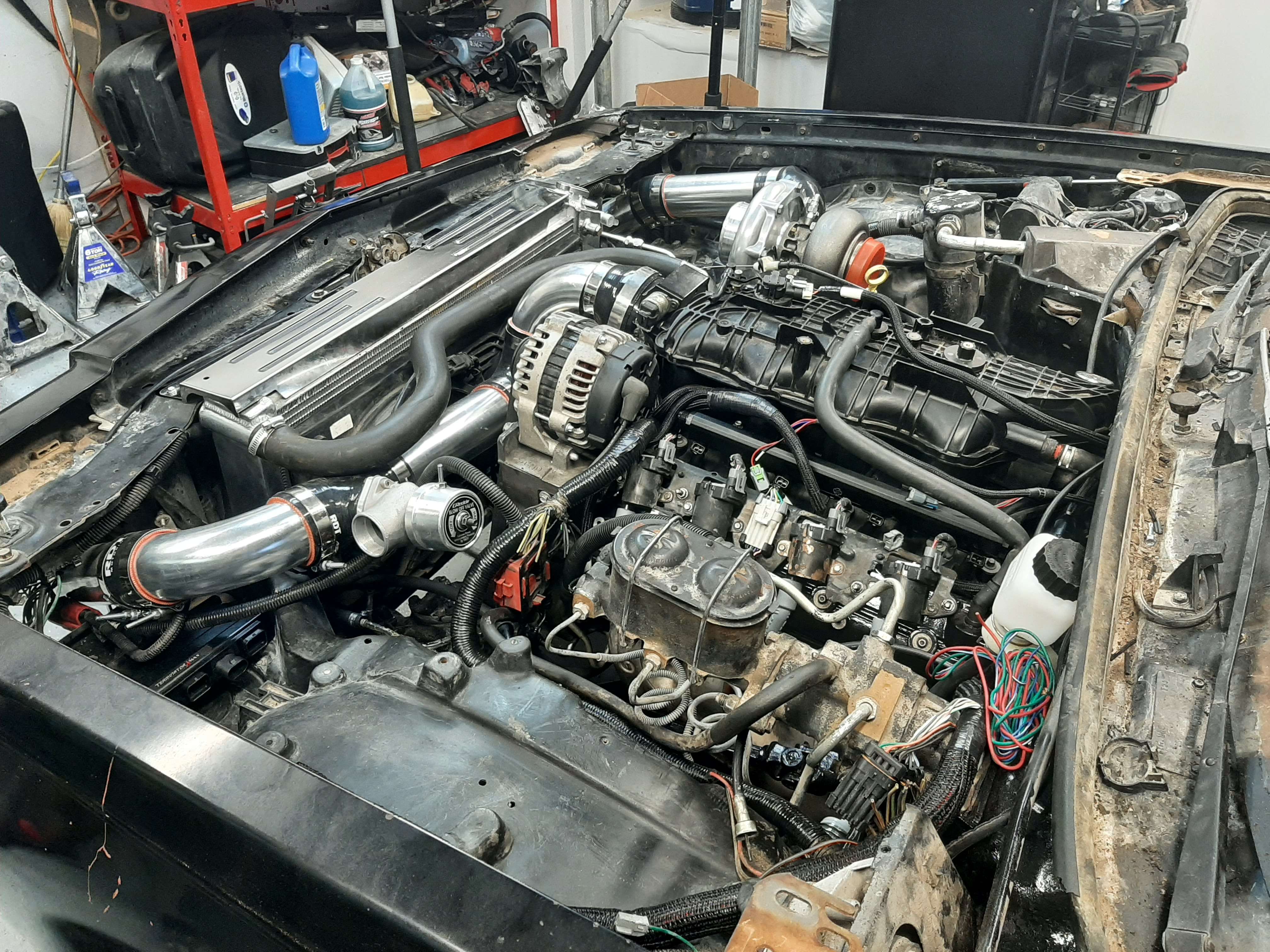

Very keen eye 64nailhead the pcv system hasn't even cross my mind yet. So my drivers side valve cover does not have a pcv valve in it just a nipple and the hose currently goes to the top of the intake manifold. The VC came off a 5.3 aluminum block 07 with dod if that matters.. That leaves me questioning where my pcv will go and how to plumb the catch can in
. Any ideas?
Put one either in line or get a different valve cover - one that accepts a PCV valve. You need one if it’s going to be street driven a bunch. And you should put a check valve in that line between the intake and PCV valve too.
FWIW, I made a similar mistake a long time ago. Trust me when I say it will be an oily mess before you identify the problem.
