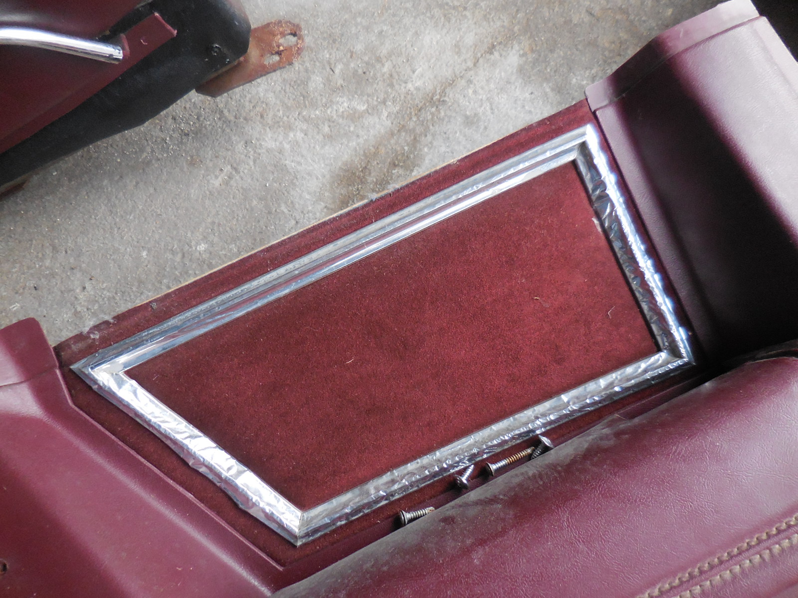

Pulled the plastic trim all around, it needs cleanup and recoloring but is otherwise solid. I did notice that the chrome is peeling off some of the side panels. chrome pen or a heat shrink chrome....which way is best to redo that?
You can buy just the headliner cloth with foam backing from about a zillion suppliers. If you're doing the visors too, then get a little extra. What would that be, about 1 to 1.5 yards if that?
As far as the plastic trim, that crap was heat sealed directly onto the fabric. The molding is a flexible gray plastic underneath. It was a PITA to remove it without fugging up the fabric. Luckily, I was able to find a pristine set, so I didn't get into how I was going to refinish those moldings. Nearly EVERY G-body with that rear panel molding looks like that eventually. I did experiment with a piece of chrome, very thin mil mylar tape. It looked good, but I did not do any long term testing to see how well it would hold up over time.
