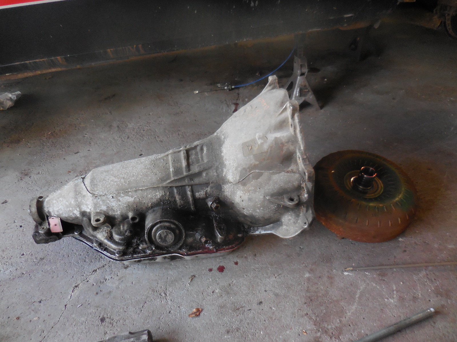

The OZ transmission has operated well enough but I haven't really been flogging it.
It exhibits a slow engagement into gear when I go from park to any drive gear.
Being how I am, I know I wont be satisfied to run it as it is. So I dropped it out today so I can disassemble and inspect it. I likely will overhaul it while I am at it, because.....why not?

That trans came out of 85 442, pink OZ trans plate tag. Make sure it has the correct OZ valve body, it should be stamped OZ and or has a pink/purple color paint mark on the valve body. Back in the day transmission shops would remove the performance valve body and replace it with a stock unit. I recommend rebuilding it with hard parts, expensive but well worth it.
