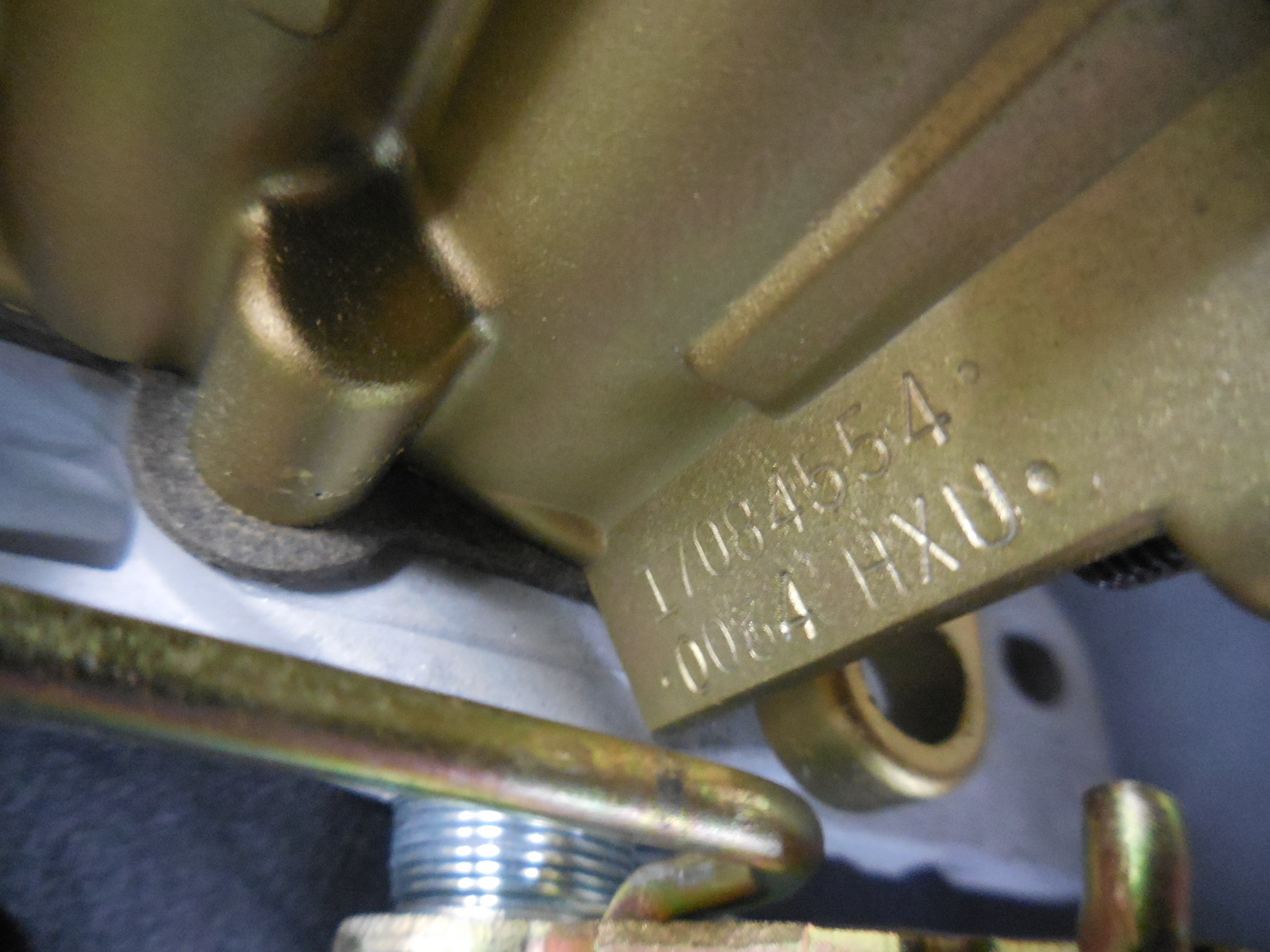

Ken, is that a 750 cfm small primary carb on your Hurst/Olds?

I figured so. I could have sworn somebody claimed they were the small castings. Does it have any differences in calibration compared to Vin Y cars?

my notes show that VIN 9 carbs had EL secondary rods versus the VINY DD secondary rods. Also a very small difference in the Open distance of the air flaps. beyond that they are identical.

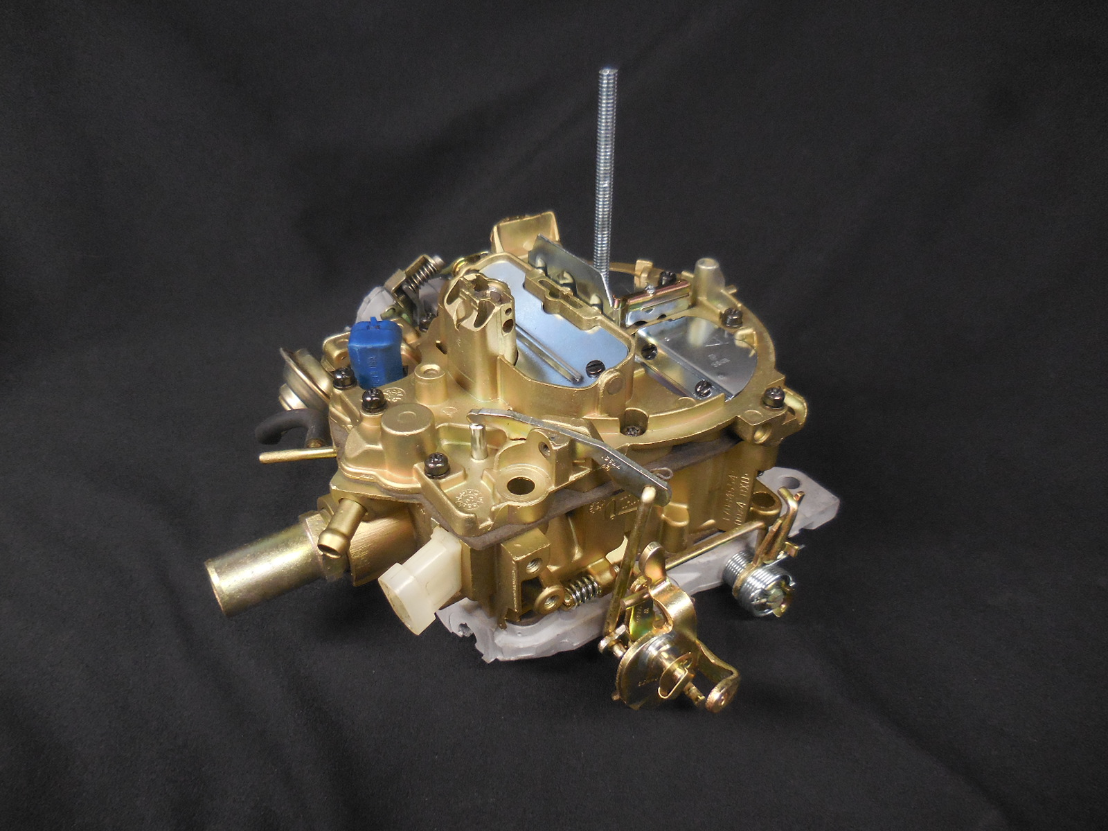

That carb had a factory electric choke?

VIN 9 did not have electric choke. They ran the heat tube from the intake. But you can change it out.
