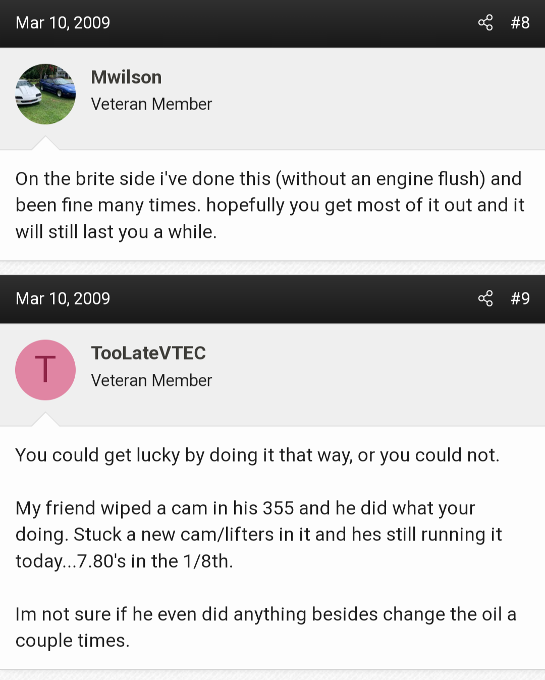

This guy took his chances the same way and the only issue he ran into was cheap made flat tappet lifters or the used cam he put in with the new lifters.

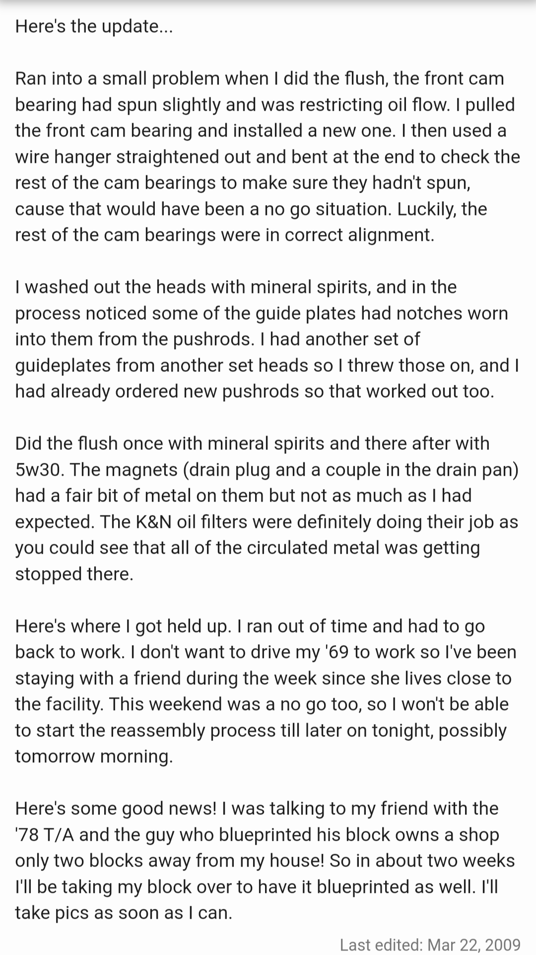

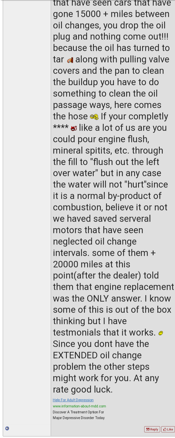

See what I mean by you can always teach an old dog new tricks and there's more than one way to skin a cat ? None of you who have ridiculed me in this thread have even suggested something like this which would have been more helpful than trying to consistently persuade me to pull the engine and tear it down when I don't have the means to.
Worn cam lobes and worn lifters and the metal particles are not a guarantee to pull the engine into the complete teardown and you can actually flush the metal particles that are in the engine without removing the engine from the car and tearing it down.
