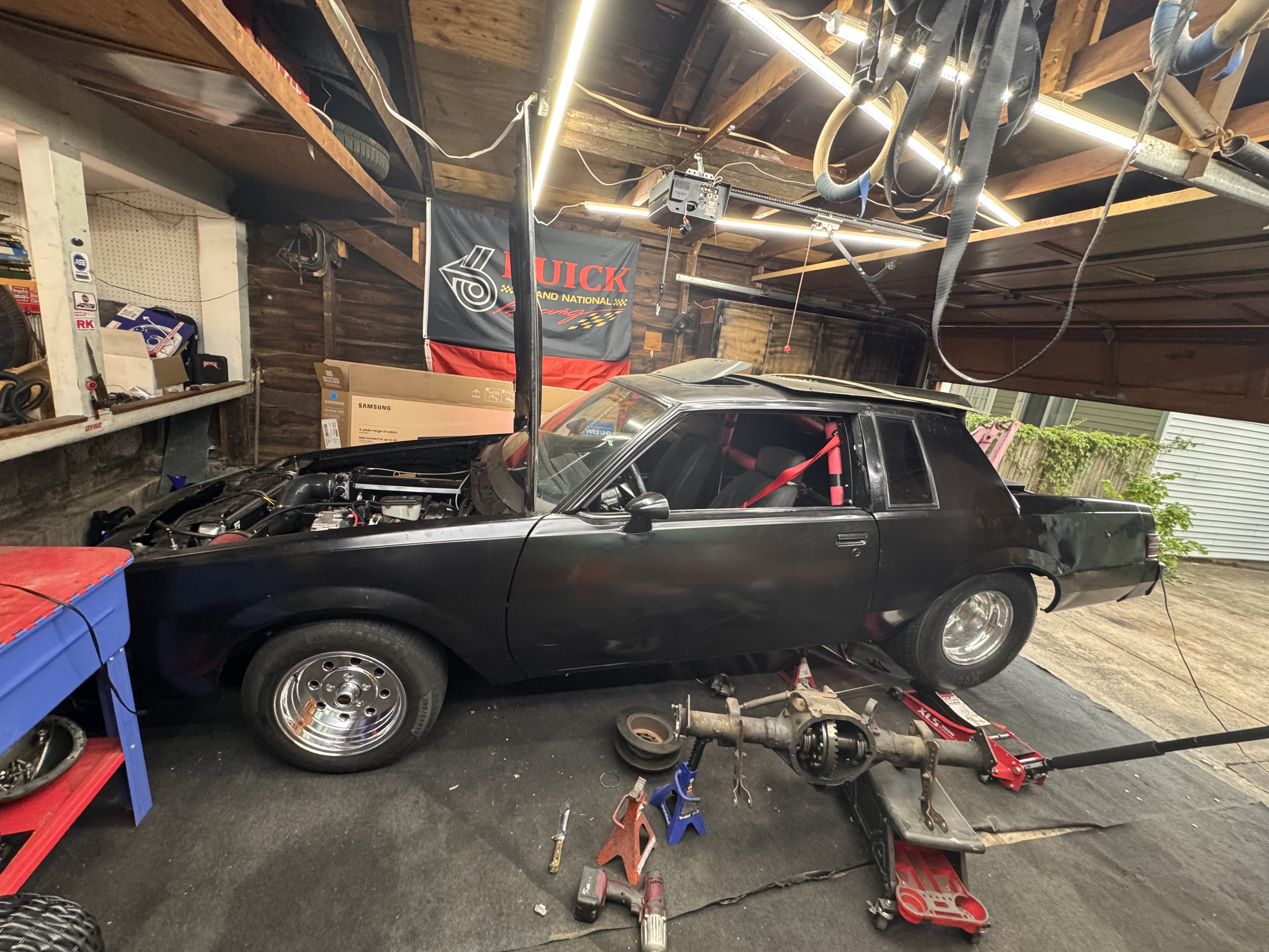

Quick update,

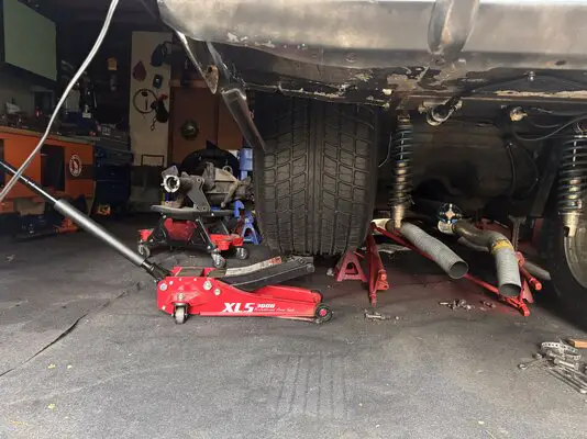

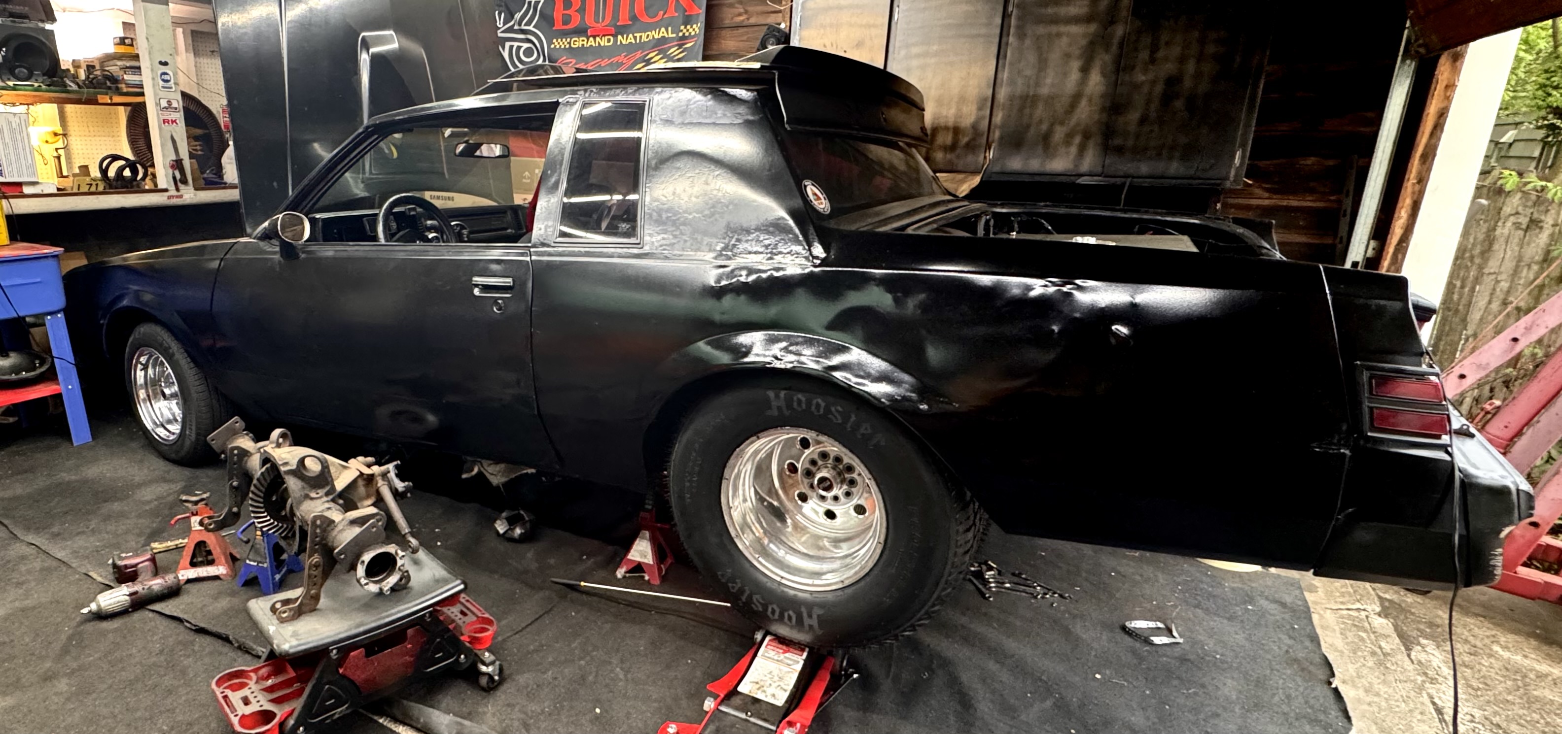

So after some occasional rips, the trans definitely let go, the continuous popping at WOT was the trans slipping. It was a shady story from who i purchased it from, he became a salesman instead of a friend with that deal, which made me just keep denying the trans was bad.

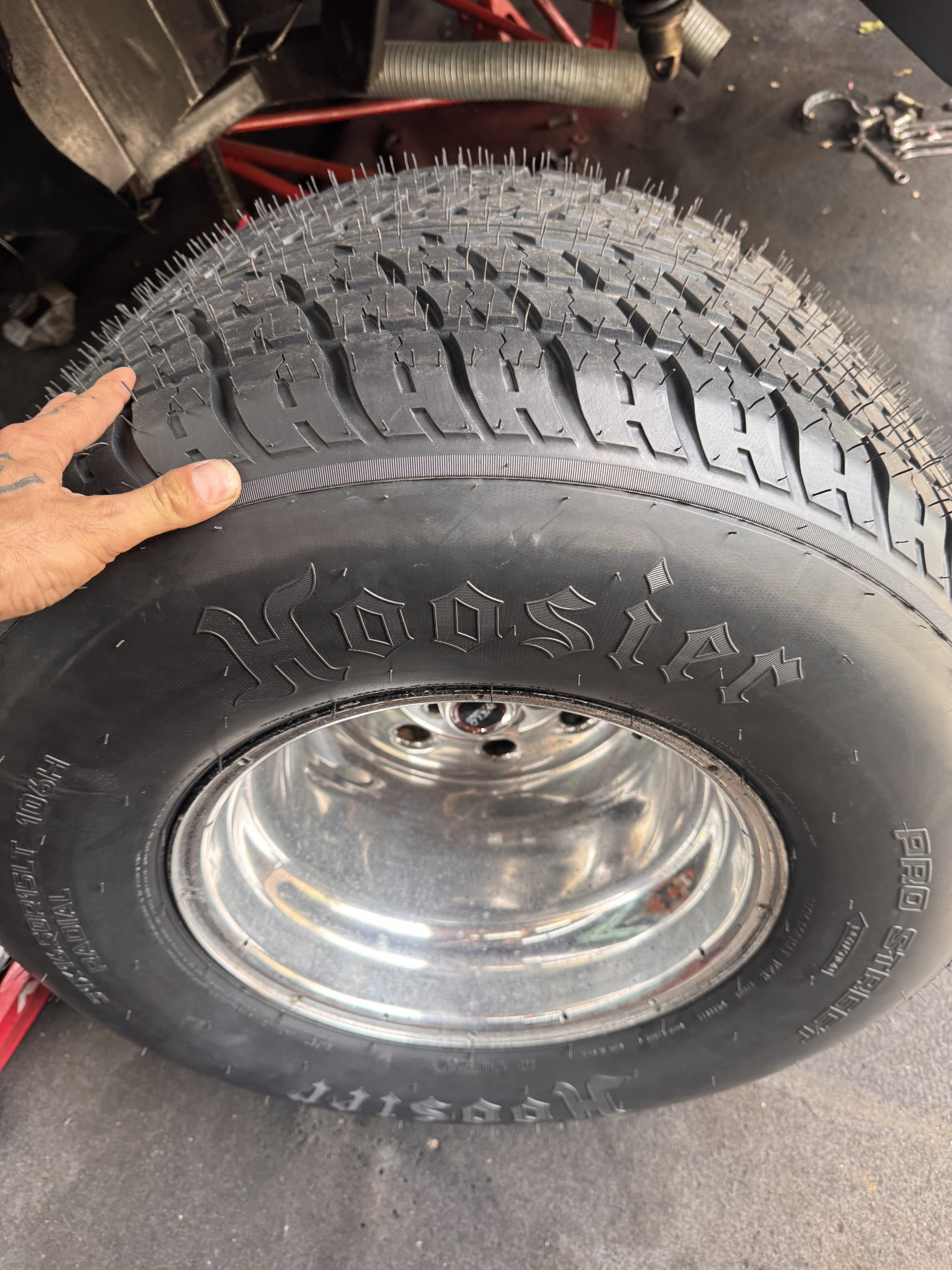

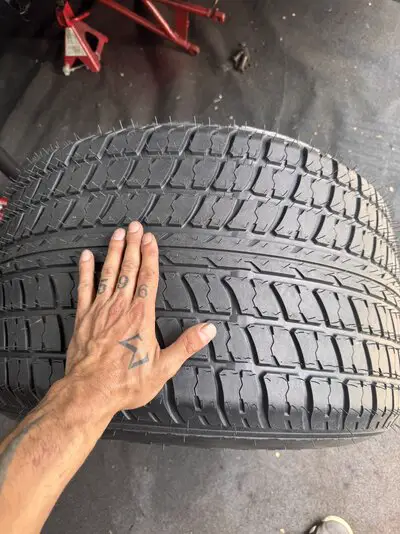

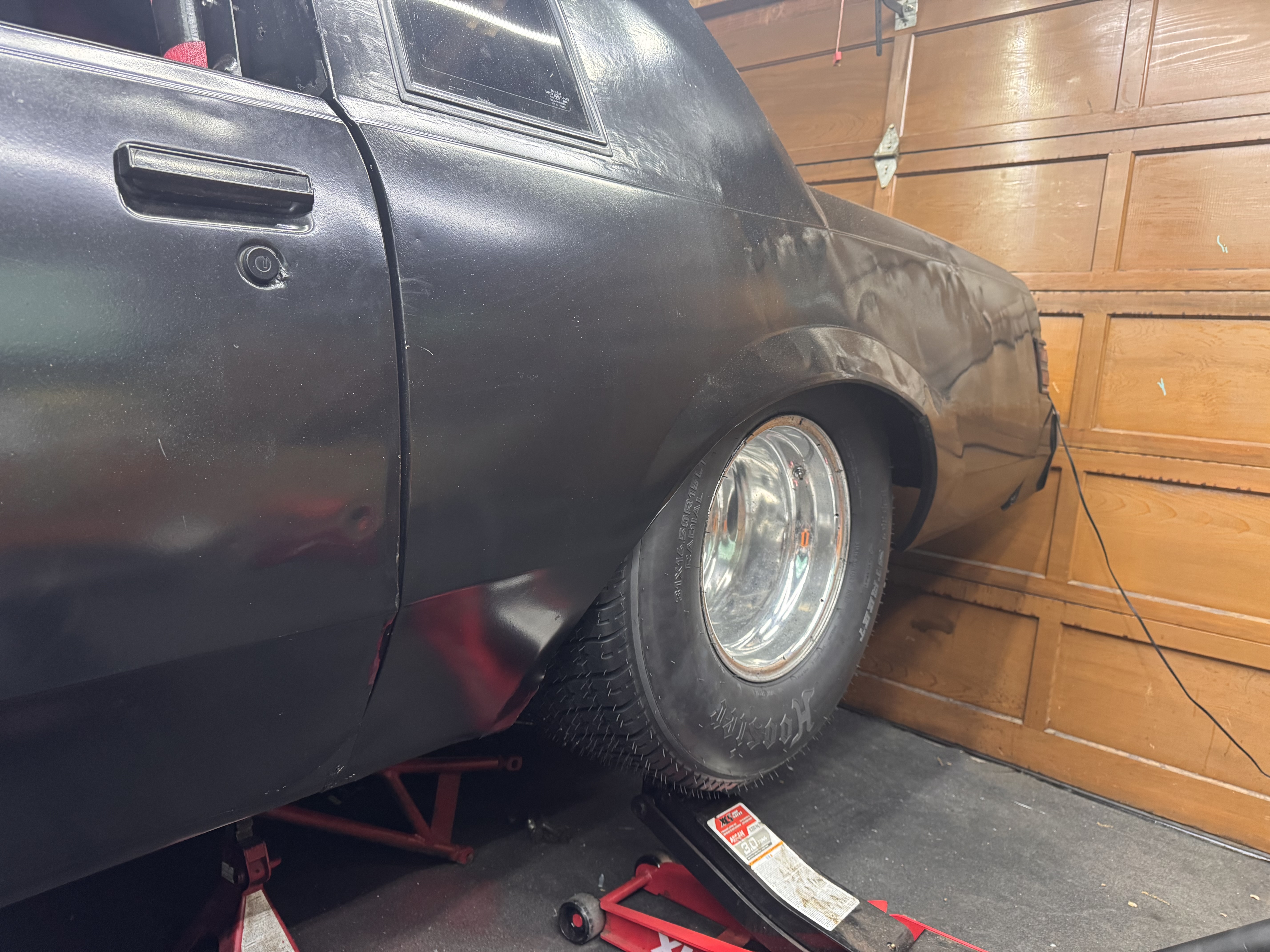

I pulled the diff as well, the dilemma is if I’m going to keep the 295s (26s) with a lower gear, or go up to some et streets 28/29, with higher 4.10s or minimum 3.73s. The 26s are way easier to find, more mileage, and way cheaper, they just look stupid with a shortened diff, compared to a nice big tire that’s triple the price and a fraction of mileage, but anything is better than the old beat up way too high 4:88s it had in it. the bearings are shot, and I’m ditching the spool since it’s going to be street driven, the chatter and chirping would destroy the new gears prematurely. Going with a truetrac and i realized they make 3.90 gears which I think would work best for the type of driving I do, and also for safety reasons if I lose a wheel.
But the good news is the engine is totally dialed in, it’s performing great after working out all the bugs with the Fitech
I plan on keeping this setup until
Next year, and than going fbody t56 and selling the auto setup as a lot. And a
