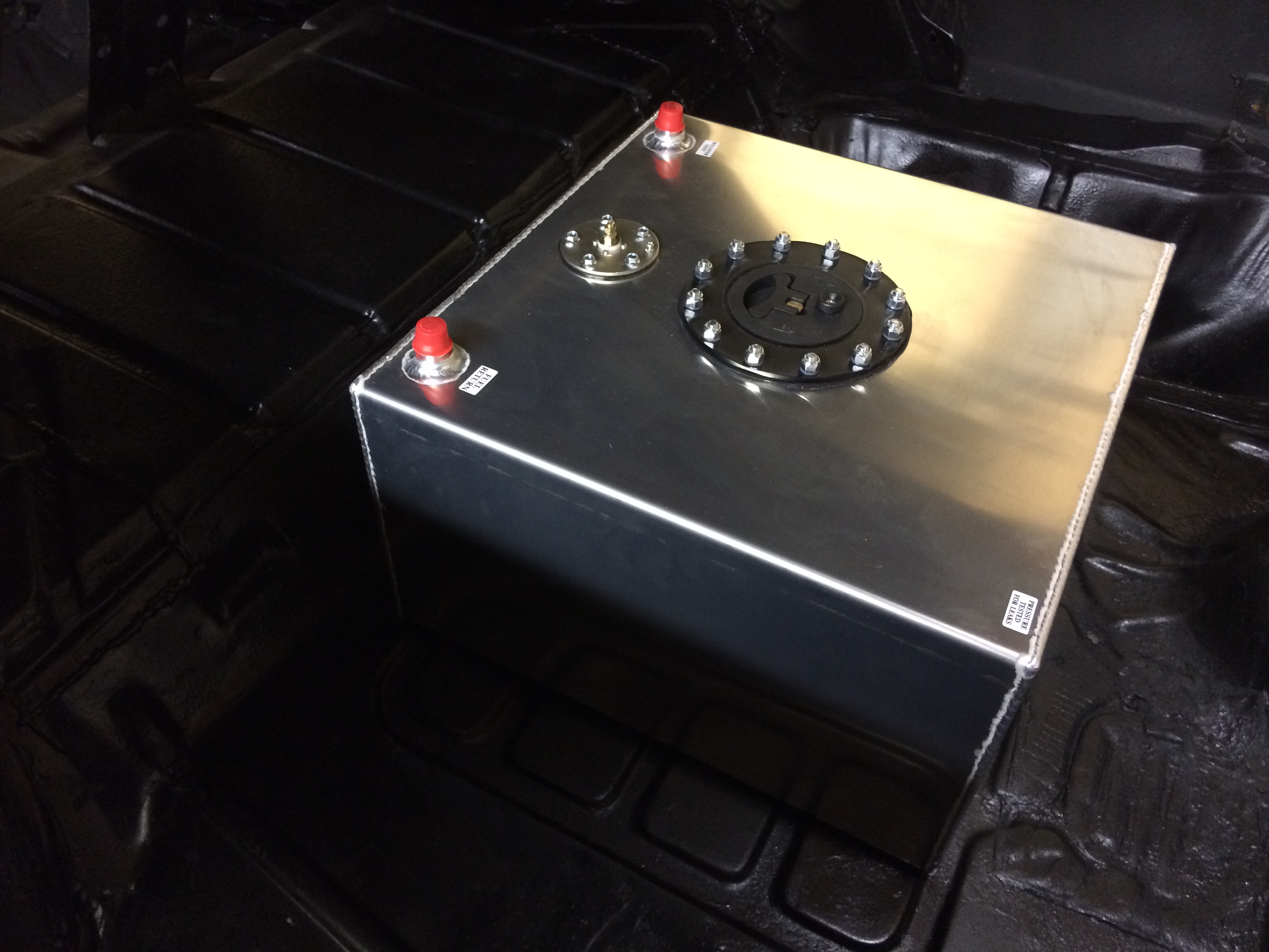

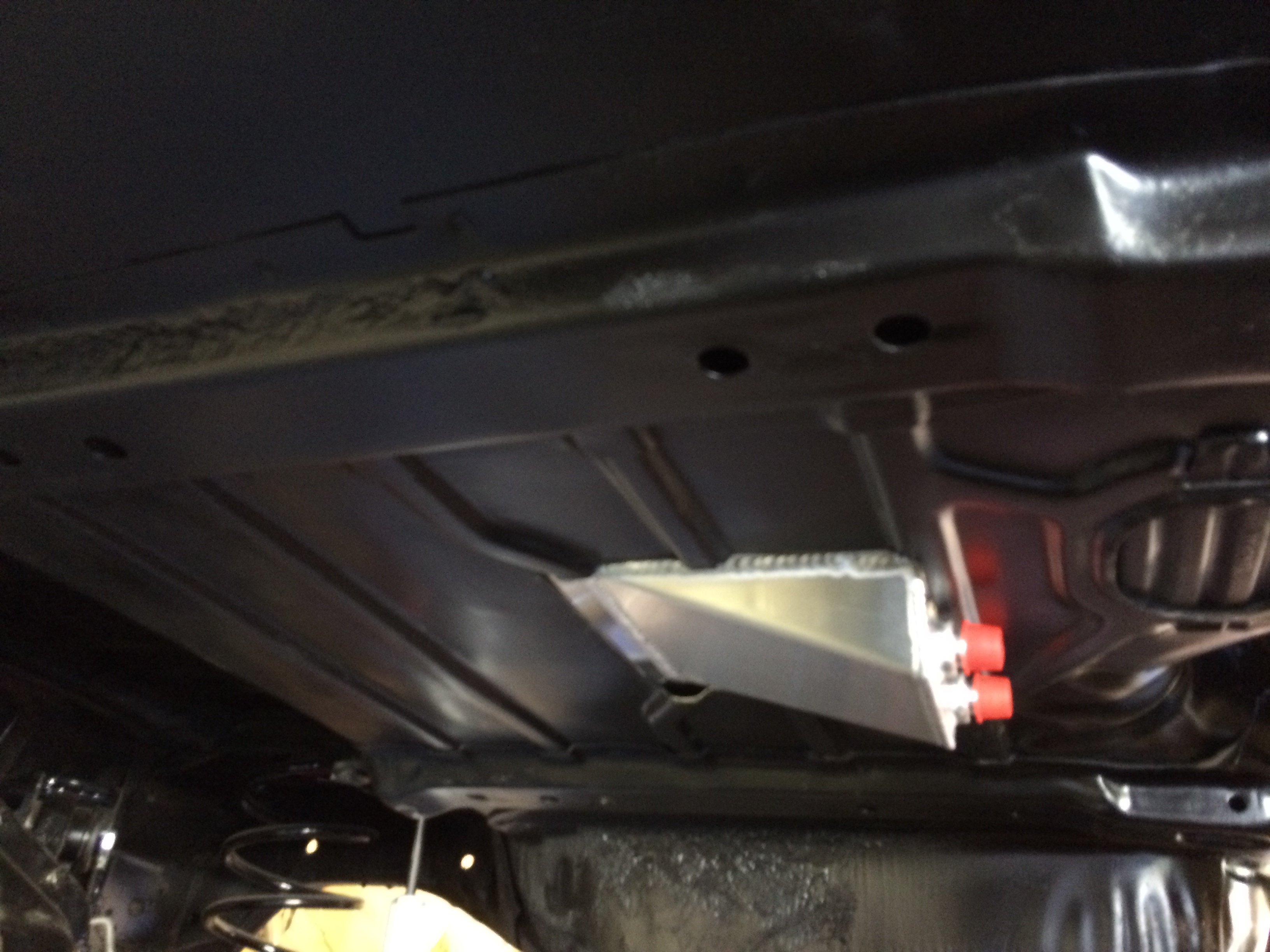

Won the fuel cell I was bidding on auctioned on ebay. It's an Rci with a 2" sump. It should be in this week, so I can put it in the trunk and cut the hole for the sump. Valve locks came in, I will have to get them and a few gaskets to my uncle's shop. No updates on the engine build yet.

The fuel cell came. I still have to order the mounts and I can start measuring hose lengths and do my routing.
