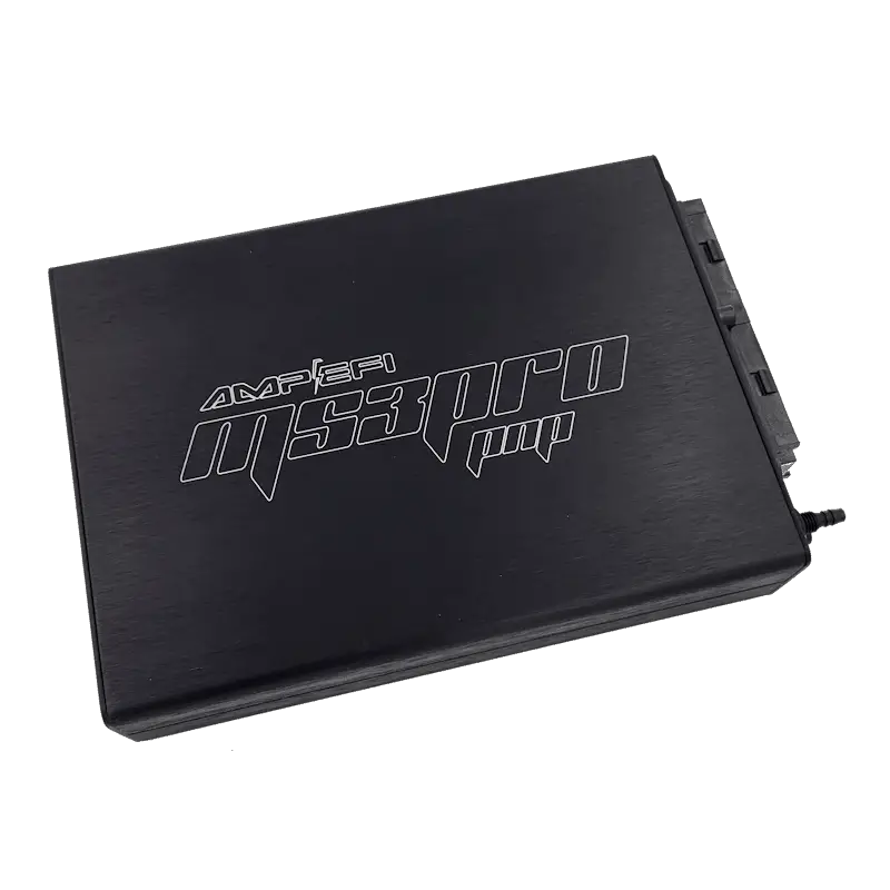

Dynamic EFI sells a chip that converts the stock ecm to tunable
Ms3 does too
