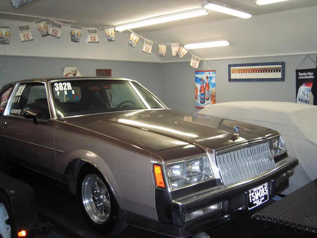

Oh I've got a pcv valve on there now. And that's no parts car it's going to be the next build 😀 I love the color scheme I'm definitely going to stick with it

Got it back on the road! Ran my clutch line a different way so it wouldn't rub through on the clutch this time...lol. also picked up a parts car for $125 and he delivered it so that was cool. Cars pretty rough but I'm going to snag the steering column and the rear end if it's posi and some other bits
