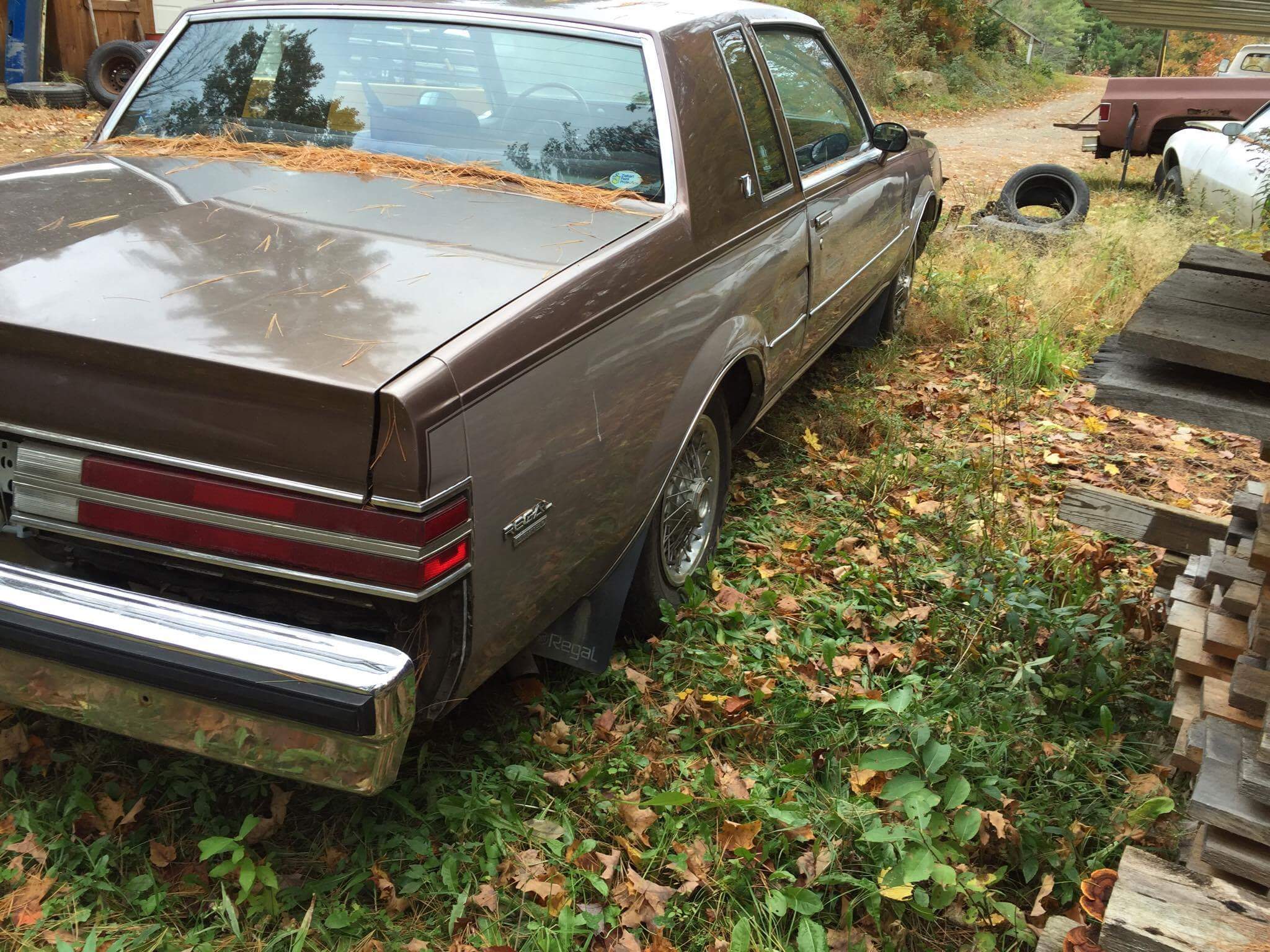

So may be buying anew ss monte parts car in the near future. Good shape red interior and mint front end. My front clip has some dings and my spoiler is sh*t. Going to try and clean up a small spot of rust in the trunk and then patch the floor where I cut a way to big hole for the heads shifter. Also.managed thereof get the buick home to sit till I figure out what I want to do with it. Here's some pics of a little photo shoot with my buddies turbo 6.0 69 cutlass
