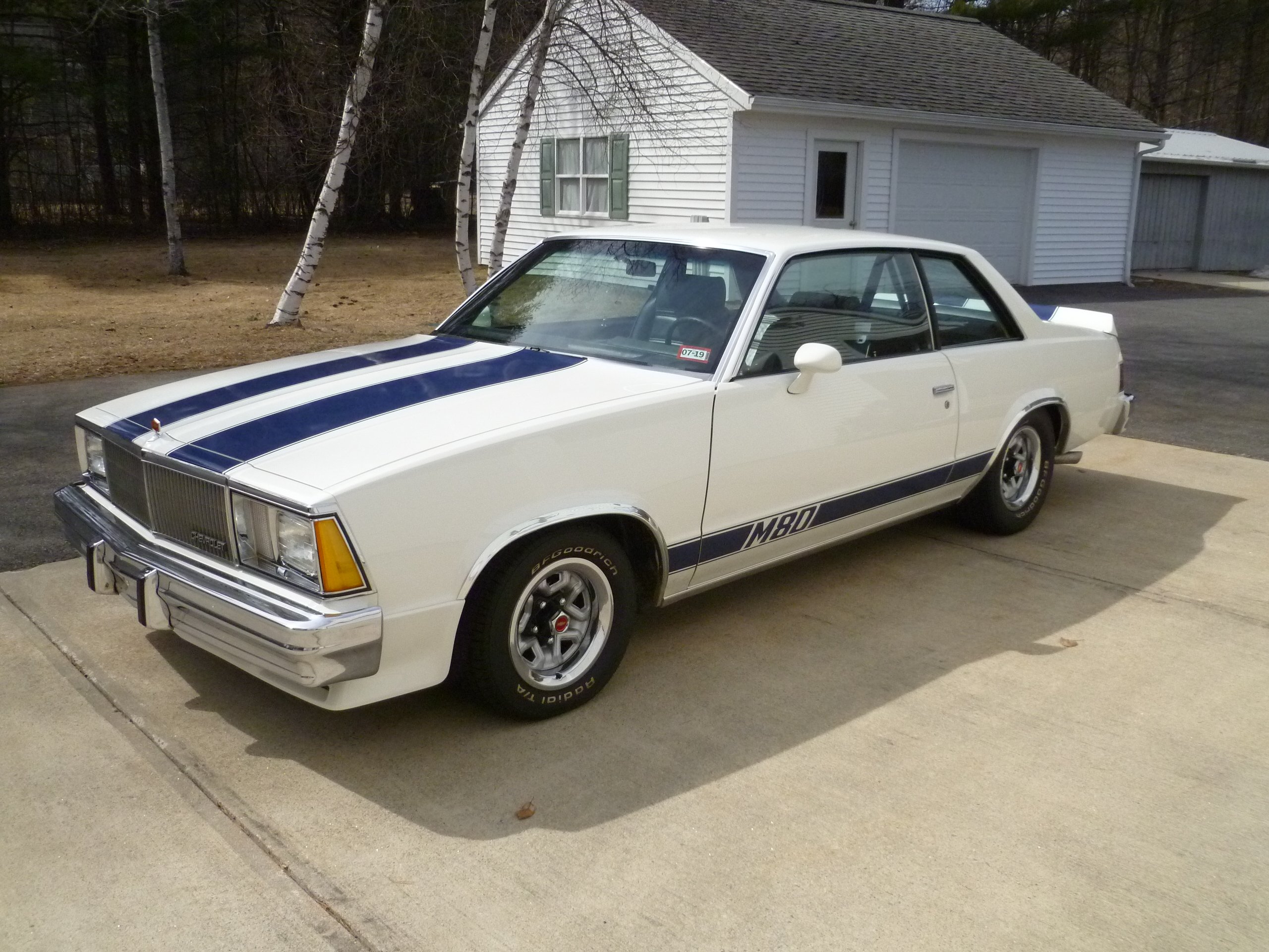

Just a suggestion for polished aluminum.
I refinished the aluminum trim in my 1980 M 80. Did not like the idea of polishing the trim regularly. I had it coated with Cerakote clear ceramic coating two years ago and it hasn't aged at all. I had my powder coat guy do it, but after seeing the process I think you can do it yourself if careful. It goes on with a detail gun and air dries. It seems to be very tough and is good to 400 degrees.
By the way, the M 80 was a two owner VERY clean car. I stripped it to bare metal (no rust ever and only two minor bodywork places perfect floors and frame) and painted it single stage white. I also added a 6000 mile 2006 GTO LS2 and transmission, ECU and etc.1.JPG

Interesting. Thanks
How do you cure the stuff?

That's the best part - IT AIR DRIES
