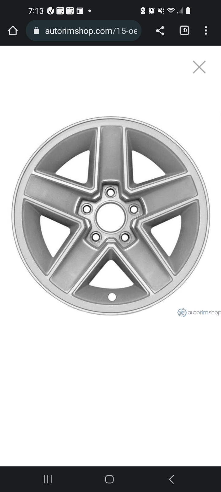

#1 - aluminum polishing. I'd like to begin with some of these style camaro rims I have:
What I'd like to do is leave 95% of them the hammered grey finish, but the thin flat circle around the edge and the two flat lines on each spoke edge running towards the center I'd like to get a nice shiny polished finish on.
To my knowlege they were never done as such from the factory.
Obviously the ball style attachments they make wouldn't work for such a fine area while leaving the rest untouched, is it something a Dremel tool with a fine tip would work well with? slightly concerned with pilishing just the surface away without wearing down into the surface level. I've never tried doing such a thing other than as maintenance of an existing polished surface, but, think they could look pretty sharp done up that way.

The Camaro wheels would originally have been machined on those areas, and clear coated over the entire face.

The first step would be to see what the finish is currently on the wheel, since that will have to stripped to bare aluminum before any pre polishing prep is done.
That's something I was trying to figure out. The 16" versions were and I've seen plenty that are. But these 15s, I can't remember any and even the 'new' reproductions and reman wheels all seem to be the single dull color except for the ones that have some paint on them

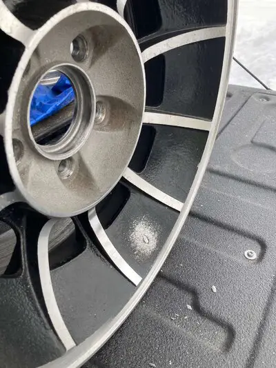

In response to your questions about refinishing wheels:
#1
I'm doing something similar with the GN wheels that I have on my Regal. As a test I sanded by hand one of the "spokes" and the outer edge of the rim with 400 grit sandpaper (followed by 600 grit) to remove the clear coat and the machining marks in the aluminum (pictures attached). I followed this by polishing with Autosol. Very tedious work but I'm afraid that using any mechanical means will leave unwanted grooves in the aluminum and take away from the defining edges (already noticeable where the spoke meets the outer edge of the rim). At this point I'm going to try a citrus paint stripper to at least get rid of the clear coat/painted area between the spokes and sand/polish from there.

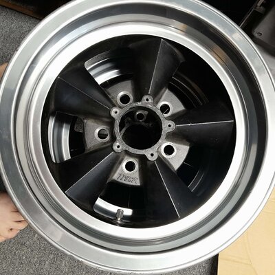

Polishing aluminum parallels auto body work in that your finished product will only look as good as your prep work.

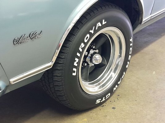

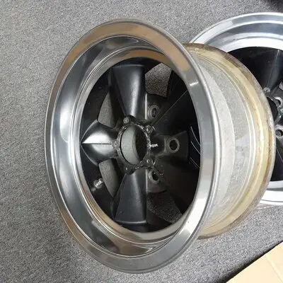

I've polished valve covers as well as wheels. My first set of wheels was a set of Foresight Ventures "Track" wheels that I purchased from a local wrecking yard for $5.00 per wheel, coated in red house paint. They were straight, and the yard owner didn't have the energy or time to restore them for his 61 Bel Air. These were polished about 35 years ago and still look fairly good even after being stored for the past 20 years.

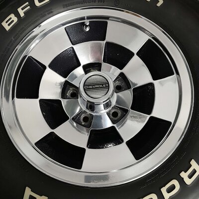

Biggest challenge had to be a set of Monte Carlo Checkerboard wheels that I picked up for my El Camino and now are storage wheels, They were sometime before my purchase stripped of the clear with a wire wheel. Ended up DA sanding with 180, 320, then 400 -600 grit before polishing with a buffing wheel on a bench grinder. They look good from a distance but need refining to hide the porosity of factory aluminum.

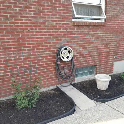

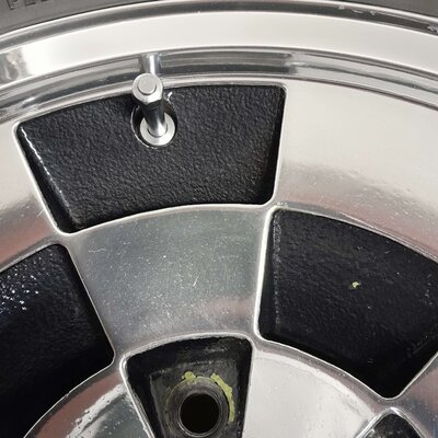

To date the best results came on the hose reel for my house and the Torque Thrust wheels on my 79 Monte Carlo. These were DA sanded with 180, 220, 320 grit then hand wet sanded with a block with 400, 600, 800, 1000, 1200, 1500 and finally 2000 at 90 degree angles to the previous grit. I picked up a buffing kit from Harbor Freight with the tripoli and white rouge compounds and the buffing wheels with arbors that would work on a hand drill. I used my variable speed Harbor freight angle grinder/buffer with a 8 inch wheel and white rouge to finish them. To keep them looking just polished I use White Diamond polish. Mothers has a great product but the White Diamond gives a far better clear finish. Just as a side note, I always purchased Eastwood polishing products until about 5 years ago. Their wheels and compounds are made in China like the Harbor Freight products but at 3x the price. Below is the hose reel and the wheels on the Monte Carlo.

Yes to all of the above and great pictures into the bargain. Those S-10 mags that i referred to will be getting loved by the finer grits of paper at some point in time this year. My 8 inch buffing wheel was sourced up here but could easily have been mfgd over there. It does seem to shed fibres readily but since I am leaning on it at the same time, i guess it is something that I should expect. The plan is to acquire a couple more of them so that I can load the surfaces with specific variants of polishing cake and not have one wheel do multiple duty. The tripoli is a red rouge or cake and I personally like the finish it creates. There are actually about five different colors of cake that have specific applications for certain metals. Think there is even one for non-metals like certain plastics.
