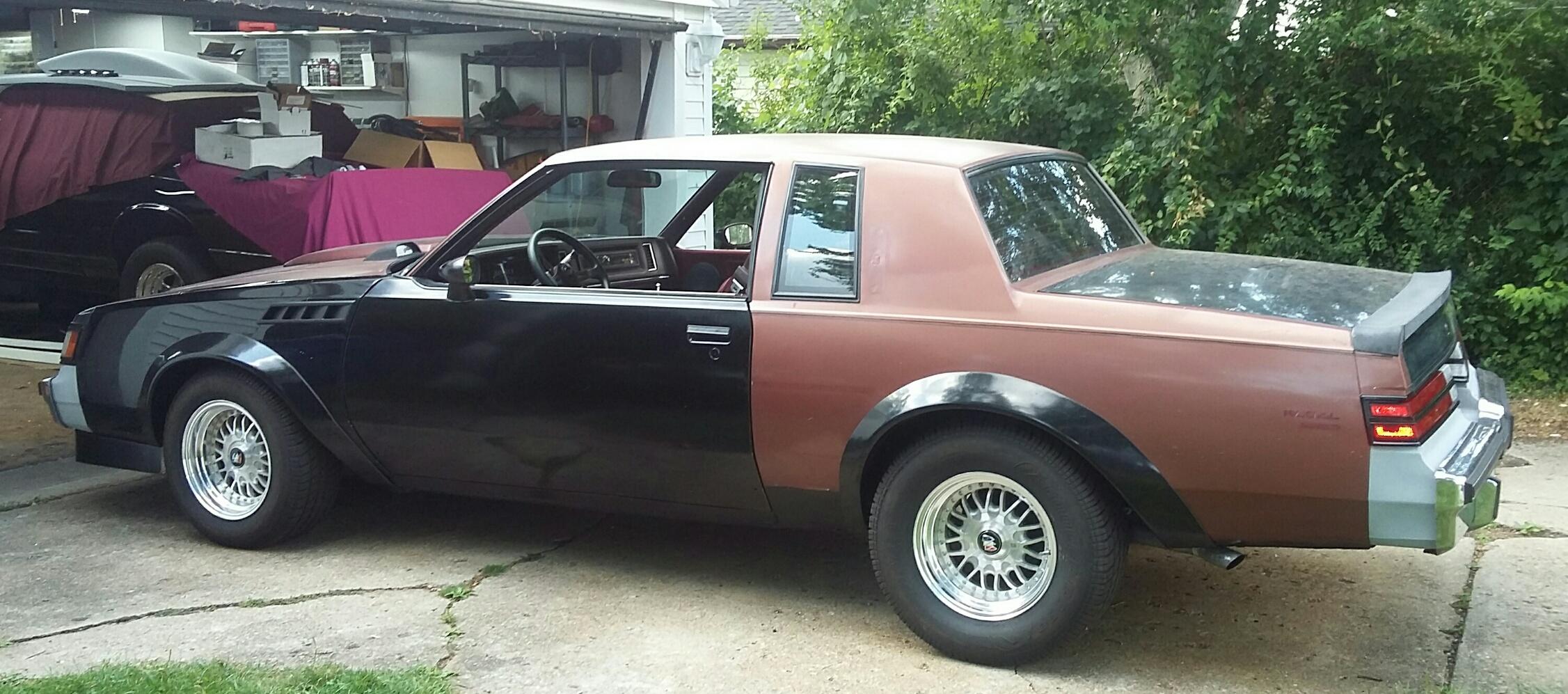

This is my Regal with Cooper Cobra 275/60 rear and 235/60 fronts IMO an under 26" tire would not look right in the rear.
Trans speedo gears can be changed and ratio boxes are out there to do the same thing that you just screw in between the trans and the speedo cable.
The speedo gear can be changed yes, but the rear gear ratio..........goes from a stock 2.73 to a 2.47 effective gear ratio when you go to a
taller tire. IS it truly worth it (TO ME) to go through all of that? Thanks for the pic of the 275s but I will stick with my plan. To each his own.
Oh and your flares adds to the look of your 275s as well...............which I don't have on my Olds.
