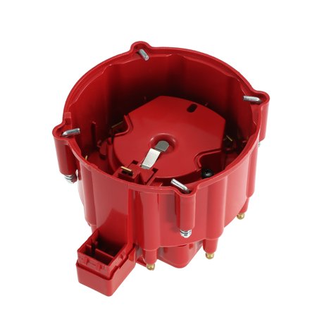

i replaced the ignition coil/rotor/cap and car fired up right away, let it idle and it did not shut off.
i plan to later today take a drive and see how things go.
is it normal for a rotor and cap to look like this? (attatched)
if it’s not normal, then i had bad luck as i had put this one on 2 months ago.
thanks

That is definitely not normal, that metal contact shouldn't be burnt like an overcooked pizza lol.
You might want to find out why it failed after 2 months however. Could be because you purchased a cheap replacement, or perhaps there's electrical problems as well.
You can get a replacement low ohm contact.

Blue Steak should be fine. I will use that or BWD parts (for ignition/electronics).
I would recommend putting some miles on it & re-checking everything. At this point, you still can't be sure you found the problem or if you possibly only found the result of a problem.

Yes get the MSD brass button and get a quality cap.
