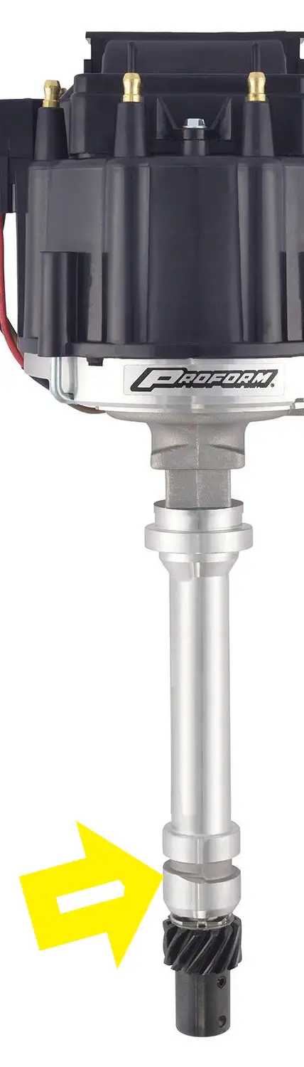

Top oiling on a big block goes through the groove cut in the distributor. Small blocks don't need the groove cut all the way. So you might have a distributor that fits but is not compatible. Make sure the distributor is not blocking the oil passage.

I’ll pull the distributor and look it’s new for bbc and I don’t think that vertical groove is thier.
