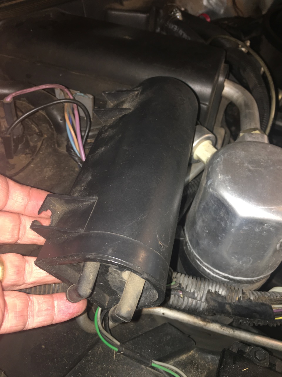

** Also, there's a vacuum reservoir (or ?) by the AC box, looks like a small black box about 6" x 3" x3" with the top rounded over like a breadbox. WTF is this piece and where can I get a new one? The mounting tabs are busted off and its just floating around loose in there.... I thought I took a pic but its not there.... I will update with one.

here's that stupid box I was talking about. couldn't see any markings which doesn't tell me much.
I'm thinking that is a different version of the vacuum ball on the A/C-heater box. I got one on an extra box top out of an Cutlass.
Yeah I'm starting to think that's exactly what it is. I probably have one laying around, will look this wkend.
