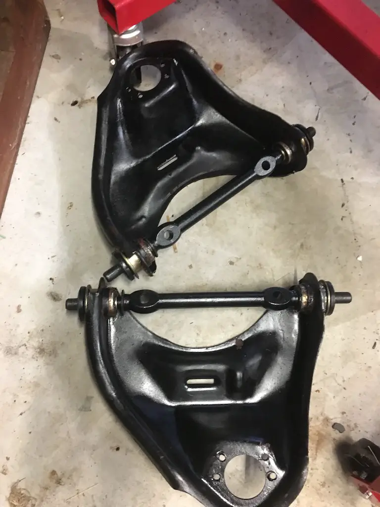

much bashing, hammering, grunting,head scratching, and creative applications of vices, impact sockets, and ball-joint-tools later, I finally got all the bushings out and have the uca bushings done. The lowers I'm still trying to get the last 1/4" or so of the long ones to go in. I may have to carefully hammer them back out and take a hair of material out of the hole with a dremel or emery cloth or something. I dunno what the deal is. Both sides are acting the same. I don't have the correct spacers anyway to keep the arms from collapsing if I did have the press power I needed. Managed to make do with the vice and some chunks of 2x4 so far. Cripes my back and lats and arms are dead. You'd think I was on a chain gang bashing rocks or something. ++ I can only get a couple hours in in the morning before that damn shop heats up and my specs get full of sweat.
The press I got has proved nearly useless, the opening is too small to get the entire arm in, and the way it sits on the bench you can't just swing it underneath. And when I can get stuff in there, it doesn't seem to have enough leverage to get the job done. I may end up selling it when I'm done and getting a hydraulic one just because its pissing me off with its uselessness. Then I get to touch up all the new paint I've messed up thinking it wouldn't be this tough a job.

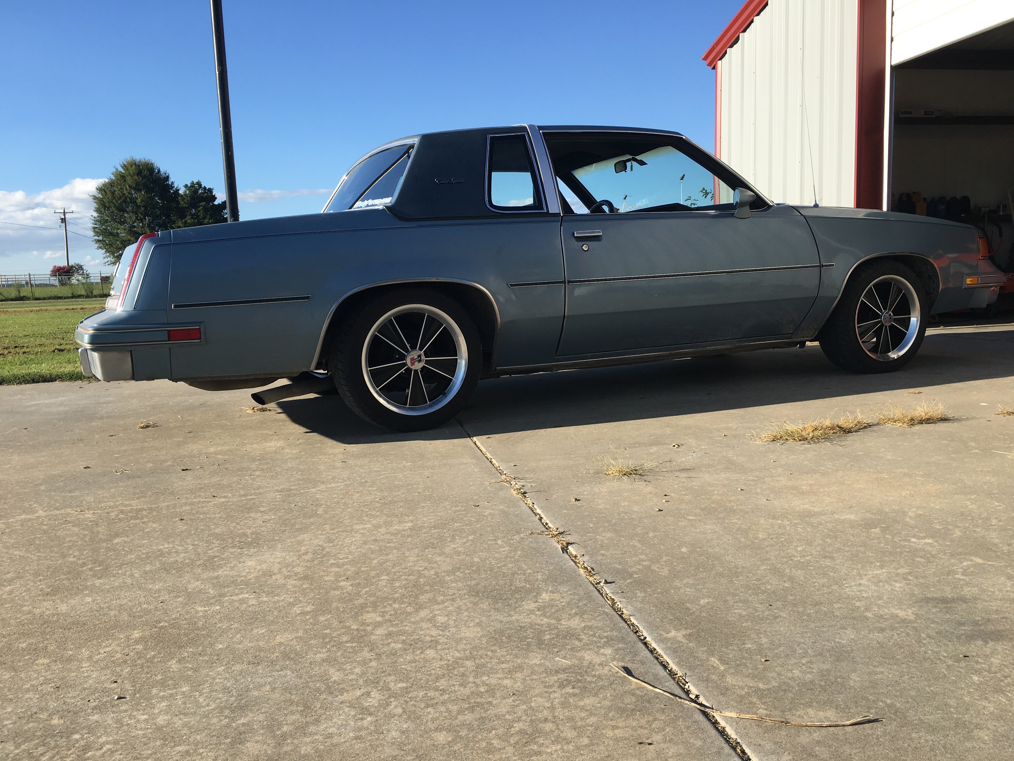

Well she's back on the road. Took her down one of the county roads (45) and back on the main highway (70). No pulls. No vibrations. No funny noises. I'd call that a win. Will still take it in for an alignment before the cruise but I figured it's be pulling or something.
I honestly can't say that it's sitting much lower. That's how wiped out the old front was. But handles 6900% better. Not floating around or plowing the corners. I think the poly was squeaking a bit when I first pulled out but it seemed to settle in. The old springs sounded like somebody jumping on an old bed.

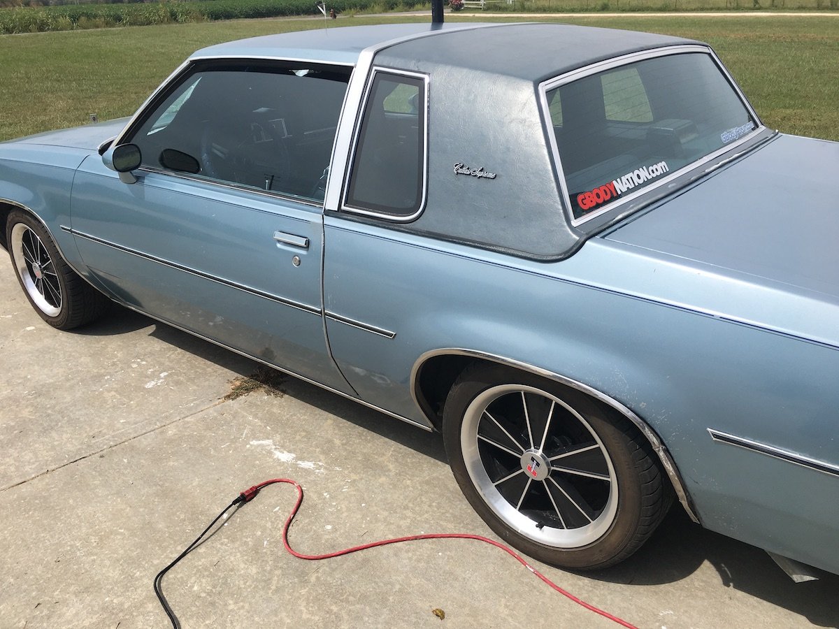

They say you can't polish a turd, well, didn't stop me from trying. Hit it with the rubbing and polishing compound with the polisher... then waxed by hand with old-fashioned turtle brand carnauba wax. I had done patches of this last year to see if it did any good, now with the cruise coming up its time to buckle down. Did the roof, trunk, rear bits, and drivers side. The roof polished up pretty good, but even after two coats its still not smooth enough. Probably won't be. The trunk didn't even fare as well. Still stained up pretty good. The side cleaned up real well, feels real smooth apart from the scratches and chips lol. Not even going to bother with the hood because you definitely can't polish an alligator.  I'll do the passenger side and front end tomorrow, then put it inside and wax the whole thing again in the shade, since my Karate Kid moves aren't what they used to be.
I mean you can almost see a real reflection in there. almost.
